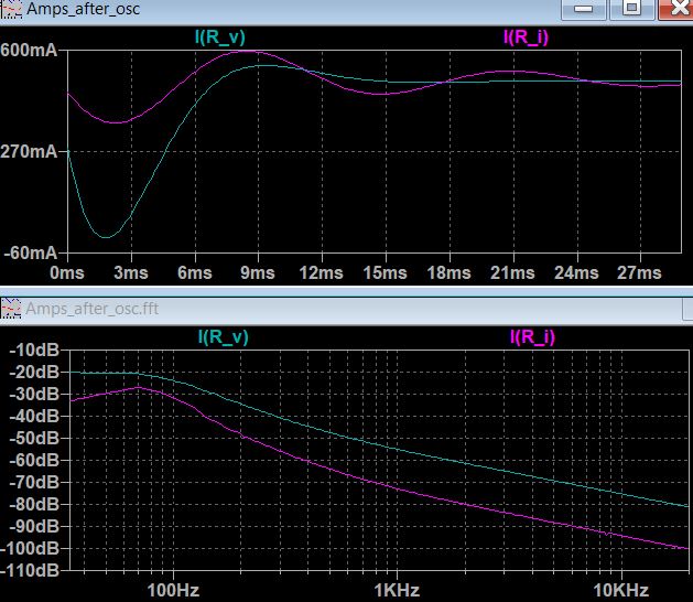

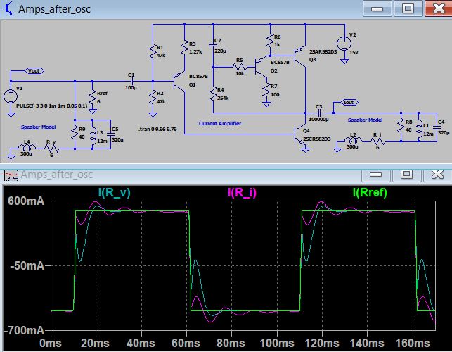

I suspect that you mean the effect of electromotive force (EMF). My simulation shows that the voltage amplifier can offer even worse results. I have actually already presented the following post-oscillations in comparison:If you apply Iwft at resonant frequency Fwft will result speed of the diaphragm.
The voltage amplifier delivers shorter oscillations, but with larger amplitude and distorted:

Current or voltage square wave response doesn't mean much with a complex, frequency dependent speaker impedance.
The voice coil is driven by (real) power.
Speaker SPL response essentially follows power input at each frequency.
So we would have to compare power square wave response.

The example above with the square wave signal shows the step response of the speaker model. FFT clearly shows that the voltage amplifier has more noise than the current amplifier. This just comes from driving the speaker unnaturally with the voltage.Current or voltage square wave response
Then you would have had the same effect on both curves. Actually, even without FFT, it's good to see that I(R_v) has a steep fall first and then a slow rise and an even slower afterswing. This is not a clean sine wave! A lot of distortion was mixed in. I(R_i) only sounds at the natural frequency of the loudspeaker, but again much quieter.Maybe read up on FFT and associated artefacts with a limited window.
How exactly do you want to calculate that? How much power is converted into sound? Simply sketched, without numbers.Anyway, only power square wave response matters.
It is kind of trivial that current drive gives a better current square wave response than voltage drive.
In fact a perfect current source must give a perfect current square wave, while a voltage source will give a perfect voltage square wave.
Question is how this translates to speaker SPL response.

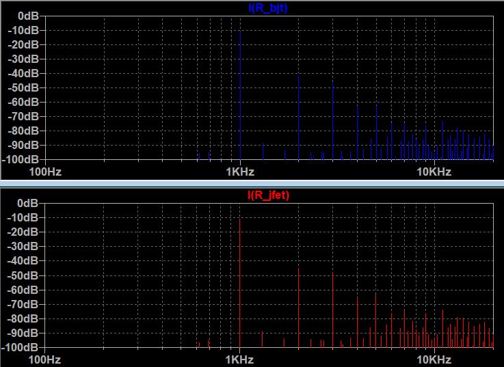

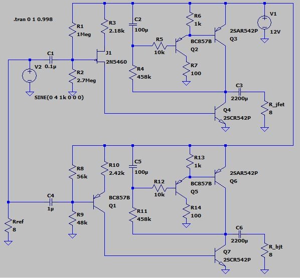

Or not. According to the simulation, I was probably wrong. I adjusted the amplifiers with JFET and BJT for the same quiescent current.
The output power of the amplifier with JFET is slightly smaller.
But the distortions are less.
- Sound of the bipolar transistors
