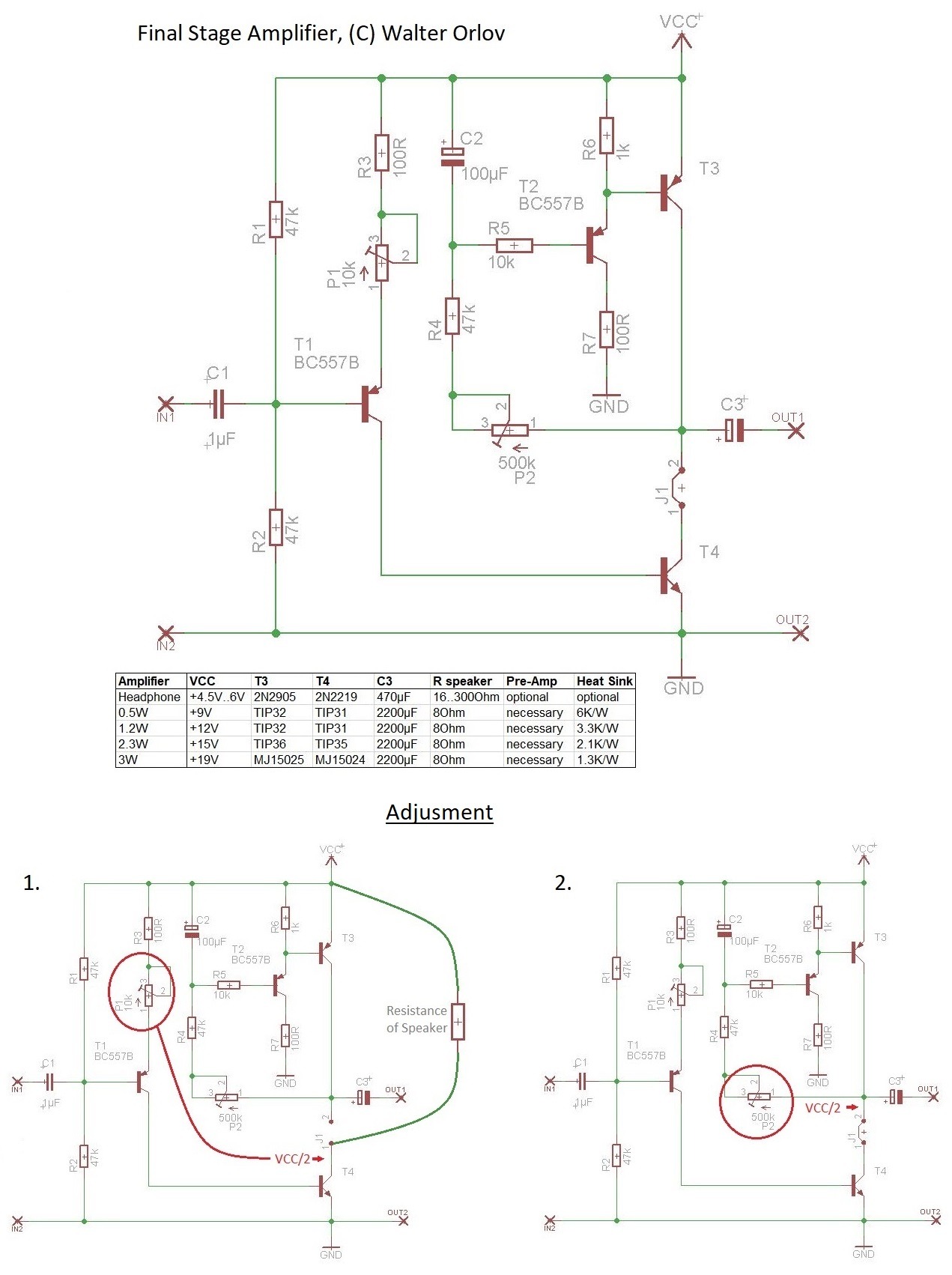

For me the FET transistors are not good enough, because their characteristics are non-linear. Definitely the tubes are much better. But the tubes are expensive, not mobile and require dangerously high operating voltages. In addition the output transformer ruins the sound.
I would like a robust amplifier with no tendency to oscillate. I often work in rooms that are heavily "contaminated" with electromagnetic fields. Therefore, the use of global negative feedback loop is out of the question.
After much deliberation I designed the following simple amplifier. And its sound surprised me...
But the reason therefore isn't the fact, that tubes are provide better audio than power BjT's and MOSFET's.
The reason therefore is the fact, that most tube power amplifier output stages runs in Class-A or nearly in Class-A and most transistor resp. solid state amps runs in Class-AB with 20-50mA idle current through the output in case of BjT's and 100-150mA in case of MOSFET's.
If solid state amps runs in class-A or nearly class-A (e. g. Pass "Aleph", "First Watt" or "XA" series so as Musical Fidelity "A1"), sound is very close to those of tube amps - independent, whether BjT's or MOSFET's are in use.
Maybe Rod Elliott's approach is, what you need:
https://sound-au.com/project70.htm
https://sound-au.com/project36.htm
or the wide range of Nelson Pass' class A projects - maybe even Andrea Ciuffoli's Power Follower projects - both single ended and push pull (Cool Follower).

Actually, I didn't want to imitate the tube sound. This happened by itself. I wanted a robust amplifier and I managed to achieve this with two tricks: 1. class A and 2. no global negative feedback loop.If solid state amps runs in class-A or nearly class-A (e. g. Pass "Aleph", "First Watt" or "XA" series so as Musical Fidelity "A1"), sound is very close to those of tube amps - independent, whether BjT's or MOSFET's are in use.

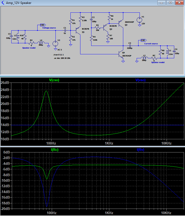

That is largely incorrect, even if GNF may play a significant role. Common collector has a relatively low output impedance without any GNF loop.Transistor amplifiers, on the other hand, have a very small output impedance due to the global negative feedback loop,
On the other hand, common base and emitter have comparatively high output impedances,
It's the other way round: Lower source impedance increases the damping.I think that would even be done on purpose. The output impedance of the tube amp was about the same as the speaker impedance and could even be greater. That dampened the resonance and what was left, as you say, was the bass boost.
The electrical equivalent to the speaker resonance is a parallel resonant circuit, where damping increases with lower parallel resistance.
An amp having a large output impedance acts a a current source.And now: My amplifier theoretically has an infinite output impedance (current source). Practically it is 100..300 ohms. The resonance is almost unsupported. This doesn't result in any additional bass boost, but the speaker gets just as loud at the resonant frequency as it does at 1kHz ("clean bass"). This means there is no lowering of the volume in the bass range as with standard solid-state amplifiers (voltage source).
With a current source the output voltage is proportional to the load impedance.
At the bass resonance the speaker impedance (often strongly) increases and so does the output voltage of a high impedance source (amp).
Consequently the power delivered to the speaker increases at the resonant frequency resulting in a bass boost.
I recommend to actually measure the amp's frequency response with a speaker load.
It will no longer be flat as with a constant impedance.
To my knowledge published frequency response of speakers or headphones is always measured on a low impedance amp.
Exactly!I recommend to actually measure the amp's frequency response with a speaker load.
The “bass boost“ is just a higher small signal GAIN at low frequency, as gm times the parallel combinion of the reflected speaker impedance and the anode resistance is higher in that narrow band. It does run out of voltage sooner, so the boost doesn’t happen at full power/volume. But at normal listening levels it is there.
Most SS amps would have an output impedance lower than any tube amp (triode, pentode, with or without feedback) even with with low or no global feedback. It’s not universal, though, because not all SS amps have common collector output stages, and they vary in how much current gain those output stages have. Ones that have a lot of current gain tend to retain their high damping factors when clipping. When you are clipping, there is no feedback and the output impedance is what intrinsically is. For hi-if use where clipping is avoided at all costs it’s debatable whether there is any value in keeping Zout low in clipping. But for DJ, concert, and rave use it is the single most important characteristic, aside from reliability. If you can drive an amp 6-10dB into clip and it still sounds clean it is a major advantage.
Tube amplifiers don‘t have have sky high damping factors to begin with, so when you clip there isn’t as much an abrupt change in characteristic so it tends to be less objectionable than a cheap SS amp running out of steam.
And that means artificially increased SPL at the resonance and high frequencies.
