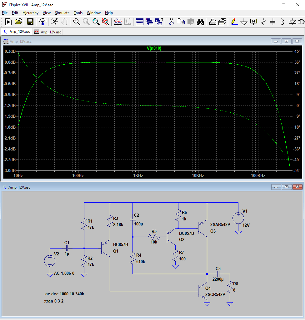

And can you still measure the frequency response with your program?
I tried this myself with LTSpice. The cut-off frequency is 1.3MHz!

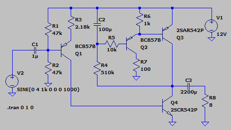

The circuit of the 12V amplifier:

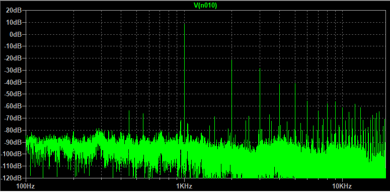

The following FFT graph results for 1W:

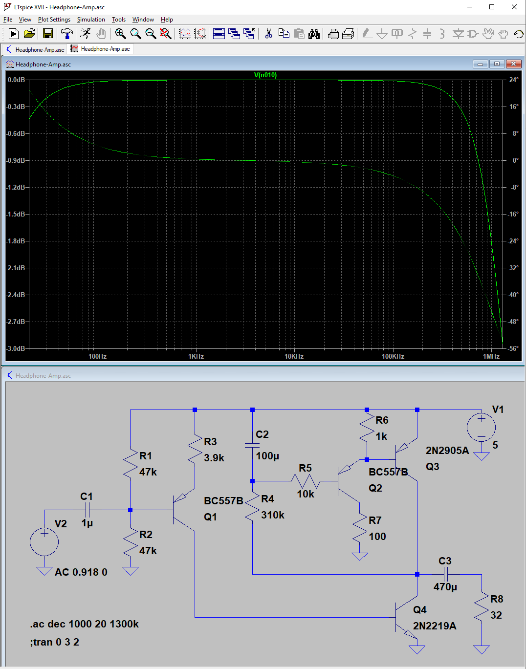

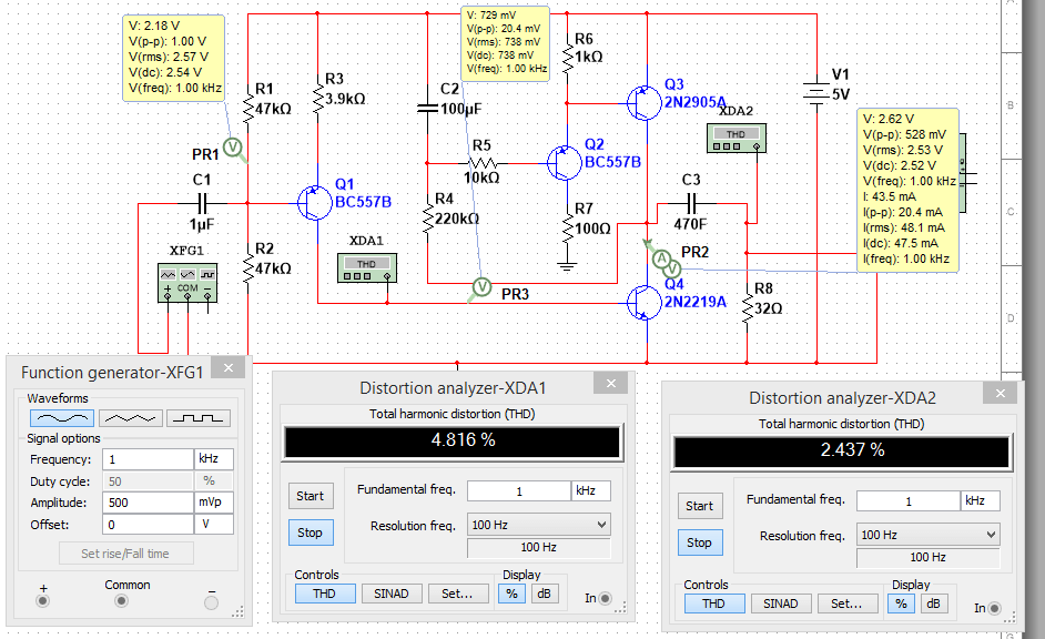

Because it barely has any voltage gain with a 32 ohms load. (Changing the load to 1k more than tripled Vpp) Here are some stats. (I changed R4 to 220k to get slightly better numbers, plus the collectors to be at roughly 1/2 Vcc. This is one of the weirdest power amp schematics I've seen in a long time.

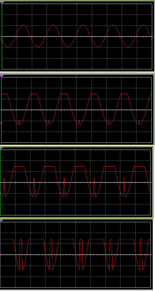

clipping reversal, very ugly😱I looked at how the distortion changes with signal level. It's definitely one of the more unusual ones with those reflections at negative peaks.
Might make an interesting guitar amplifier for a new (?!) distortion effect. Alas, I do not have an electric guitar, so I can't try that myself. However, now that I've seen the waveform I plan to breadboard it. May not have anything better than BD139/140 for the time being, but they should still be enough to drive a speaker with a 28V, 2-3 A supply.
And as said, most of the distortion comes from the input transistor T1 because it is driven with the voltage.Here are some stats
Possibly the different simulation programs use slightly different models for the transistors.I changed R4 to 220k to get slightly better numbers, plus the collectors to be at roughly 1/2 Vcc.
Thanks 🙂This is one of the weirdest power amp schematics I've seen in a long time.
If the preamplifier is supplied with the same operating voltage as this amplifier, this effect will not occur at all.I looked at how the distortion changes with signal level. It's definitely one of the more unusual ones with those reflections at negative peaks.
It won't be easy. You then need a preamplifier with an output signal of around 40Vpp. But in linear power range you can try this amp with guitar speakers quite well. For BD139/140 I would recommend a maximum of 12V. Around 1.5W through the guitar speaker it gets pretty loud.May not have anything better than BD139/140 for the time being, but they should still be enough to drive a speaker with a 28V, 2-3 A supply.
