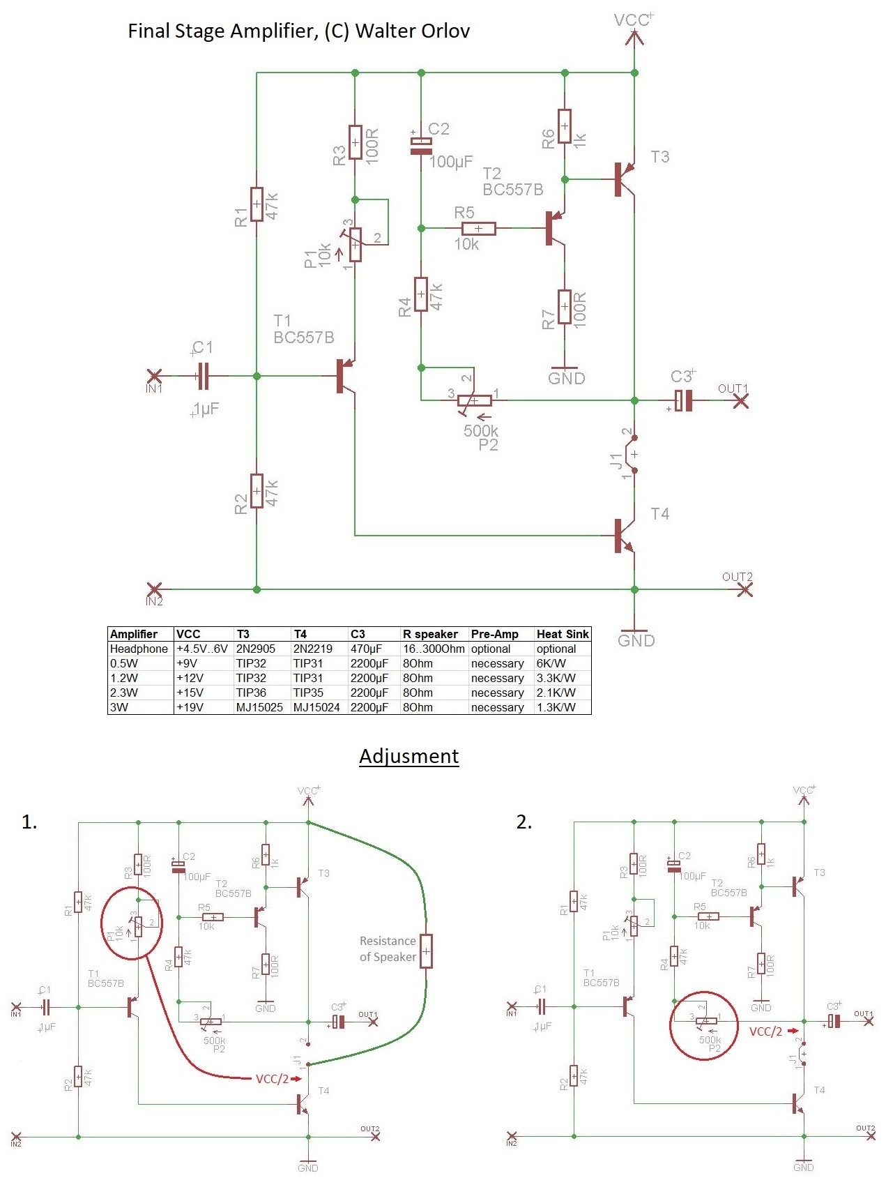

Hello!
For me the FET transistors are not good enough, because their characteristics are non-linear. Definitely the tubes are much better. But the tubes are expensive, not mobile and require dangerously high operating voltages. In addition the output transformer ruins the sound.
I would like a robust amplifier with no tendency to oscillate. I often work in rooms that are heavily "contaminated" with electromagnetic fields. Therefore, the use of global negative feedback loop is out of the question.
After much deliberation I designed the following simple amplifier. And its sound surprised me...

As there is no global feedback, you can count on there is lots of THD distortion.
This is not so bad, because the sound can still be good.

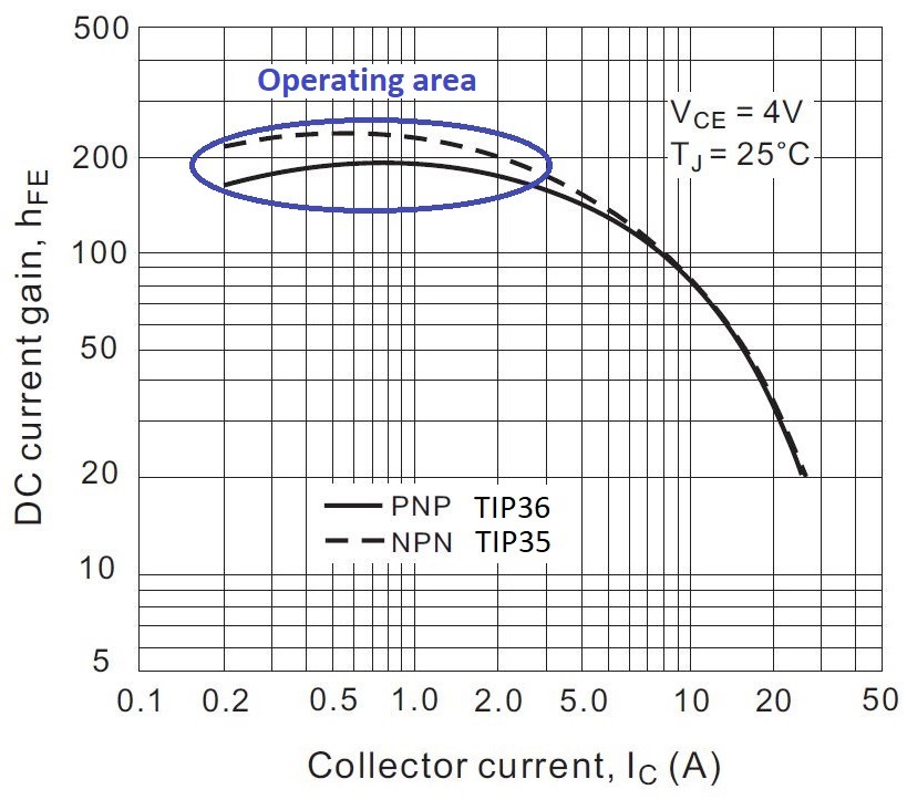

I have already done this work. My recommendation: version with TIP35 and TIP36.You have no choice but to buy 50 different ones and listen. Of the 50, as always, 5 will remain that are suitable for audio...
Yes, they are good, but TO-220 is difficult to cool. So I suggest MJ15024 and MJ15025 in TO-3 for 19V.TIP31/32 sound well.

Exactly!T1\T4 converter Voltage\current.
T2\T3 current source (load for T4).
SE amplifier.
I intentionally don't overload the power transistors. They operate in the relatively linear area. THD is just a few %. Above all, it is about 2nd harmonics. The rest only appears when the overdrive occurs.As there is no global feedback, you can count on there is lots of THD distortion.

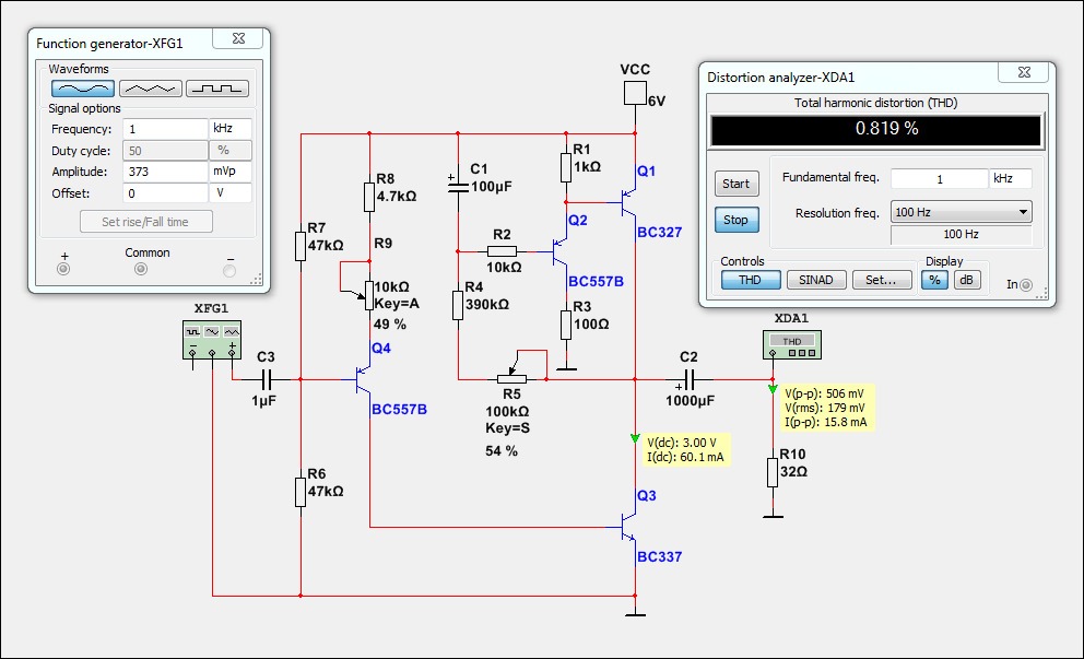

I set up as a headphone amp at 6V with bias 60mA.
The THD is 0.82% at 1mW into 32 Ohm headphone.
It is on the high, but I have no doubt the listening should be pleasant.
I have little experience with the simulations. For a real circuit with 2N2219, 2N2905, operating voltage +5V, I measured with the oscilloscope 5% THD at an output voltage of 1V RMS.
I simulated with 0.179Vrms into 32 Ohm load.
This is the 1mW into 32 ohm.
As I said this give 0.82% THD. Most 2nd and a bit 3rd harmonics.
BJTs are much much less linear than anything else, they have an exponential characteristic!! However they have supremely high transconductance which can be traded for linearity with local feedback effectively.Hello!

EMI is nothing to do with loop-stability. To address EMI you need to screen and filter out the interference, put everything in a Faraday cage and think about feedthrough capacitors and ferrite toroids. GNFB is not ruled out in the slightest.I would like a robust amplifier with no tendency to oscillate. I often work in rooms that are heavily "contaminated" with electromagnetic fields. Therefore, the use of global negative feedback loop is out of the question.
BTW FETs are much better at evading EMI than bipolar transistors and sound like they might the correct choice for this environment.
How do you keep the transistors at a constant temperature (so that you don't need to keep re-adjusting P1 and P2 as they warm up)?
Only if voltage driven. But BJT can be quite linear if current driven like in this amp.BJTs are much much less linear than anything else, they have an exponential characteristic!! However they have supremely high transconductance which can be traded for linearity with local feedback effectively.
Surprisinly wooly bass from nonexistant damping?After much deliberation I designed the following simple amplifier. And its sound surprised me...
With idle/quiescent temperature, power FET's actually have a 'negative temperature coefficient' regardingHow do you keep the transistors at a constant temperature (so that you don't need to keep re-adjusting P1 and P2 as they warm up)?
bias current > thereby being effectively self regulating without the need for 'thermal sensing feedback'.
Also, if you compare the distortion characteristics of BIPOLAR vs FET amplifiers driven into overload-clipping,
the Bipolar = predominant odd-order harmonics (not musical), and the FET = predominant even-order harmonics
which are 'musical'.
