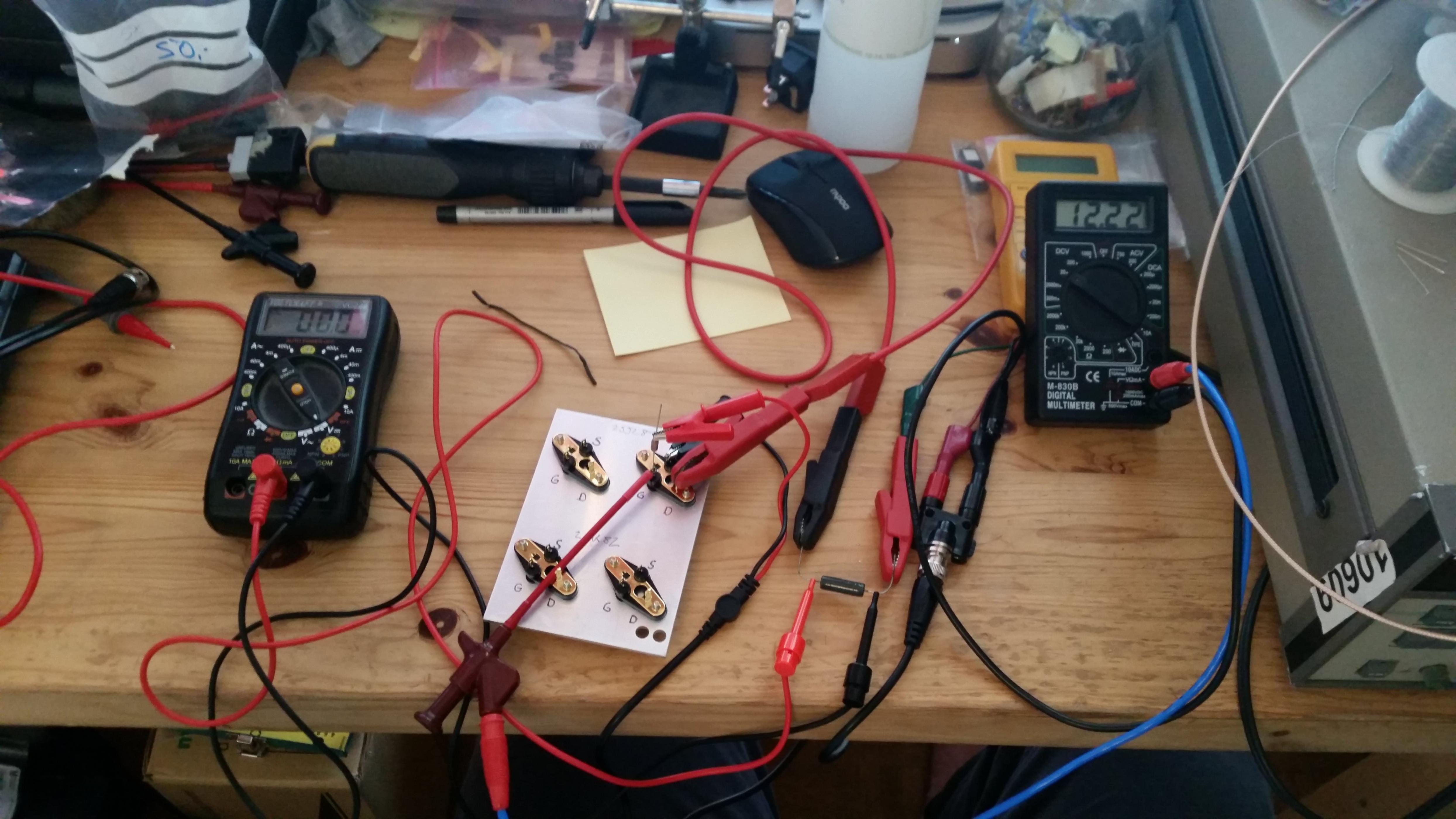

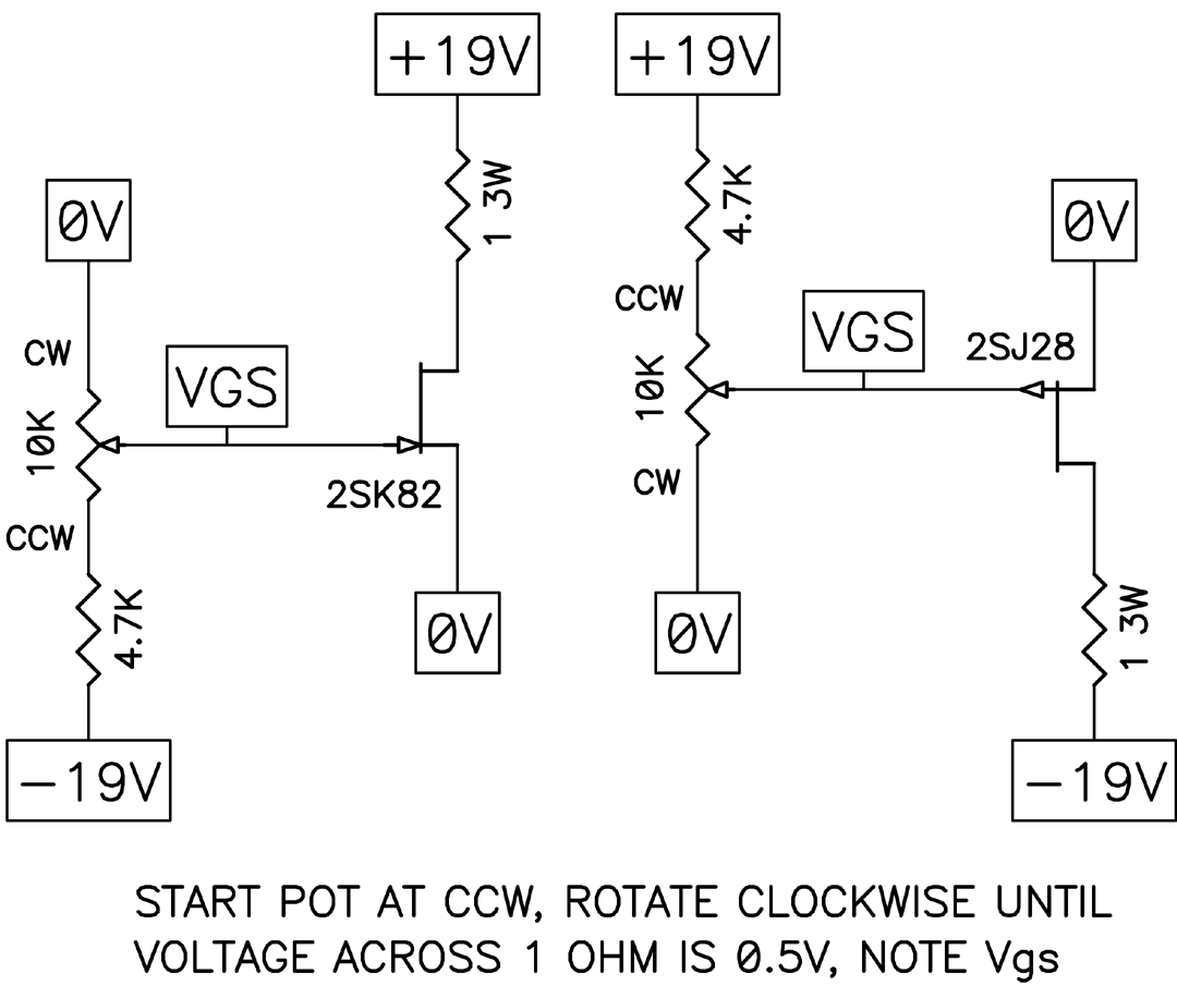

Yes and it's not hard. Use the schematics as posted by Rodeodave above.
You can replace the voltage sent to the gate using a couple of 9V batteries in series
if you don't have an +/-19 V bipolar supply handy. (Also the voltage need not be
exact. Just in the neighbourhood will do.)
The main thing to remember is that you want to set the pot so the gate voltage
is at max magnitude. So for the 2sk82 you want the gate voltage to start at -19V
and then gradually adjust the pot to move the gate voltage towards the direction
of zero, while monitoring the voltage across the 1 ohm resistor (for current).
Stop when you have 0.5V across the 1 ohm resistor. The corresponding gate voltage
is the 'missing number' you want for that part.
Similar thing for the 2sj28, but with the initial gate voltage at 19V and slowly
decrease it towards zero until you get 0.5V across the 1 ohm resistor.
Hope this helps.
Dennis
There's really not much to it. Watch the polarities, make sure the gate bias is there before the main supply voltage, and use light heatsinking.
