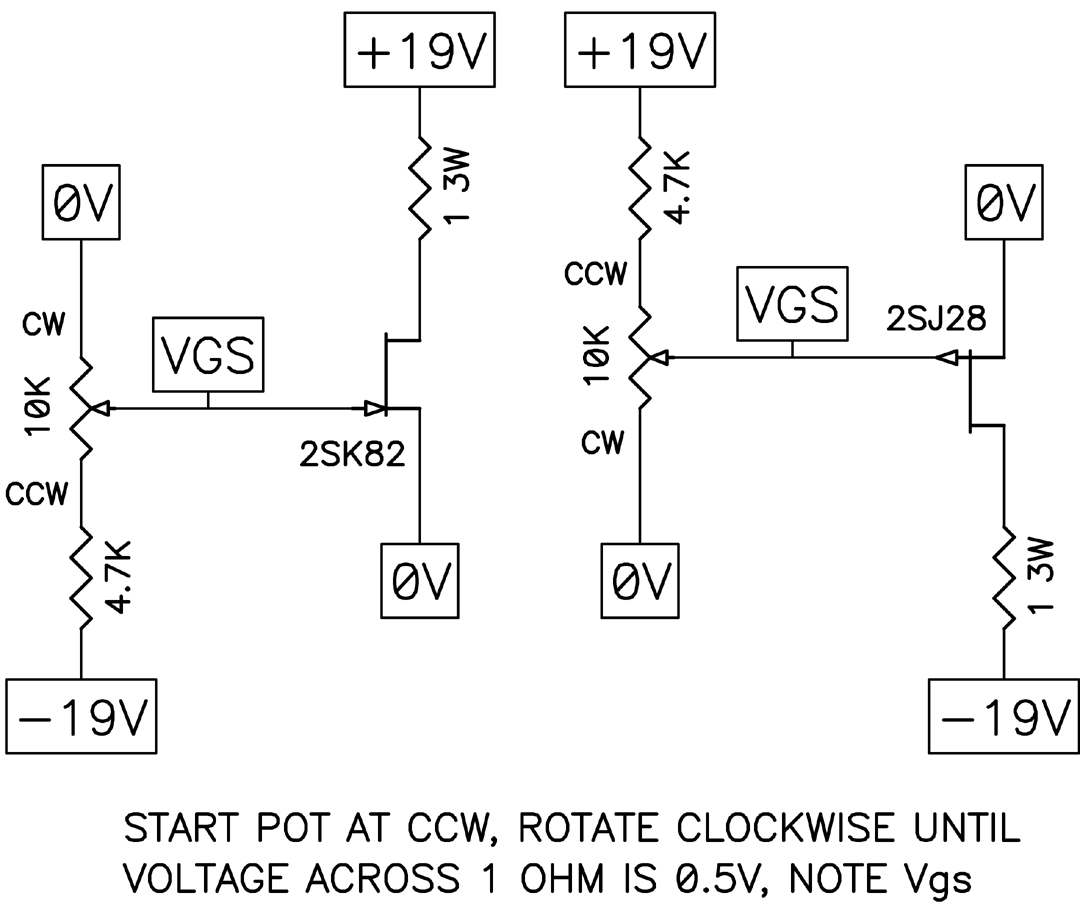

Hi Andrew,
You mentioned that when you tried measuring the vfets, they got really hot.
Do you recall it that was with the ones that had the numerical markings on them?
If those 14.x markings are Vgs values at some non-zero current, it's possible
that this circuit does not give high enough Vgs to keep the current low.
Dennis
Dennis
The Vgs measuring circuit calls for 0.5A so there will be heat. Heat sinking is probably best if power is applied for any length of time. The 14.xx markings are probably Vgs values for 0.5A at 19V or 20V. Nelson's test criteria was 0.5A at 20V Sony Vfet Illustrated build guide .
To make sure that you don't run out of voltage for Vgs, reverse the positions of the 10K pot and 4.7K resistor so that the full 19V is available.
Ben is right on as usual.
In fact, I would argue the that the switched order is superior since it keeps
the Vgs well away from zero and minimizes the chance of high current.
Andrew, in light of Ben's comment, do you want to try measuring your parts
again (assuming you haven't sent them off to be tested). (Start at 19V at Vgs
and slowly decrease it while monitoring the current (across the 1ohm resistor)
Dennis
Dennis
I've been wrong! 😱
Make sure power to the gate is up, measure to make sure, before powering up Vds.

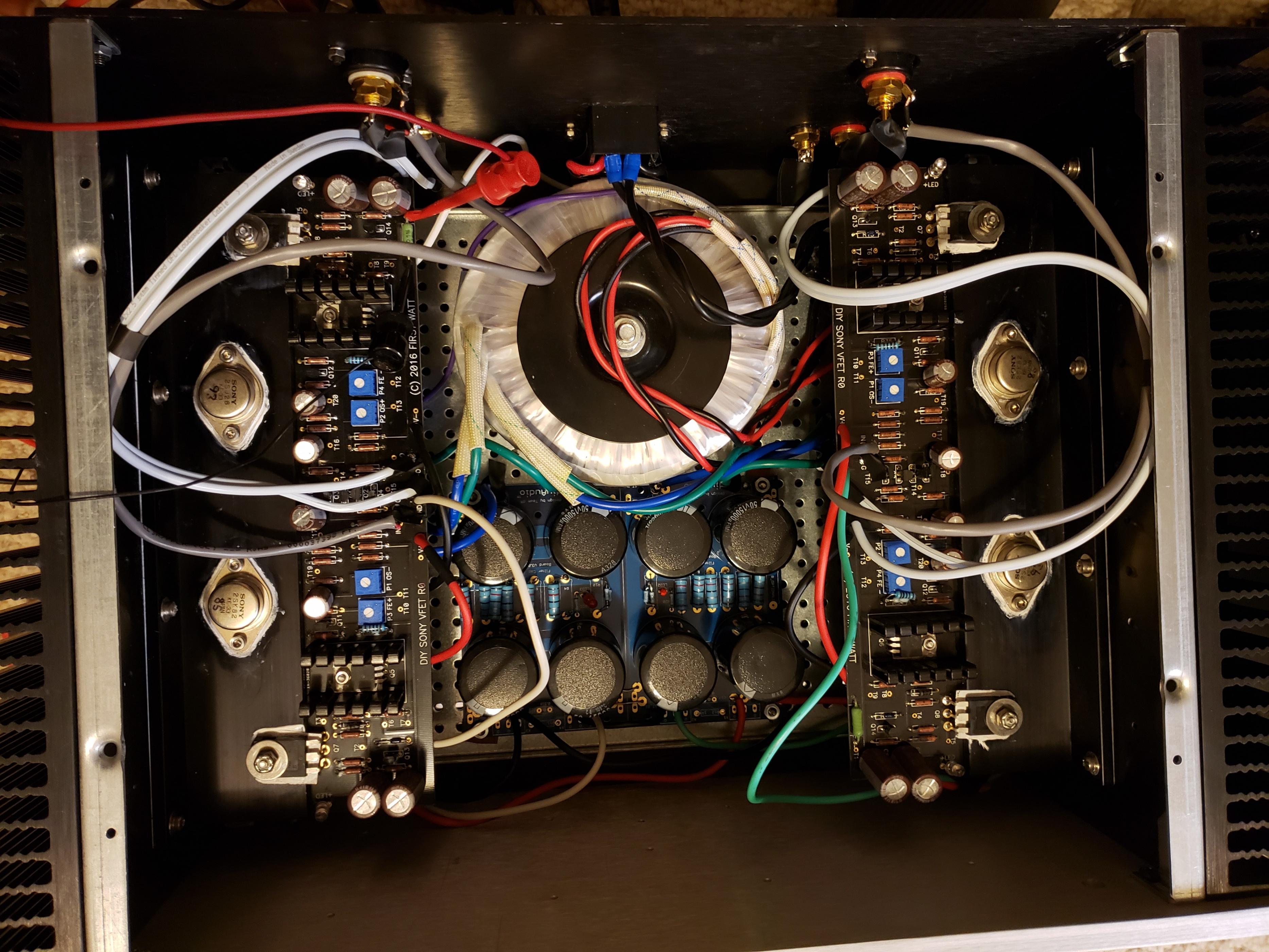

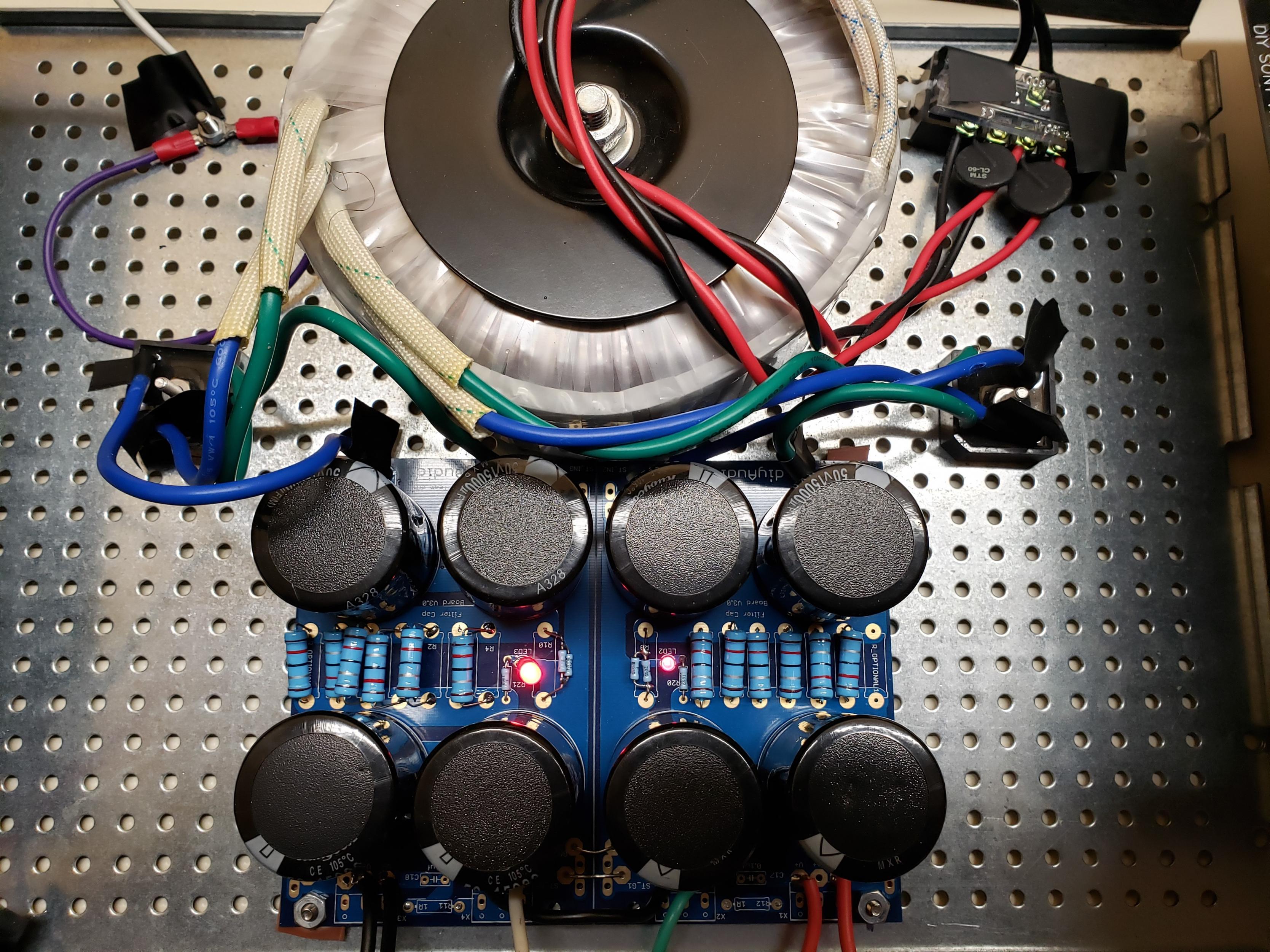

To continue from earlier, I lost V- .
I took out the VFETs. Examined the power supply. There was one place where one of the output wires from a diode bridge was loose. I fixed this. Replaced resistors that blew. And ran both polarities for a few hours with an incandescent bulb. This went ok.
I rebiased the front end. One channel at a time. This seemed to go ok.
I installed the VFETs for one channel and initial setup went ok - ran for about half an hour. output DC offset < 40 mV. Voltage at R32 about 90 mv . I had not closed the box yet.
I turned off the amp and within a minute, turned it back on. One of two fuses in the AC input blew. Thinking, this may have been the case in the initial problem that resulted in no V- either : Turn on without a long time off, to cool off. Is there any problem that this points to?
I let the amp cool for ~ 10 minutes and then replaced the fuse and turned it on. It seems to run ok. Voltages at R32 and the output DC offset for the channel with VFETs seem as before.
Please let me know if you see anything amiss in the picture and as always, thanks for the help.

I couldn't tell see much in the picture. A wider angle shot showing wiring to the boards would give more information. You also have tape in many spots obscuring the wiring.
What size fuse are you using? If the fuse is a bit low, rapid off and on may blow the fuse because the CL60 thermistors are still hot and therefore have low resistance, allowing high current flow. The CL60 when cold has high resistance (about 10 ohms if I remember correctly) and that slows the current surge as the capacitors initially charge.
If you are now getting low offset and reasonably correct current through the circuit and voltages are correct, then it is working properly, and it is time to try your other channel.
For proper final setup you will need to put the cover on in between adjustments. With the cover on, the operating temperature will increase and the offset and current will change. So it is best to adjust, put the cover on and run it for some time, and then quicky adjust and put the cover back on. To do this efficiently it is best to have three meters and also clip leads so that you can keep the meters connected while the cover is in place and the amp is heating up. With the meters hooked up you can monitor the readings and decide whether you need to increase or decrease the pots before taking the cover off. It is probably best to do one channel at a time.
When making adjustments, it is best to go half way and then let the amp stabilize, and then make further adjustments, until you slowly reach a point where it is close enough.

As Ben says, the thermistors when hot have a very low resistance and it's not uncommon for the fuses to blow when a short power-off/power-on cycle occurs.

Thanks Ben. Here is another picture. I suppose I went overboard on black tape.

Fuse is 3A fast blow. That is what I got locally. Good point about the CL 60 thermistors. I'll order slow blow ones. Do you think I should step up to 4A or 5A or stay at 3A? The transformer is 400VA.
Yes, I put the whole box together to let it warm up. One channel seems reasonable so far. Working on the second channel now.
