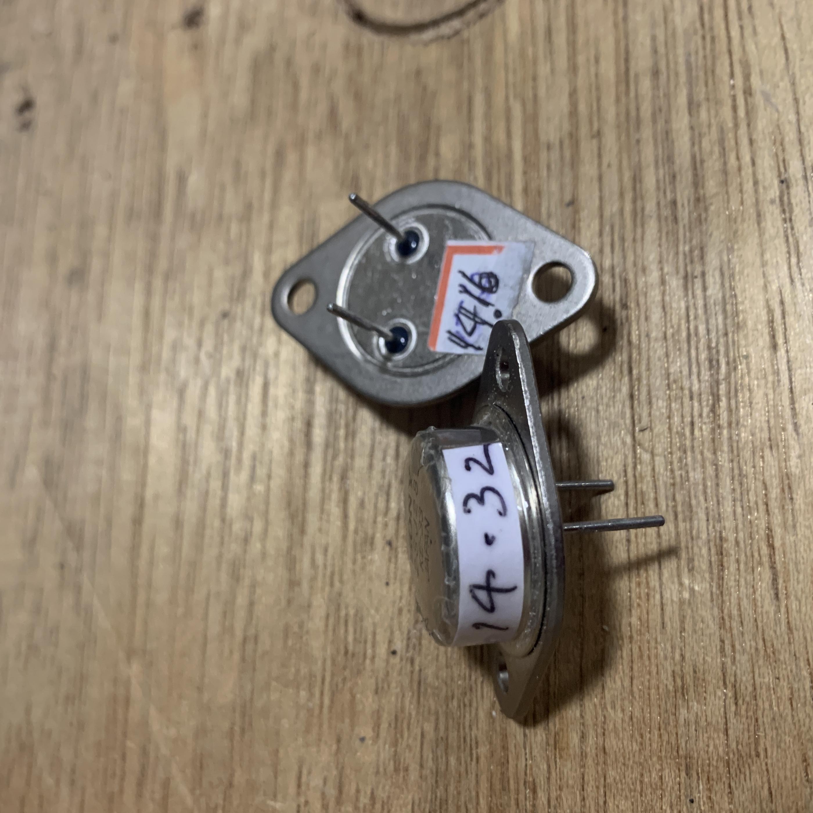

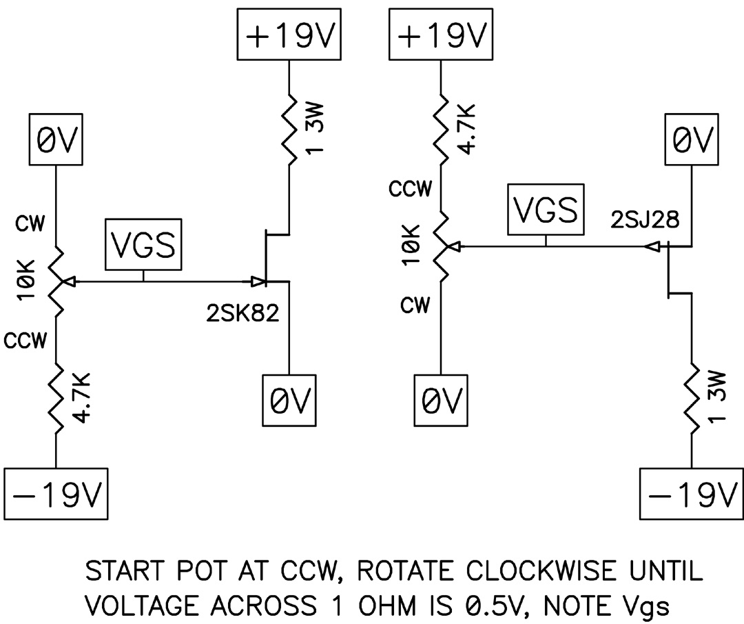

I’m about to install my VFETs. I acquired them from acronman.
The marking on the 2sk82 and 2sj28 are 15.32 and 14.32 respectively.
Is this Vds or VGs.

Hi Stanney,
The vfets I bought from acroman did not contain such markings.
It's possible they represent Vgs values, but at what current?
I guess you're trying to figure out where to get the initial Vgs voltage
for the vfets? The exact value is not important, only that it is high enough
so the vfets conduct minimal current.
Are you able to do some measurements on your vfets?
Hello Dennis,
Thanks for getting back.
I bought them from two sources. Acroman and through the DIYAUDIO swap meet.
Hasnt helped moving house twice so they are a little mixed up.
I am trying to set the initial voltage. I guess I could set at 10v if it’s not important.
I did try with the method described in the forums. They generated so much heat I backed off. Was hoping I might find someone experienced with a curve tracer.

Sorry I wasn't being clear. The exact initial value is not important as long as it is high enough to make sure the vfets are not passing much current.
In your case, someone might have done some measurements. If they represent
Vgs for something like 0.5A or 1.0A then setting the initial voltage at 10V will give
way too high a current. So please don't do that until we get some more information.
Do you have the link to the setup you used when you tried measuring?
