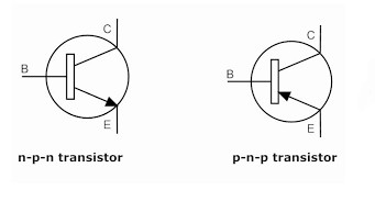

Hi Dennis,
For my own education how can you tell from the schematic that Q3 is a NPN. I am not formally trained on how to read electrical schematics so I'm not familiar with all of the nomenclature. I am analogous to a layman trying to read a piping and instrument drawing for a chemical plant, might get some of it, but a lot of important stuff is missed. The schematic only shows Q3 as the designation, for Q5 is does show a part designation which I can look up to learn is a PNP. If the arrow leaves the symbol does that mean it is a NPN and if it enters the symbol it is a PNP ?

You are correct, Paul. See the direction of the arrow at the emitter. This caused trouble for me with my first amp, Nelson's a40. I mixed up the output transistors on one channel and needed to replace about 5 components on the board afterward.
When in doubt google is everyone's friend. Google bjt symbols, or mosfet symbols, etc. There are a number of different mosfet symbols and I use google or wikipedia when in doubt. Always trust NP schematic when building and only stray when experienced.
