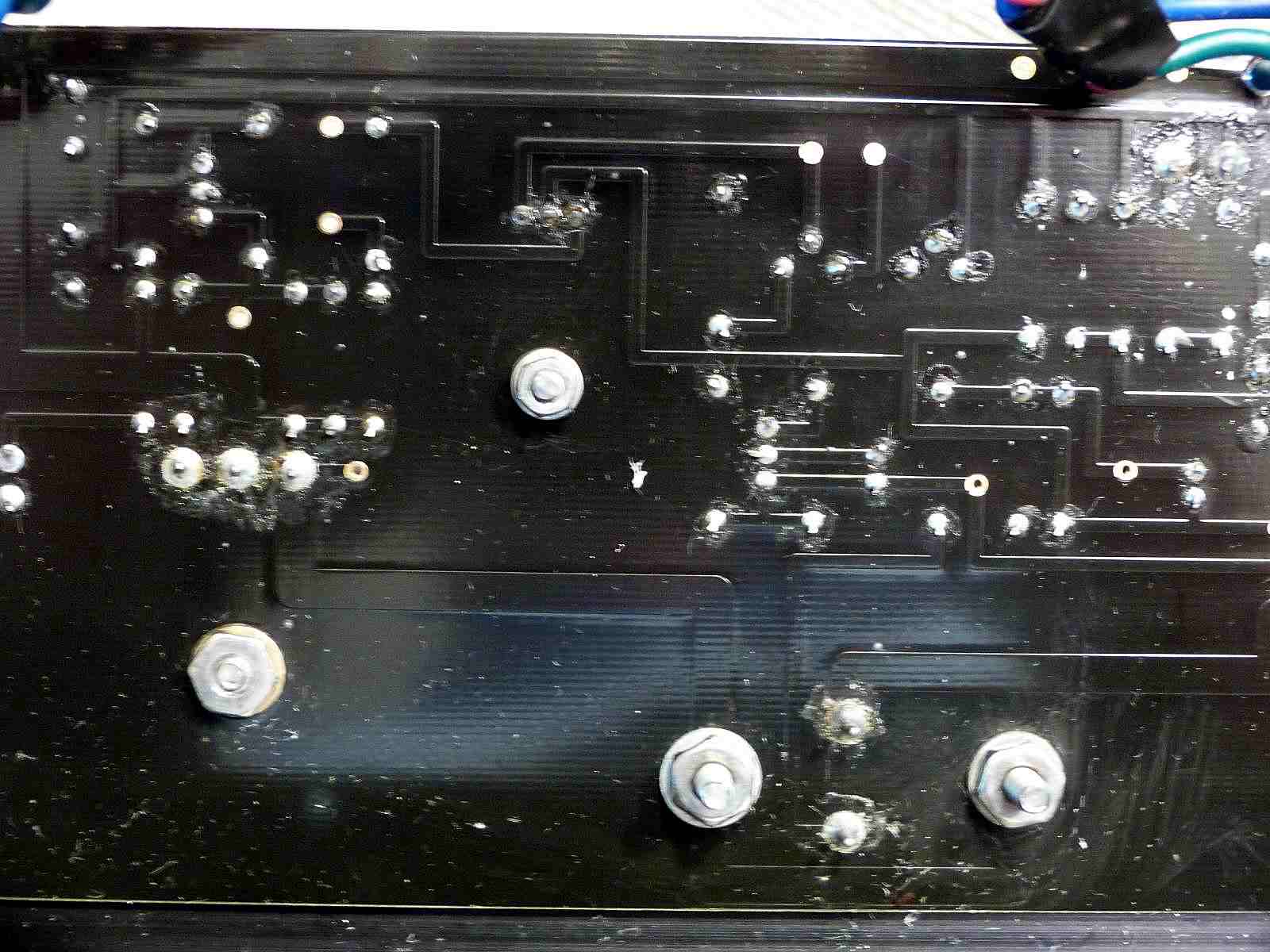

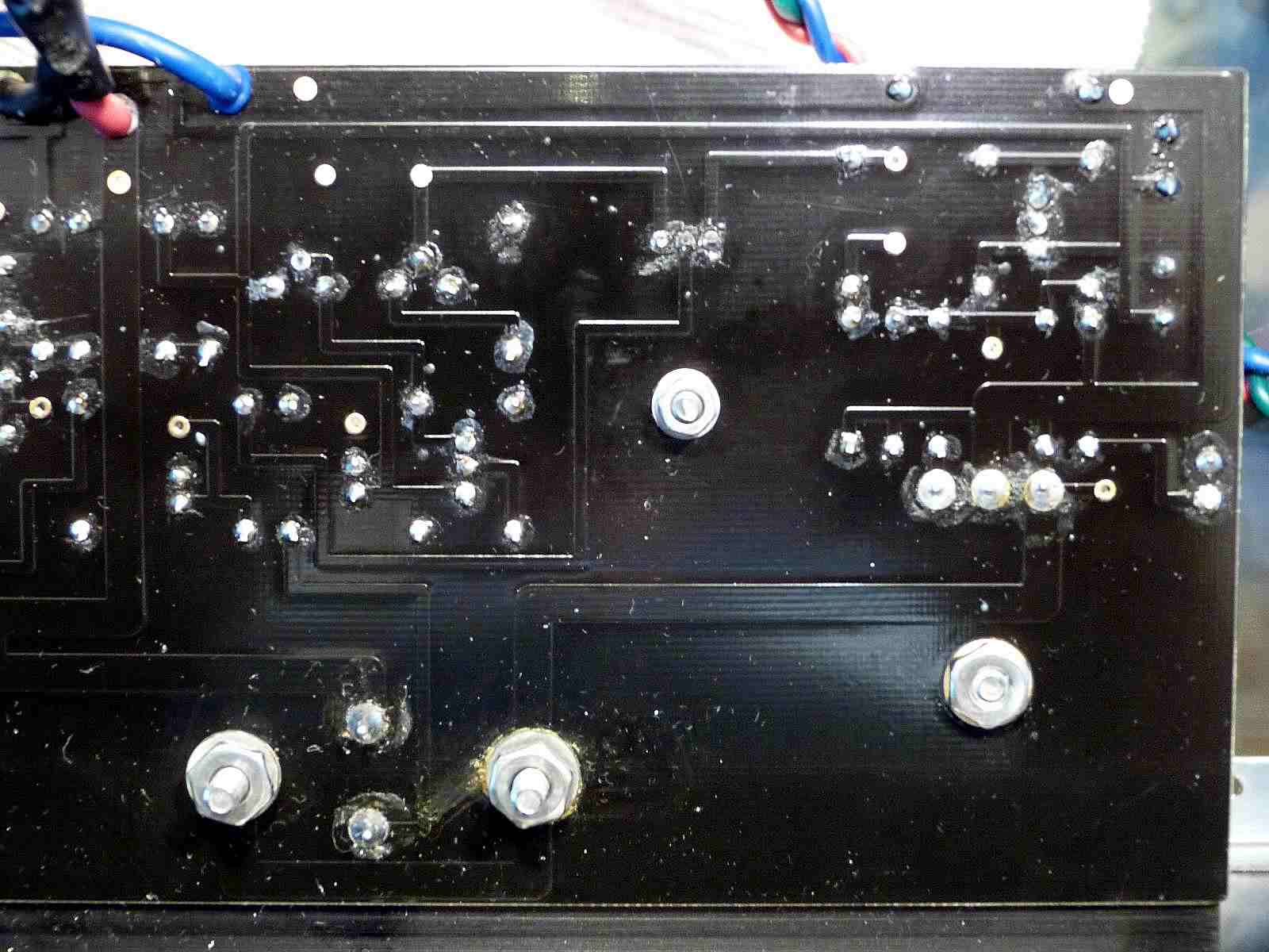

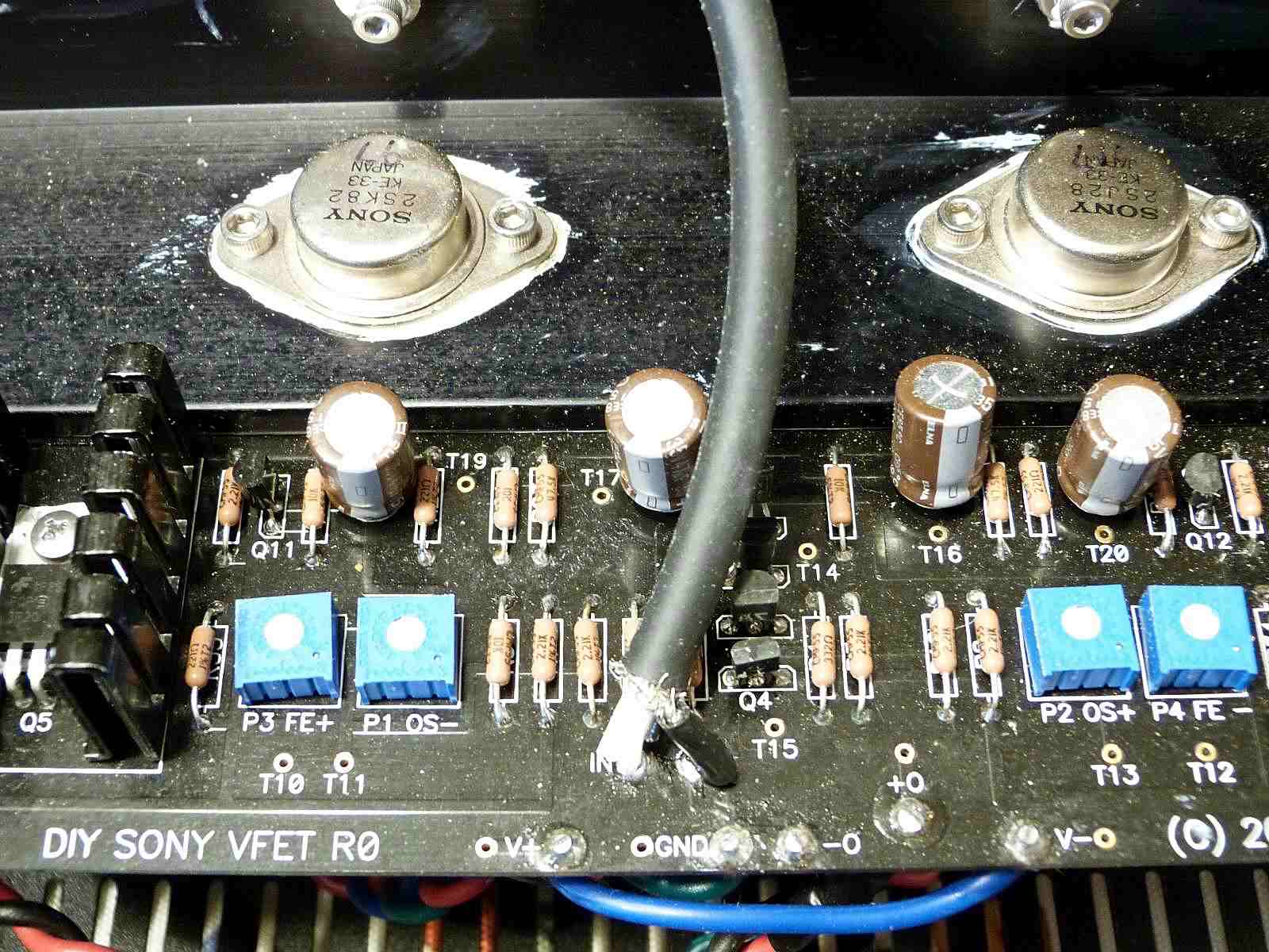

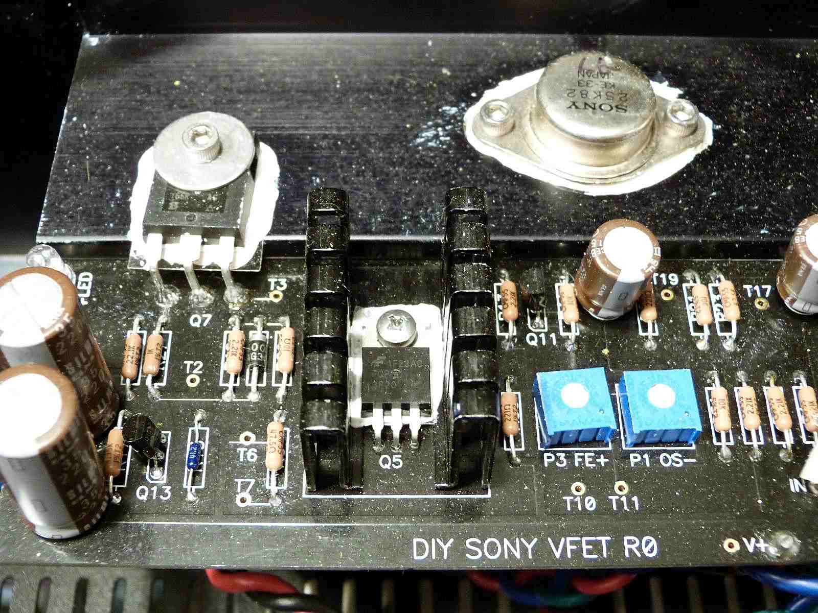

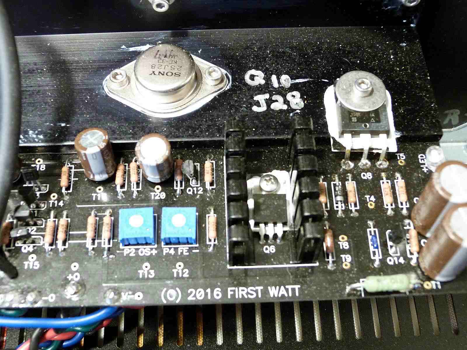

I finally got around to taking some more pics and measuring the TL431's ref legs to gnd.
bad channel Q11 = 2.48 v, good channel Q11 = 2.48 v
bad channel Q12 = -10.32 v, good channel Q12 = -8.40 v
bad channel Q13 = 2.47 v, good channel Q13 = 2.48 v
bad channel Q14 = -21.32 v, good channel Q14 = -21.22 v
I took these measurements after I had biased up the front end, it seemed to bias up more easily and stably this time after reflowing, but that might be because I have done it several time now. The readings between the two boards are pretty close with the exception of Q12, and I'm not sure if it is significant.
the pictures were the best that I could do with the camera that I have the specks that look like dust are artifacts of poor lighting and high compression. I looked carefully with a magnifying glass and went between all close legs with a fine blade and didn't find any bridges. I'll wait until I hear back on the opinion of the experts here about Q12, before I attempt to bias up the back end and give it a listen.
I appreciate all your help, thanks,
Paul

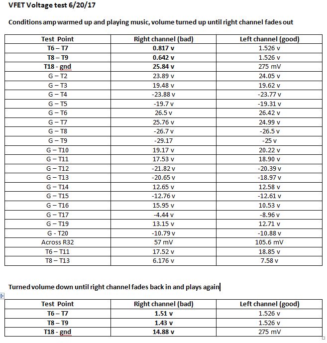

Hi Guys,
I took some voltages on both boards while the amp was on and playing music, I turned up the volume just until the right channel faded out to take the readings. I got interesting results that seem to point to a problem in the front end. I've attached a table with all of the readings. When I turned the volume up until the right channel faded out the readings across R5, R6, T16 - gnd, and R32 ( 0.814 v, 0.642 v, 25.6 v, 57 mV)went wonky.
So then I decreased the volume until the right channel began to play and the readings all started to come back into line (1.51 v across R5, 1.427 across R6, 14.88 v T16 - gnd).
So I'm guessing that Q5/Q6 might be the problem. So I'm going to order new Q3,4,5,6, and replace them and see what happens. If there are any other components that I should replace please let me know.
Paul

Check those resistors around those transistors especially R5 and R6 and be sure they are 47.5 and not 47.5K, common mistake I am guilty of making in a number of builds when you have resistors like those. I would also check R7 R8 R9 and R10 as well for correct value as well as R34 and R35. Just pull one lead and check ohms. Doubtful a transistor is bad but can and does happen. Bjt's are cheap and I am going to assume you used FQP for Q5 and Q6 and they also are cheap. Other resistors in this circuit one has to be careful about are the 2.21K and 221 ohm ones. Easy to install wrong values in wrong hole. Pull one lead and check ohms.
You still need to adjust the right channel front end. T18 to ground should be less than 300mv warmed up. Keeping the output D.C. to less than 20mv on the speaker.
I don't get to concerned with measuring t8-t9. Put a meter on t18 to Ground and another on t6-t7. If you get this correct then t8-t9 will be correct by default.
Remember small changes make a big difference.
Keep at it, you will get there.
