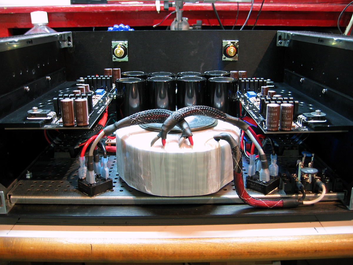

I'm using the De Luxe enclosure. In addition to the holes for the T brackets, the heatsinks have lots of other pre drilled holes. The pattern of those holes is not symmetrical above and below the T brackets. However, as far as I can see, I'm not going to be using any of the holes (apart from the ones that are used to screw the chassis together) and so it's doesn't matter which way up the heatsinks are mounted.
Or am I missing something?
IMHO, only really matters for clearance to parts below, like PS caps, etc., if that applies to your situation. All things equal might be slightly better to orient the heatsink so the T bracket is mounted lower for slightly better dissipation. I think we're talking 5mm or so here. Below you can see the comparison R/L.
