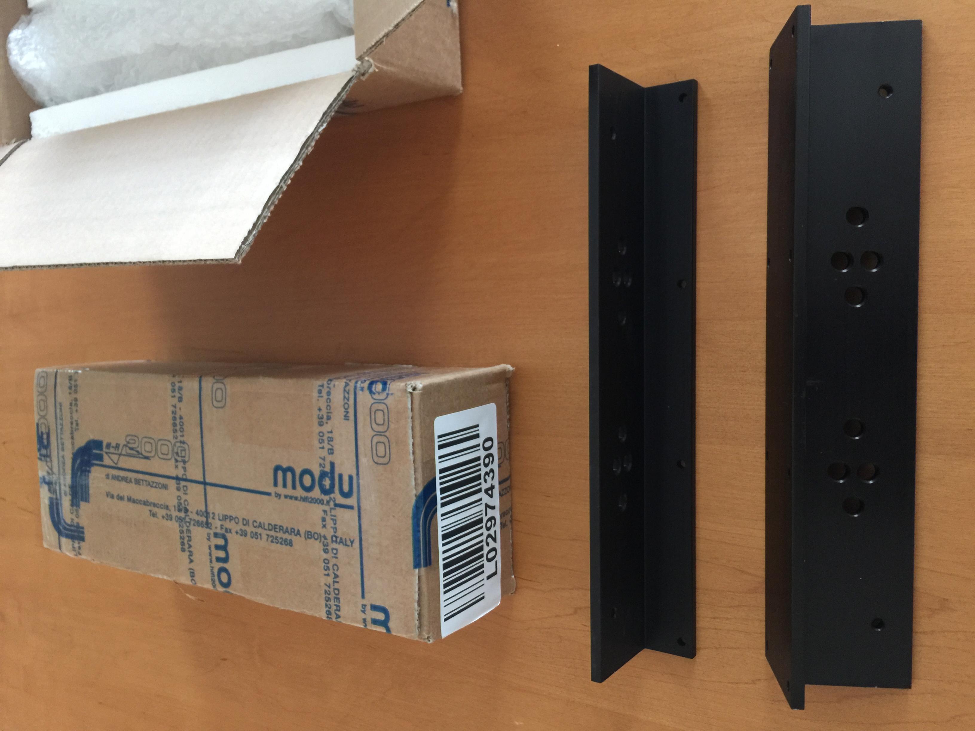

Got my package three days ago. Kit looks fantastic. Thank you Mr. Pass for the monumental effort.
Happy building!

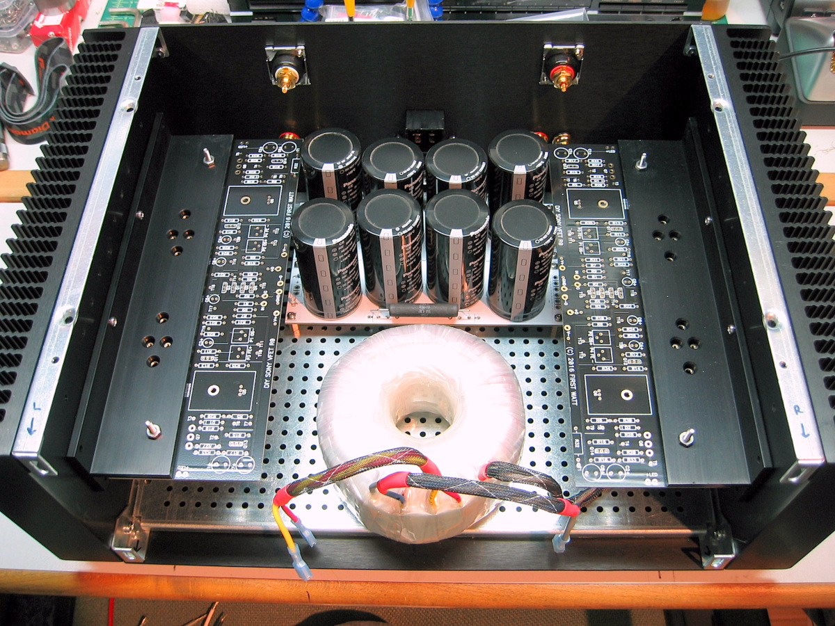

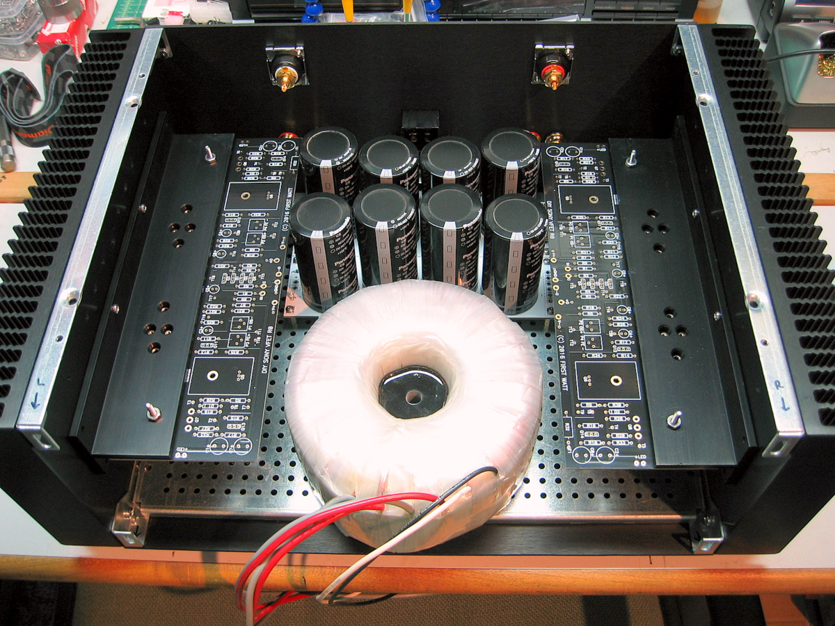

Here's the amp in the Store deluxe 4U chassis.
PS is Tea's super-size version with Panasonic 105C THA 39,000uF caps.
One image is with a 400VA transformer.
Other image is with a tasty 800VA 24V transformer. It's on the big size, but tempting because it's on hand already.
BK

I say go with the 400VA if it is 22V. With a load my voltage is 29V using a 22V 300VA Antek transformer. With a smaller transformer you will have less chance of hum problems. In my opinion 800VA is serious overkill. Like a new corvette for the little old lady who drives 50 mph on the interstate.
Agreed - only presenting for size comparison since I've yet to see the boards setup in the store 4U. The 800VA has the right secondaries and is only collecting dust, but alas it is simply too monstrous for this particular application!
BK
