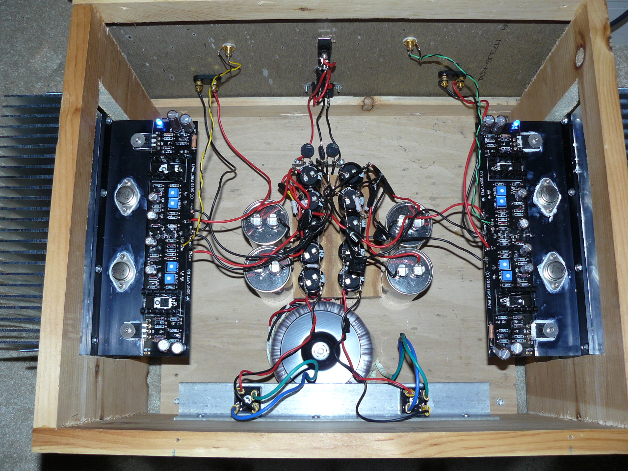

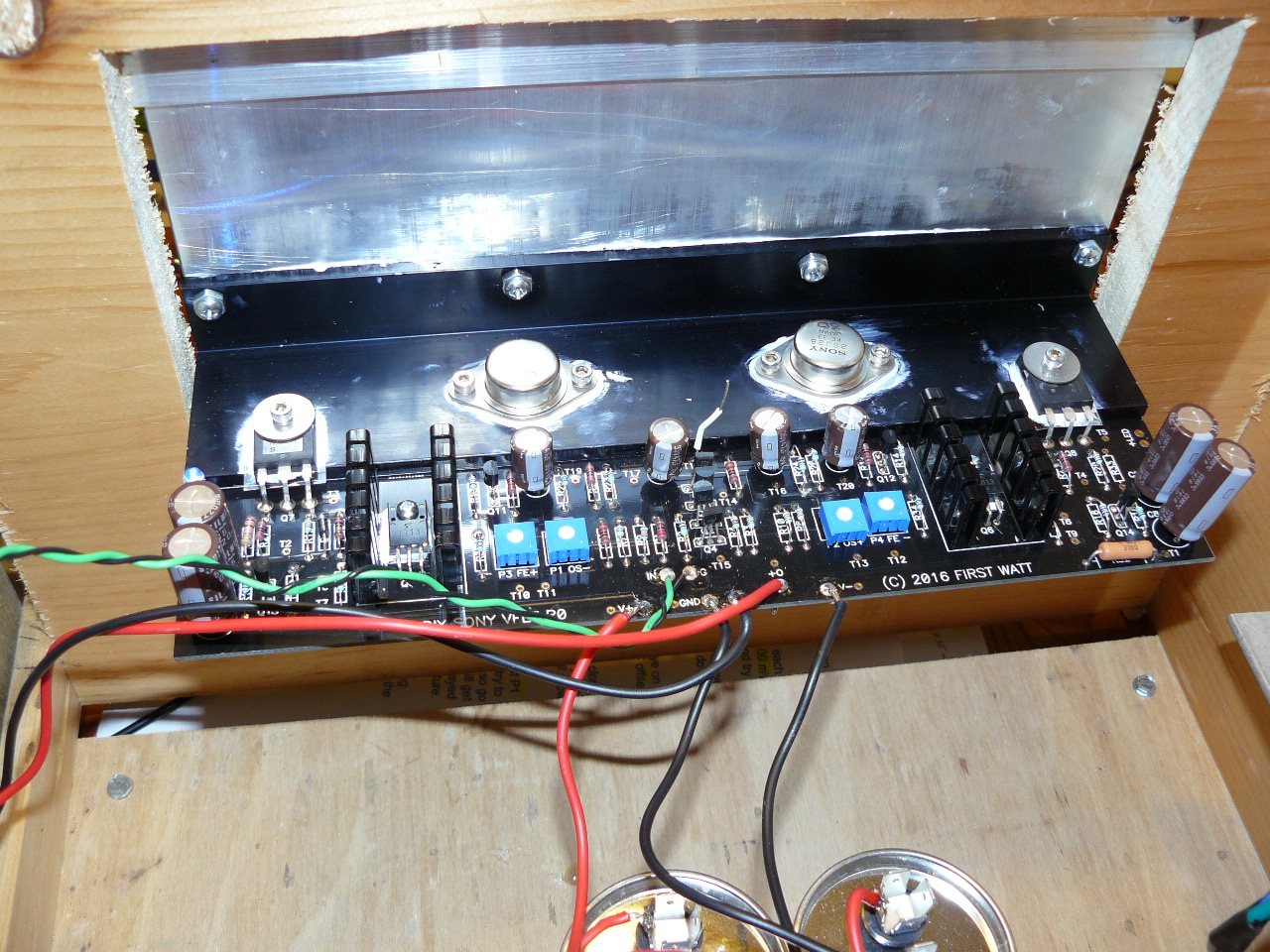

Halfway there. I have one channel up and running. The problem I was having was not being able to follow the directions precisely. After Nelson's comments I decided to reinstall the J313 and K2013 and give them another try. The build itself is straight forward, it is the setup that is more complicated, at least for me. I disagree on one thing Nelson said. He said it could be done with one meter. Do not even try it. He can and a few other talented persons may but it is and was impossible for me to do. It was much easier attaching one meter to T18 and ground and using another to test and set the pots. The one difference I found is when you start biasing up the frontend and have the DC offset low a slight turn of P3 or P4 will make the offset go possible 20V's quickly. Using two meters made it much easier. The other 4 FW builds I have had to set the offset on a small turn of a pot changed in mv's not V's.
Variac has been asking about multiturn or single turn pots. Definitely single turn is what one wants. I first had 12 turn multi's and changed them out for single turn. Much better, at least for me. I will probably wait till tomorrow to work on the other channel.
And yes I cover the power supply while adjusting the pots. You do not want to drop a screwdriver on top of those caps. I built the PS shown at the BAF F6 build where the PS is split at the final cap. I added an additional cap for each section along with a motor run cap for each channel. I build for function not looks. If this was my only amp I would definately go with a Deluxe 4U. From a brief use the amp does not run hot at all.

I used the Elna 35V and the only only place the size did not fit perfectly was the spot in question. George Anderson of Tubelab was where I first heard not to place the caps directly on the boards but leave a little space. He adds a tiny bit of foam under his caps. Has anyone ever seen black lines on your LCD-LED TV that went away after warming up? I have heard this is caused by cap leads too tight on board, no experience only heard. I ordered the pots listed on the BOM and the 500 ohm fits perfectly, the 5K pot leads are not spaced to fit board, I made them fit by bending the leads. Just thought to add this fact, no problem really.

Success. If you follow the explesive instructions on biasing seasoned builders should have no problem with this build. I had one other hitch with the other channel that caused some frustration and anxiety because of builder error. Let's just say be careful with grease and getting a good solder joint. Biasing the 2nd channel was no problem after understanding what it was I was trying to do. Do use 2 meters, one attached to ground and T18 and another to set up the bias.
Many thanks again for Nelson making this project available to diyer's as myself. As for sound I only listened for one side of a LP. The bass is as good or better than anything I have heard with my horns. The jump in you chair drum roll when you hear it unexpected.
I include a picture of my F6 build to show I do know how to make a pretty amp. The store 4U is plenty good enough for this build. With the prescribed bias my amp is extremely cool.
I do need to tidy up the wires and ground all the metal parts. I lived on the edge and could not wait to hear what it sound like.
