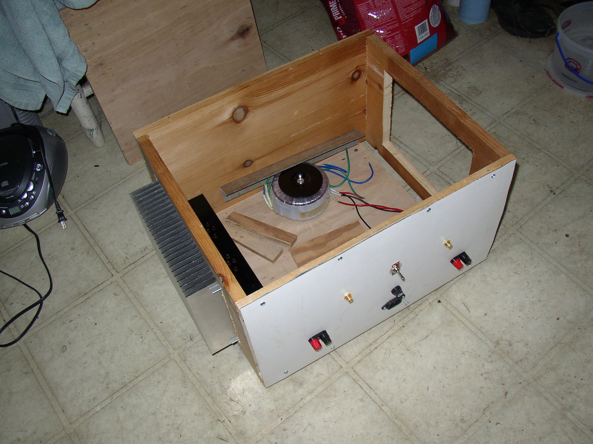

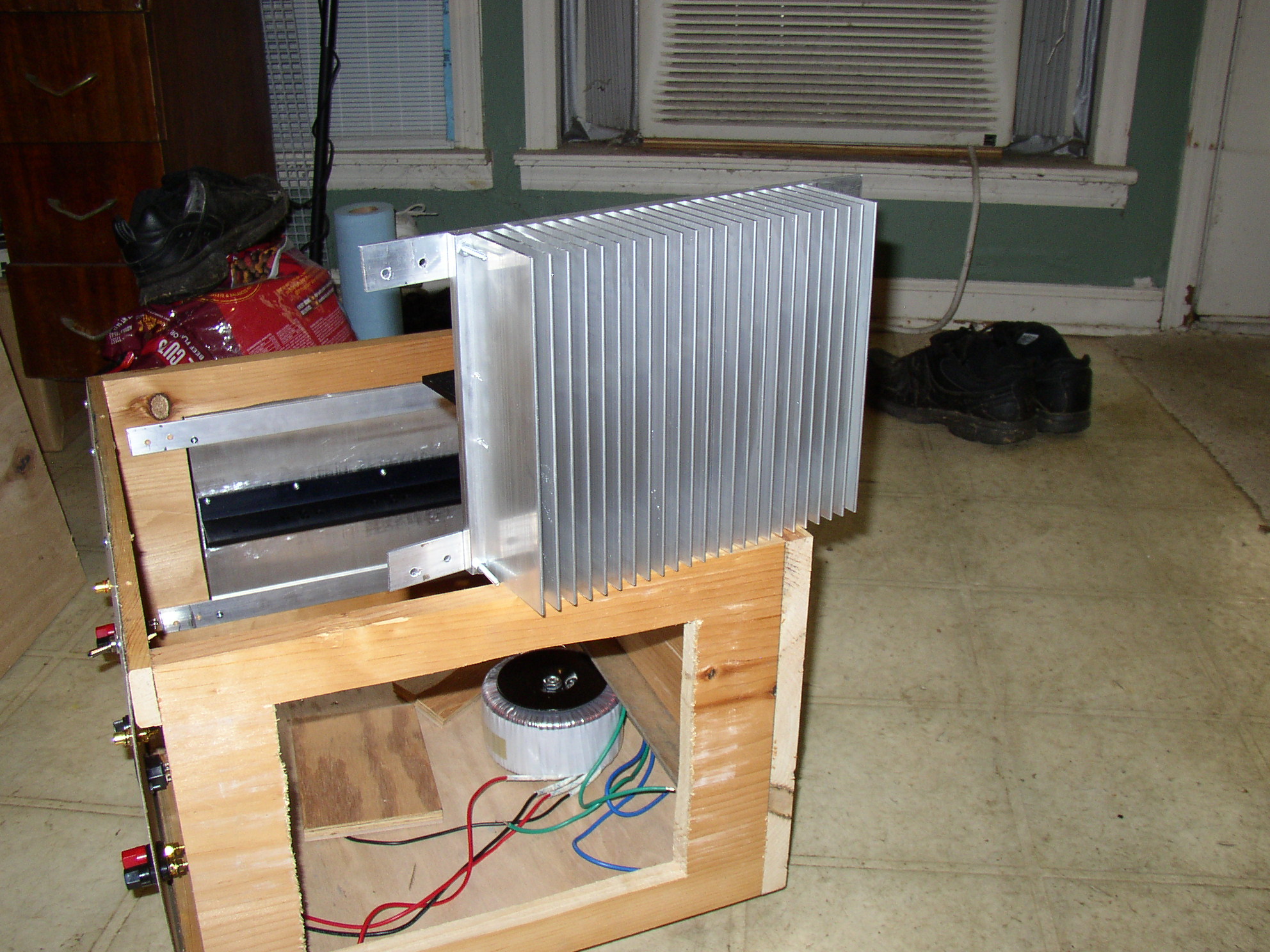

My redneck engineering of a V-fet case. The heatsink is going to be mounted on the outside. I placed it inside for picture purposes. That is a 300VA transformer. It looks small because the case is big and functional. I plan to make the amp mono inside one case at a later date. Also I am going to be installing 4 big motor run caps.
