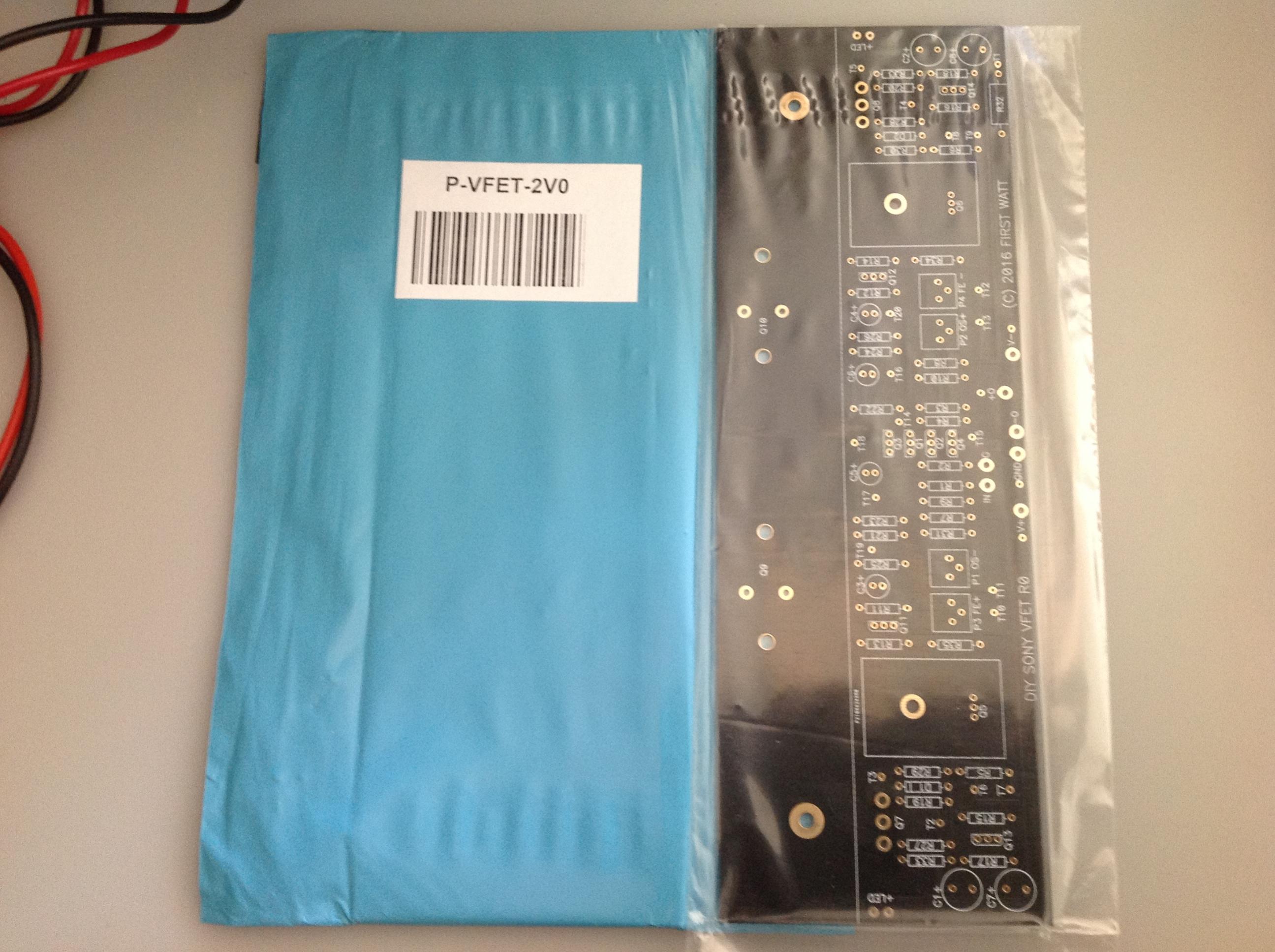

Got my Kit out of the customs today in Germany. Big Thanks to all who made this possible!
Mines still stuck in customs, I hope they havnt decided to keep it for themselves, its been there a week.
Russel, here in Cologne it sometimes takes a month. So there is still hope [emoji2]Mines still stuck in customs, I hope they havnt decided to keep it for themselves, its been there a week.

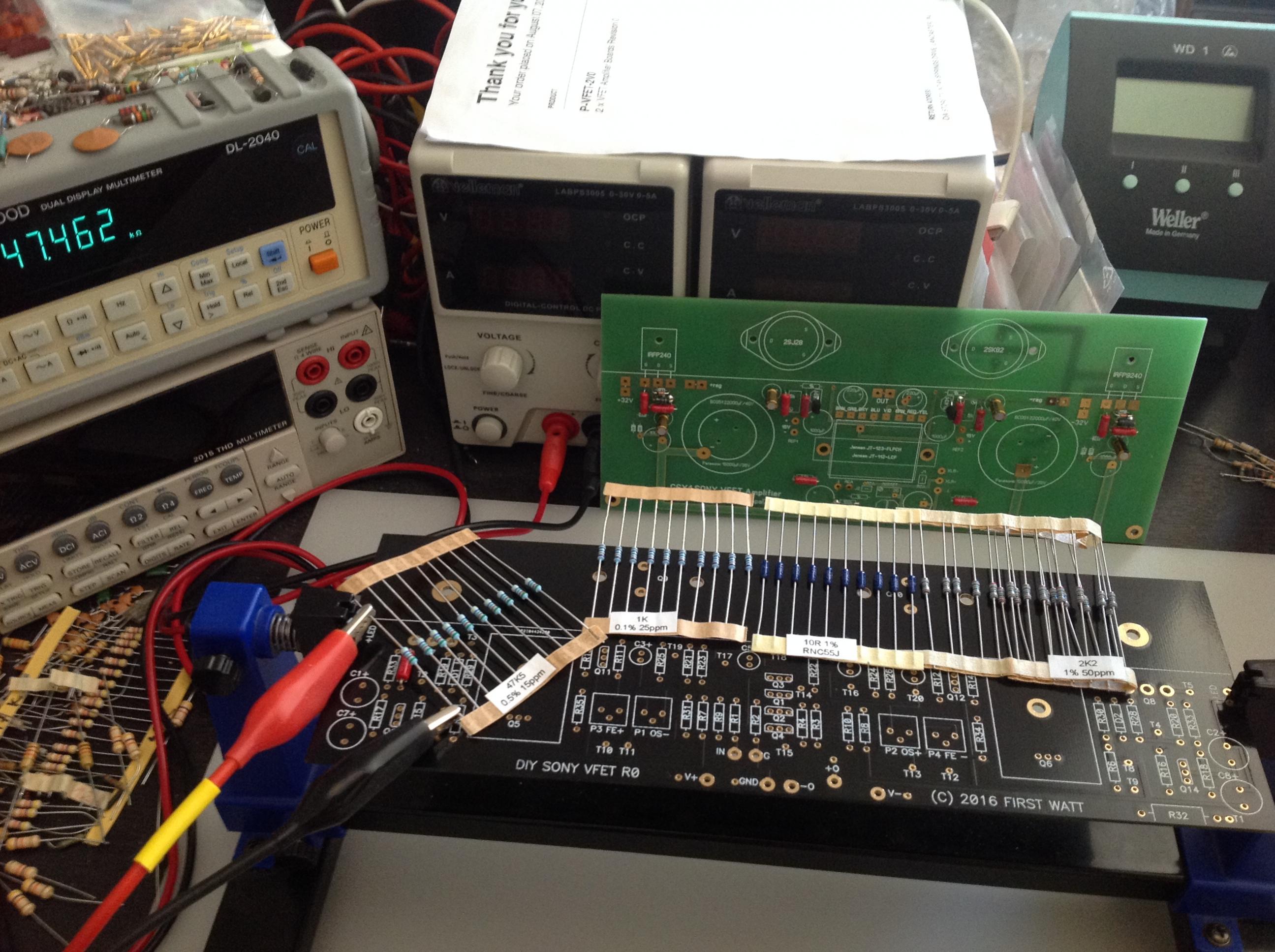

I have my PS built and this morning I stuffed the resistors in the boards. Straight forward stuffing other than being extremely careful when it comes to the 47.5 ohm and 47.5K ohm resistors. I also am becoming more aware of the time and effort Nelson put into this project for diy'ers.

Immediatly start to search for candidates with low ppm to go
step 1 resistors stuffing procedure and tests voltages like in Vfet P2 Draft article.
For the moment at my fiver i do match , verify resistors values.
