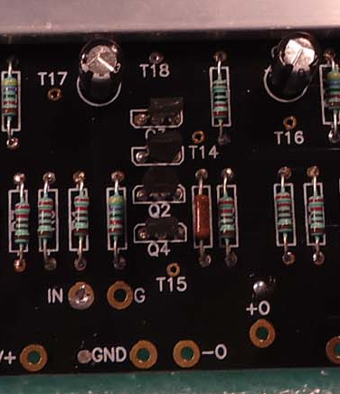

That's is ZTX450 and ZTX550In the pic NP posted, input cascode Q3/Q4 look rectangular and not like the usual BC550/560 shape.
I guess pinout is going to matter here. Maybe other things, too.
What's best suited?
BC550
BC546
2SC1815
2SC2705
Or something else?
BK
I have already ordered the BC550 and BC560 and have them instead. As I understand it they will work but now I know I am going to have to install them correctly. If I had not seen these last few post I would have probably installed them wrong and the troubleshooting would have begun.
Many thanks eagle eyes nagini262.
