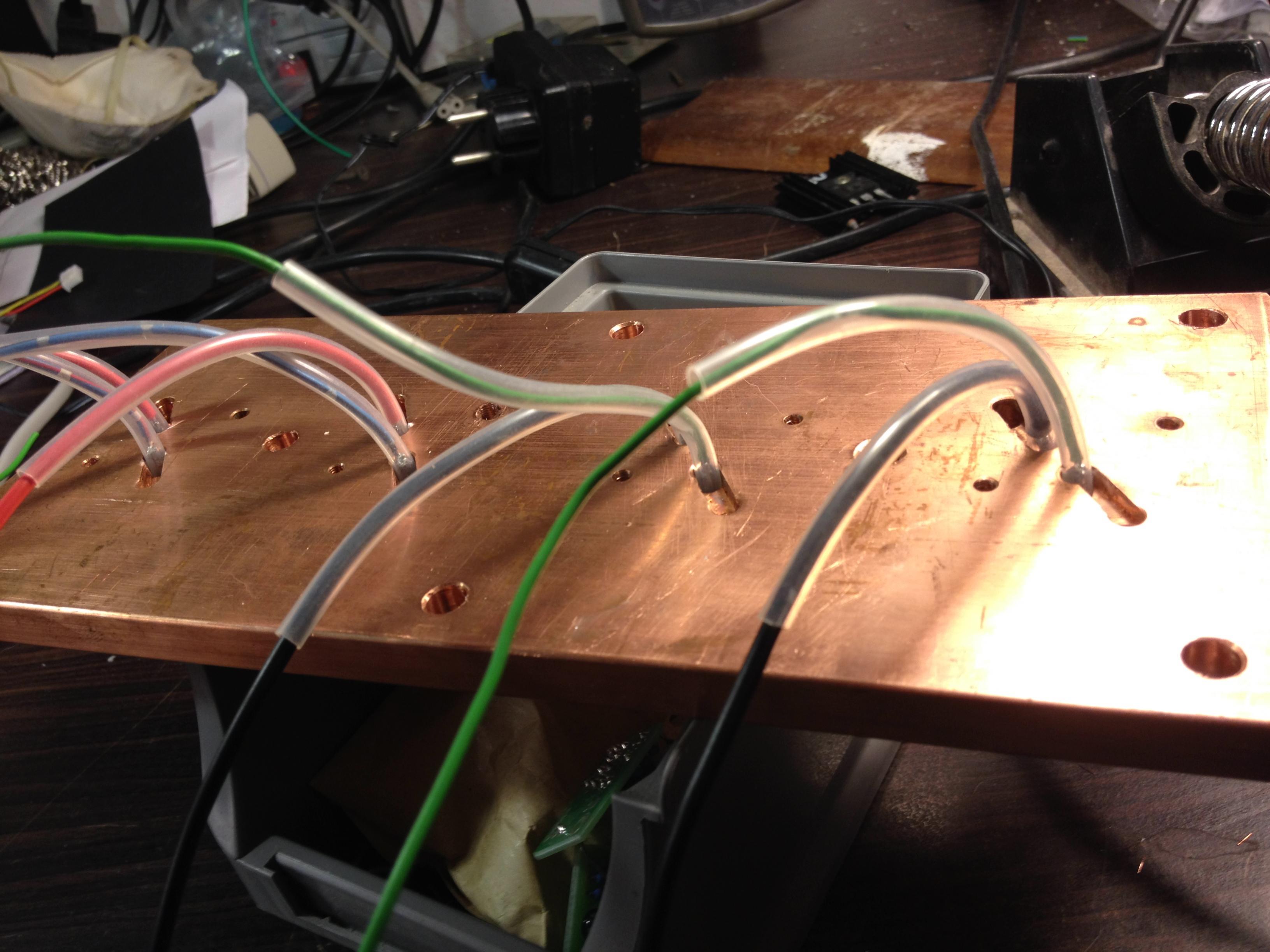

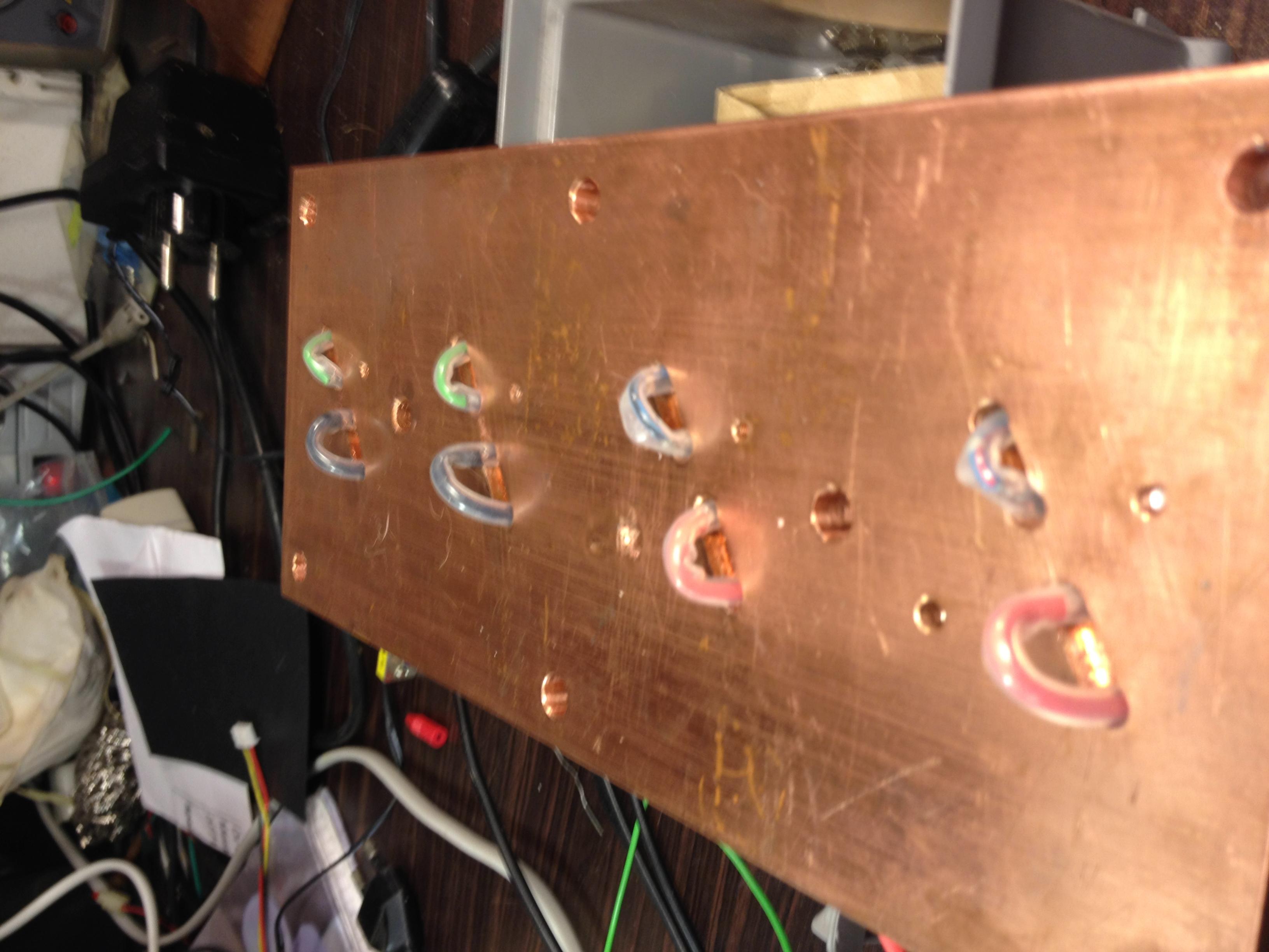

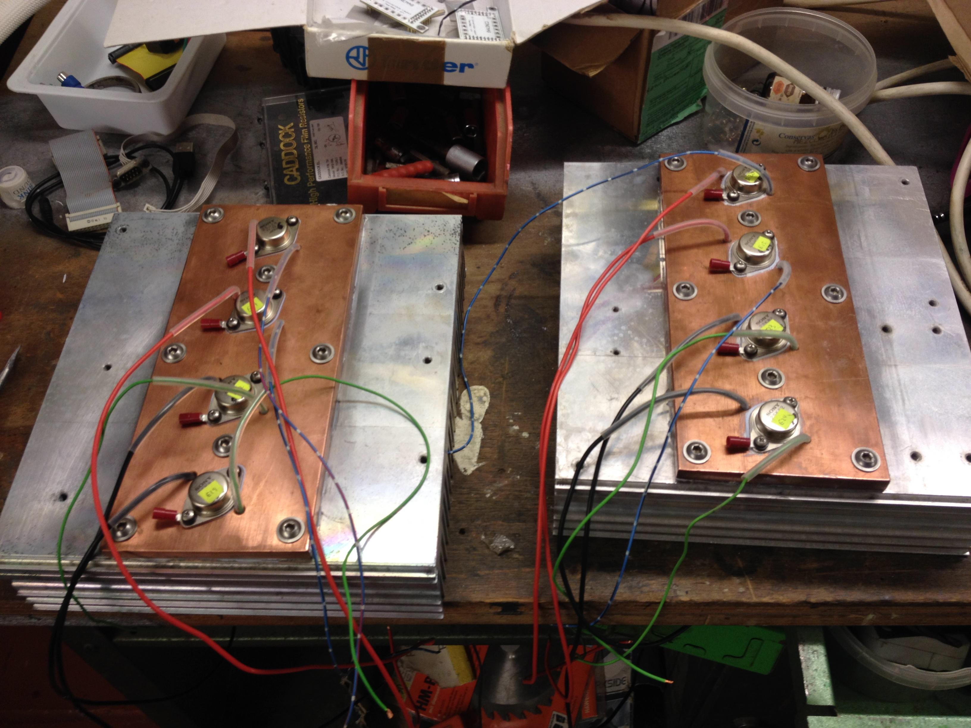

Totally off-topic, but here is my planned output stage mounting scheme for the flexible CSX/VFET projects. The goal was to avoid the cost of the angled extrusion as nearly anyone will CnC a piece of flat stock. I am not sure how well it will work, but we will see. It's mounted to a Conrad Heatsink in the photo through a piece of copper bar. I need to get properly sized teflon tubing for the TO-3 pins and screws and I think I am ready for some fireworks.
Either the angle or this could be pretty easily hand drilled with a bit of patience
The holes for the pins seem small - might give extra fireworks!
Ah, you really did mean tubing! Here's the angle specs for the one pair per side. 1/4" aluminum "L" angle is pretty easy to find if you don't find the "t"shape. But it might help people making flat plates too...
http://www.diyaudio.com/forums/atta...68-sony-vfet-amplifier-part-2-diy-bracket.pdf
luvdunhills flat approach would give more room for a PSU probably.
Here's the pin spacers we used
http://www.mcmaster.com/#94639A300
They are shorter, 3/16" because the made in Italy brackets are actually 5mm thick.
McMaster-Carr does have 1/4" long sleeves also
