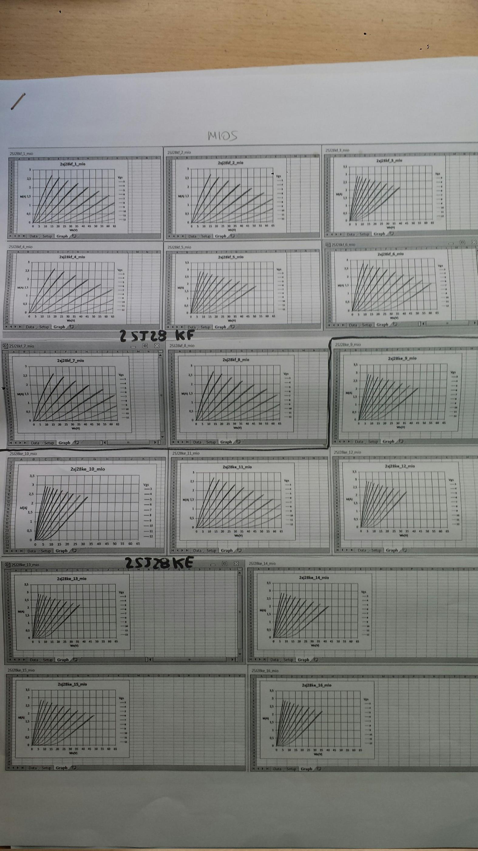

Look curves from 2sj28 mines. A lot of variability. We need to do a big pool for matching a big number of devices. A lot of work. Who wants to do?.
For one person is too much. We need some persons within different regions of the world. A big effort.
Is it enough matching using one point only? I do not know. This is a question that we need solve. And other question, if we have two 2sj28 matched, for example, now we need matching to other pair of 2sk82, or not?
When I did lamp with thf51 I used two randomly selected. It was a shock for me. Then I exchanged with other devices with curves almost equals, but they not sounded well. I do not know why. When I used the first pair all sounded well again.

I have measured 16 VFETs and found 4 reasonable pairs. 2 P-channels and 2 N-channel pairs.
Because I bought some more then needed, I'm willing to sell the possible useful VFET's to others here. Or even give them to you
I built the CSX1 VFET Amp with my worse VFETs, and it sounds great.
P and N don't have to be matched, the differences are to big anyway.

I think this is our singular target.
from Vfet 2 article
" matched the VFETs for a Vgs within 0.1 volts at 0.5 amp current at 20 volts,
and 0.2V Vgs is good enough."
From 40th aniv article
"Fortunately these parts have a near-zero temperature coefficient. They require
no thermal compensation and can be relied to give the same performance over
a wide temperature range without altered performance."
So I am not sure we really need to be concerned with heatsinking at all, and maybe just a basic measure will do.
I think if we all wanted curve matching in a skeleton market, we are being too greedy.
And as mentioned, it may not even sounds best to human ears. (I would welcome Mike's Frankentracer based comments). I am willing to throw away perfection in order to get the most usable parts extracted and used. I am more pragmatic than perfectionist.
Please correct me if my assumptions are wrong or skewed, they often are.

Yes, curve matching is total overkill here. Look at the procedure I did on my Lab Hangout. It's the one NP suggested and I demonstrated it for soundhappy, or Frankentacer makes Vgs matching super simple as well (I can actually do it faster on Frankentracer so that's what I use.), but curves aren't needed for this endeavour.
Tokin SITs are much, much more widely varied than these Sony's, and there are some bad parts out there. Hence the curve tracing.
