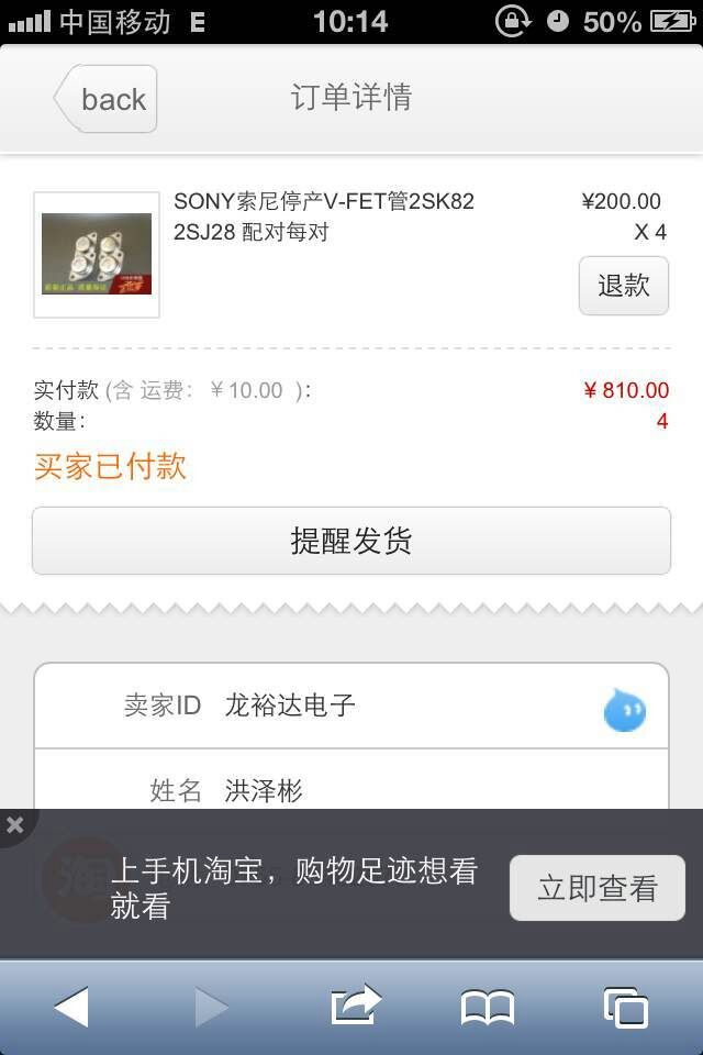

I have never had any interest on PP design, but this beast seems different. I'm so lucky that i have a colleague worker who is located in china and help me to buy 4pairs (is it enough?), and hopefully they are genuine. I already have 3pairs of 2SK82 from acronman intended for sit l'amp????
Note that not every country can shop with TB, and many TB sellers cannot communicate with English (not sure about this one). I bought some Yamaha 2SK76/SJ26 from this shop before, and as far as I can tell they are authentic.

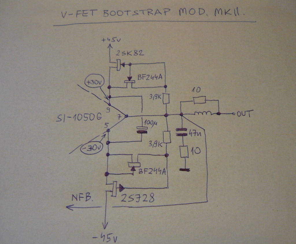

I post that amp circuit here, in case that will be a problem please feel free to remove it.🙂
Thank you
I do not want to hijack the forum!
Greetings
That two pair useless for these project.
Thank you
Greetings
