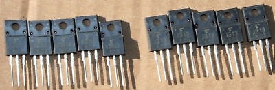

Thanks for next fascinating project Mr Pass yes this PP be built
many amateurs was aware about so matched Vfet pairs be done
, LSK matched b grade jfets are in DiyAudio store from time to time ,
genuine Toshiba and Irfp´s with dale, vishay R60 resistors 40 values kit
we can buy in one shot at Alweit AudioFet shop voici link:
4X 2SJ313 2SK2013 Original Toshiba MOSFET 2 2 | eBay
Personnaly my dream need is pcb's for Vfet Common Drain
could please be possible make small run for sell in PassDiy store ?

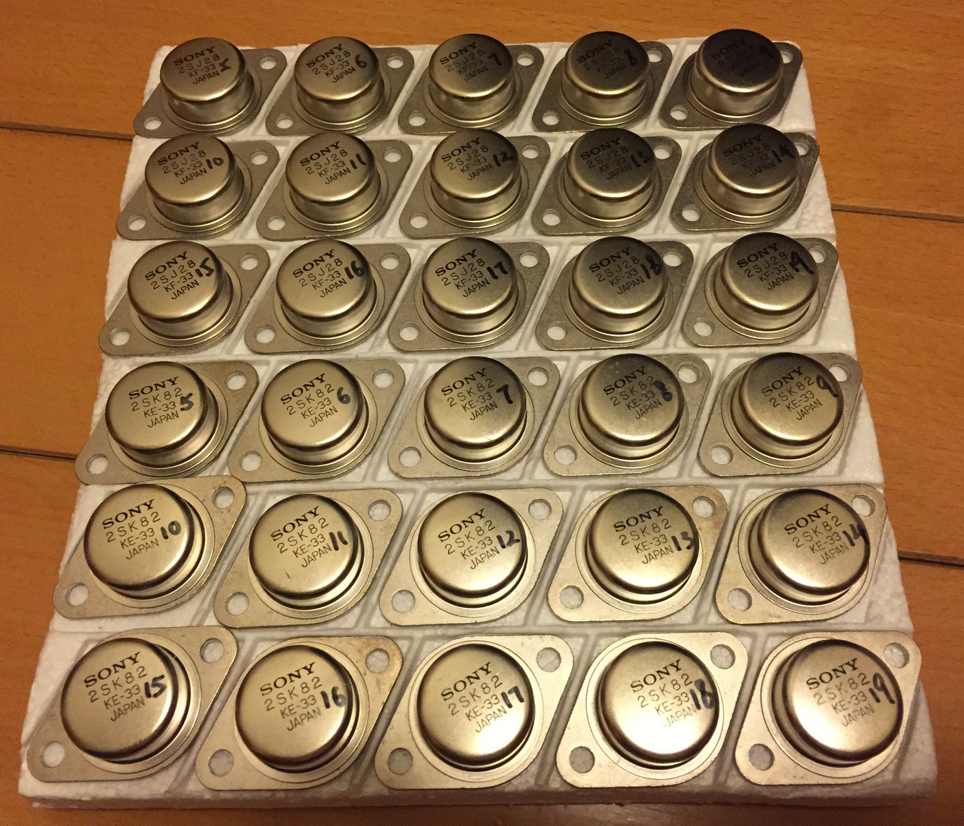

Some TB shops in China still has the 2SK82/SJ28 available (just talked to one shop and they have around 150 pairs).
Those who have means to buy from TB can try their luck.
Note that not every country can shop with TB, and many TB sellers cannot communicate with English (not sure about this one). I bought some Yamaha 2SK76/SJ26 from this shop before, and as far as I can tell they are authentic.
Maybe you or another diy-er in country could organise a group buy?

Thanks for the suggestion, but organizing a group buy is too much of an undertaking for me 😱. I helped a forum member in Europe to order a stash of Tokins a while ago, and I found it quite stressful to make sure everything I sent him was good, so I can't imagine how I can handle a GB.
I have a few (4-8) pairs I might offload at cost though (got them to be able to find some matched pairs for this part 2). Those interested could send me a PM, but there won't be matched pairs available.
