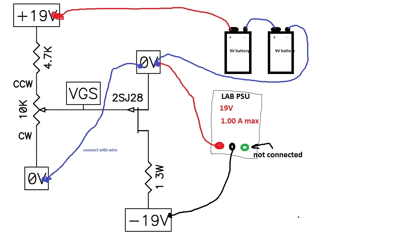

Hi. Can someone explain to me how to measure the Sony VFET to match them?
NP mentionned in his article to match them for Vgs at 0.5A and 20V but no more details.
Is it that for example we connect the VFET to a 20V supply, limited in current at 1A for protection, and then we inscrease the Vgate until we meause 0.5A at the drain?

I had to measure some of my parts for the VFET V1 build. I just measured using a 19V laptop brick, 2 x 9V batteries, a potentiometer and a small value resistor.
Use the 9V batteries in series for the bias with the potentiometer to allow adjustment. Set bias to -15V before main power is connected and then just slowly turn on until 0.5A is detected via a small resistor.
I didn't use any current protection, however that could be useful to make sure that you don't fry any parts.
All my parts biased (in the amp) between -6V and -11.5V so the -15V start bias should be low enough to ensure no current flowing in the part at the start of testing.
The whole rig can be flipped to test the 2SJ28s pretty easily.

Hi Algar
Other schematic are in case if you don't have two lab psu's.
