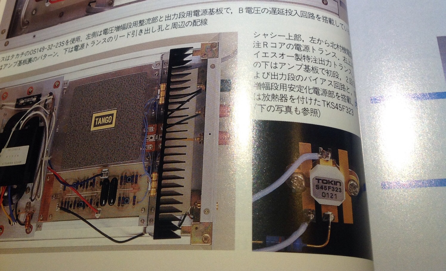

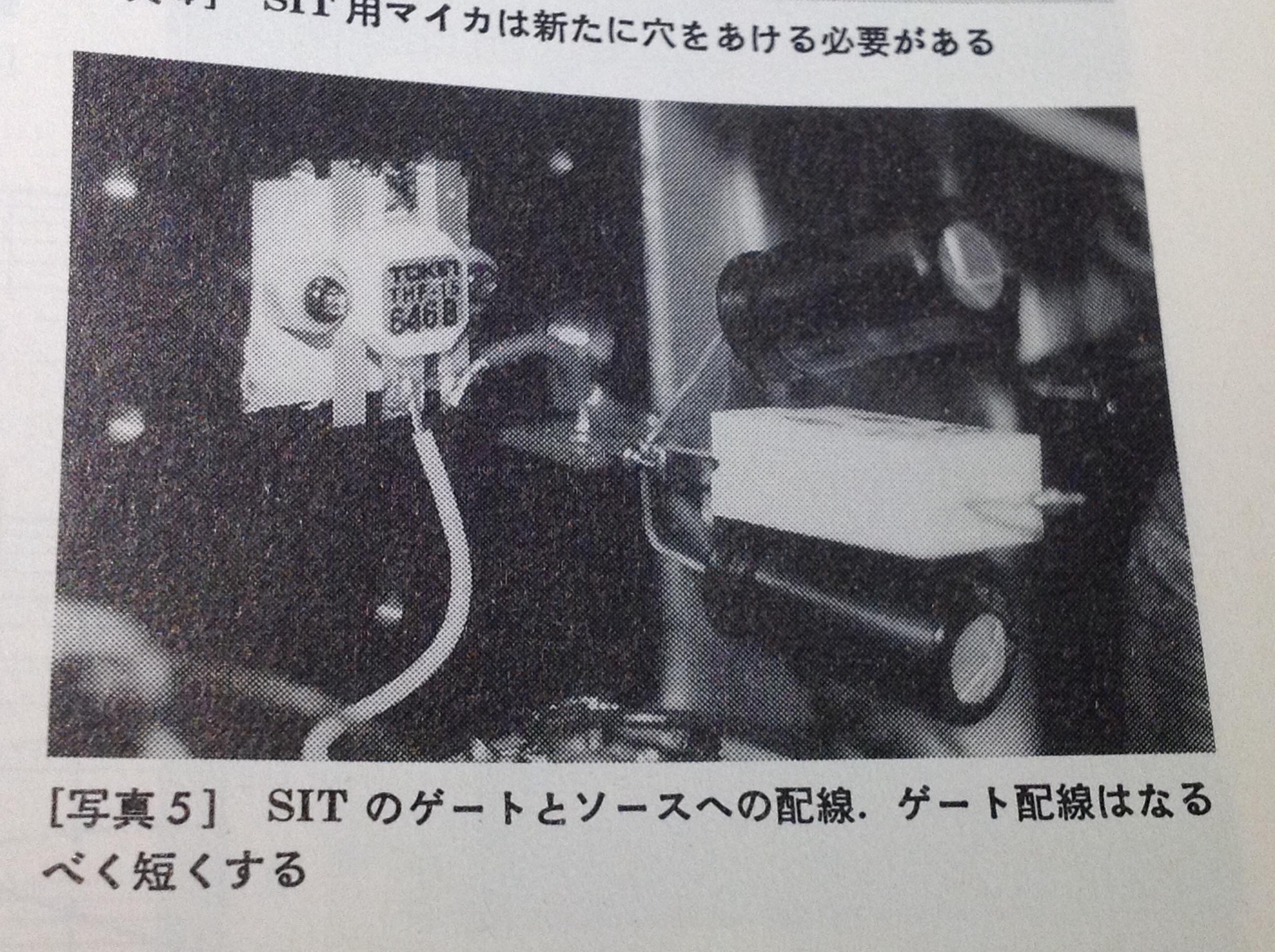

It is. Where can you buy those devices?
They are very rare Tokin sit's only small run was made 🙂It is. Where can you buy those devices?
Hey Master! You finally found the real thing.
Welcome Ralf!
Best Regards
They was used only in diy projects not commercial product was made contrary to few Sony's.

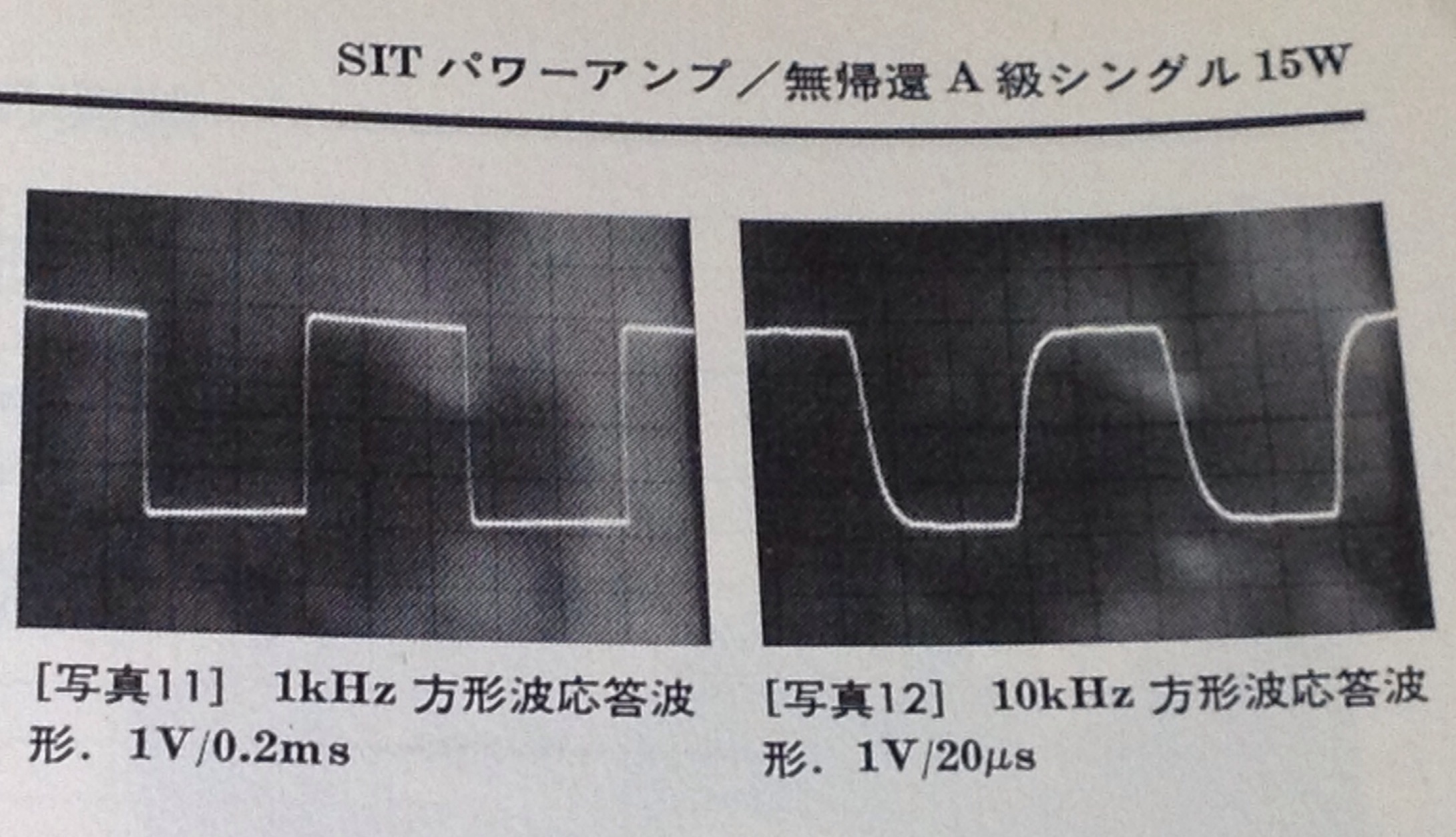

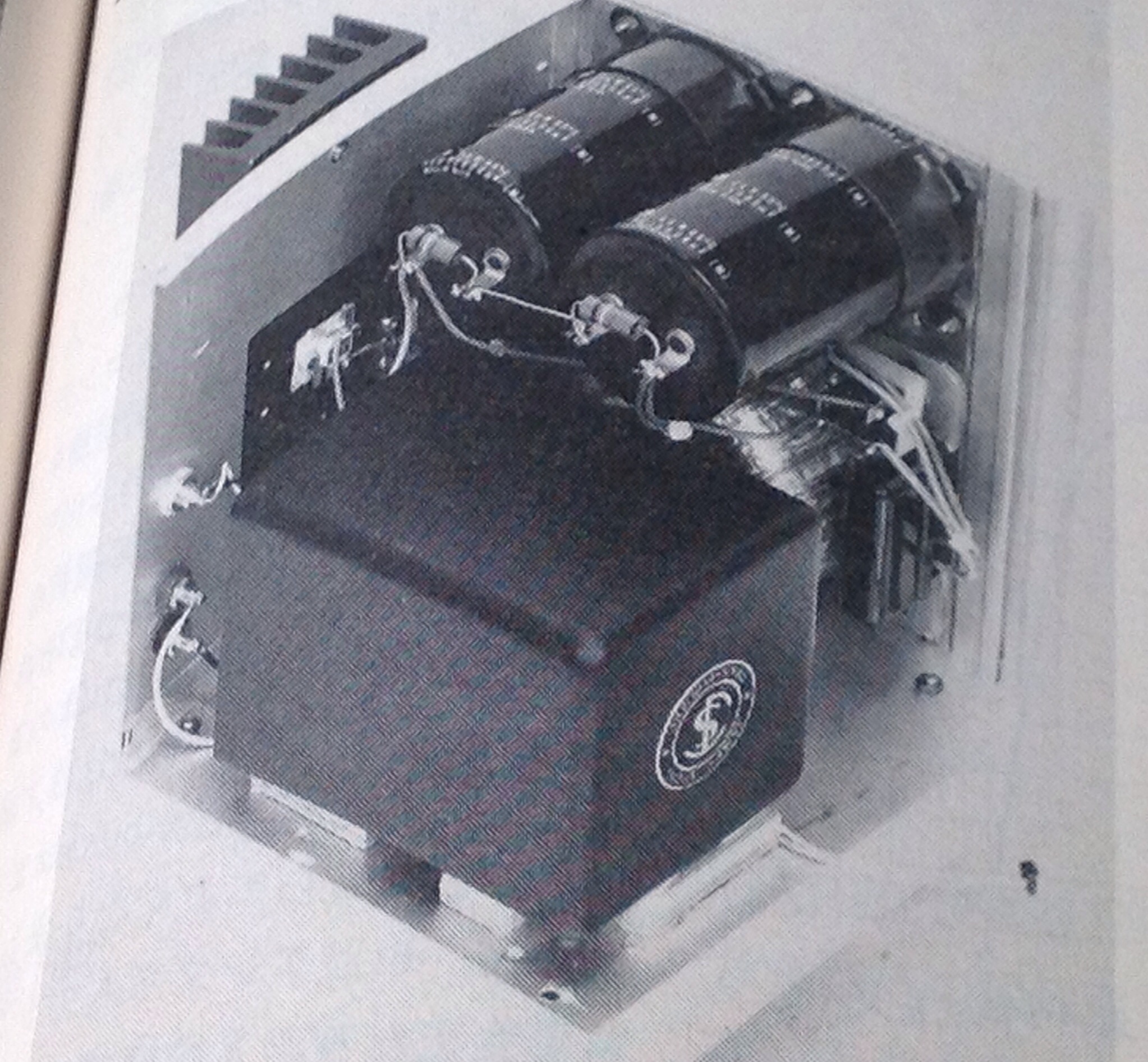

I know some TKS45F from MJ articles and other THF-15 sit as well.
Who belive strongly can find every thing for example asteroid stone in his garden or Tokin semiconductor triodes 😀
Let's back to the topic with 2SJ28 and DiyAudio Store kit are much more realistic.
