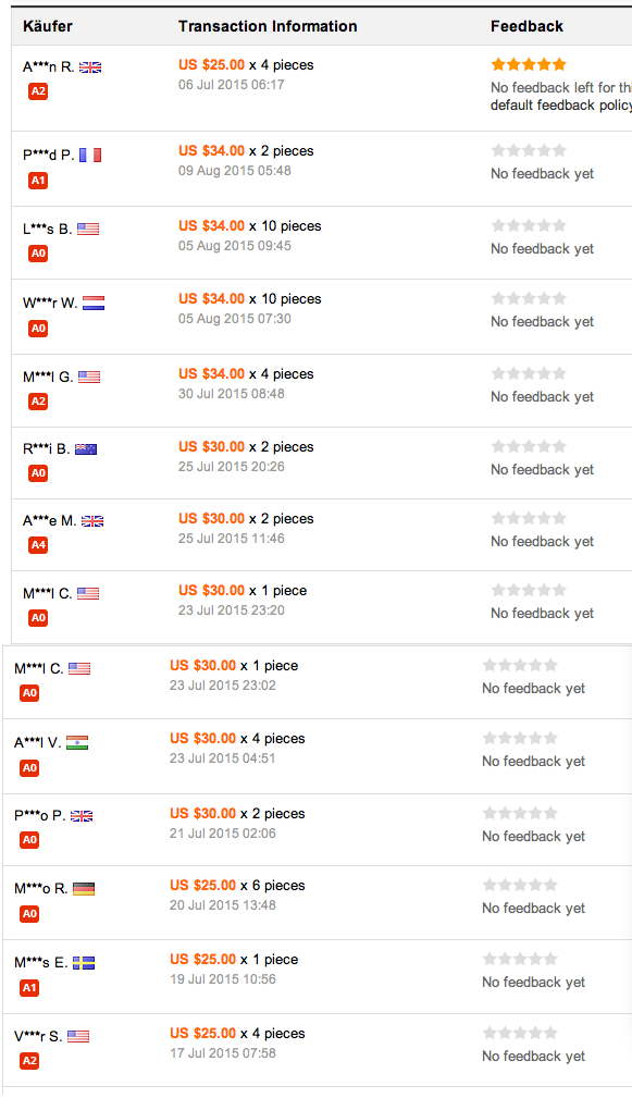

AliExpress lists all the buyers for an item.
i orderd mine on th 20th july, anilva, you orderd yours 3 days later and
got the fakes. but i don´t know where Fast freddy fits in the list, did you
order your´s on the 17th july ?

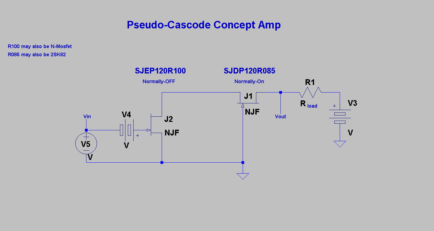

Like many of you, I asked: What can this proposed build by Mr. Pass be? I have no doubt that we'll find out in good time. In the interim, I scribbled a schematic to attempt and tackle this problem at hand.
The attached is a schematic of a cascoded amp. The cascoding device is a depletion-mode type like 2SK82 or SJDP120R082. Please note the following:
1. The term pseudo-cascode means that Vds of NMOS [or R100] is not a constant voltage during operation. As its dynamic impedance changes [say decreases] the source voltage of the VFET also decreases so as to accommodate the increased current enabled by NMOS or R100.
2. The depletion-mode device [2SK82] operates as a common gate power amplifier.
3. The VFET properties of 2SK82 are preserved. For any value of a drain current which is common to both devices, this depletion-mode device ascribes or associates a certain Vgs to it which is solely dictated by its Volt-Amp characteristic. The voltages at the terminals of VFET float [as a function of Idss] like those of any other device used to cascode others.
4. There is also a hypothetical schematic which complements the attached one. I'll show both schematics in two hypothetical applications in the next post.

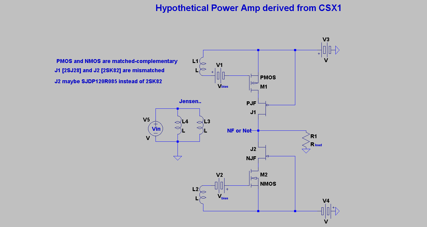

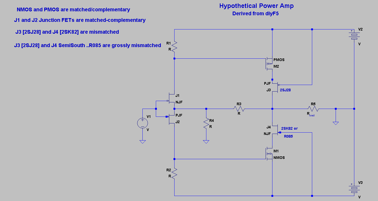

Schematics of 2 hypothetical apps are attached; namely a modified diyF5 and a modified diyCSX1. A common approach is used in both.
1. The NMOS and PMOS in diyF5 and in diyCSX1 must be matched-complementary. The N and P VFETs need not be matched. This approach attempts to tackle the problem at hand.
2. What gives? Vds of NMOS and PMOS are not equal; reflecting the mismatch of Vgs of VFETs at any constant Idss.
3. What if I introduce a gross mismatch; like using 2SJ28 and SemiSouth's R085 [instead of 2SK82] depletion-mode devices? Concept suggests that it'll work; because the principal operational players are the N and PMOS like in any cascode system.
4. The output impedance of the modified CSX1 is higher than the parent's 4 Ohms?; because the dynamic impedance of the Mosfets are in series with that of the depletion-mode devices.
