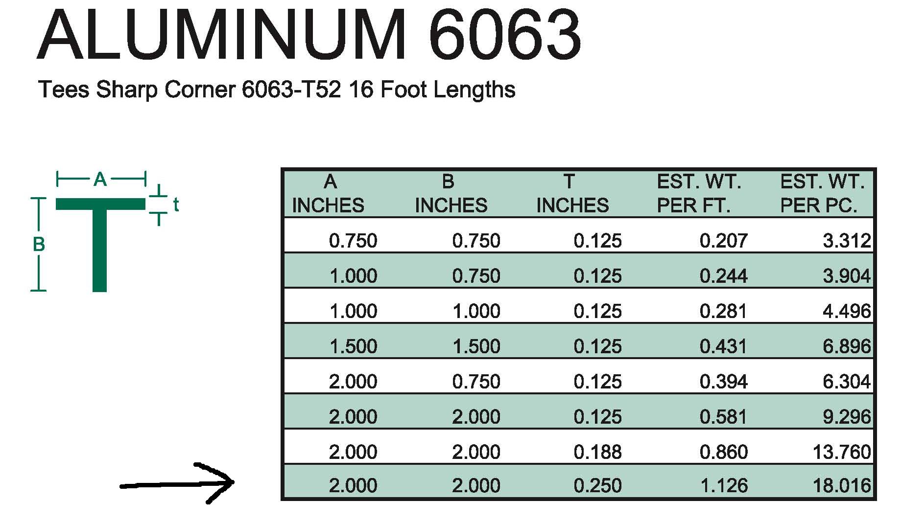

I have drawn up a T-bar mounting bracket to fit the 300 mm deep heat
sink (also will fit the 400 mm) chassis offered in the DIYAudio store and
will be doing a pc board to fit it.

@ Mr Pass
Woow i see bunch of happy Diyers with vfets amps in near future
all possible by generous mind and energy of Mr Pass thanks marvelous !
Could be possible to keep on new single pair pcb version
feedback or nonfeedback switch connection from original
vfet part2 schematic ? Please :happy1:
This is cool & interesting audiophile option for sound tests in real time :note:
Best regards
