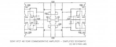

Don't know what you both mean, but this is what I want to build, see picture.
I see it's not a half 40th anniversary but only a third 😀 (with 2 matched VFETS instead of the 6 Nelson used).
So I need 4 pairs of matched 2SK82 and four pairs of matched 2SJ28 for a stereo amp.

Dear, you are wasting a lot of vfet in a source follower, anything you use is the same. The key is the symmetry of all the front end. The rest is almost transparent. If you got 2sk60/j28 in enough quantity you have the amp. The dissipation is not much.

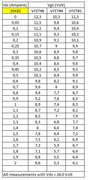

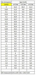

Did some measurements of the VFETS I have using NP's suggested method in this thread. As suggested by him, I measured VGS for 0.5V across 1 Ohm resistor on the drain pin. I think I have few near matches, but not close. Can members kindly comment if any of the pairs is a viable pair in the VFET2 circuit?
I will hazard a guess that some of the gurus on this forum can make them behave similar by altering the VGS closer to the other matched DUT at a required current rating like 1A, but it is way beyond my capability.

I would pair the 7.81V 2SK82 (from pair 1) with the 7.92V (from pair 3), then with pair 2 also you have 2 matched 2SK82 pairs that are within 0.2V. Your pair 1 and 2 of 2SJ28 are very nice.
So you're in business to build a part 2 with 2 pairs per channel 🙂
