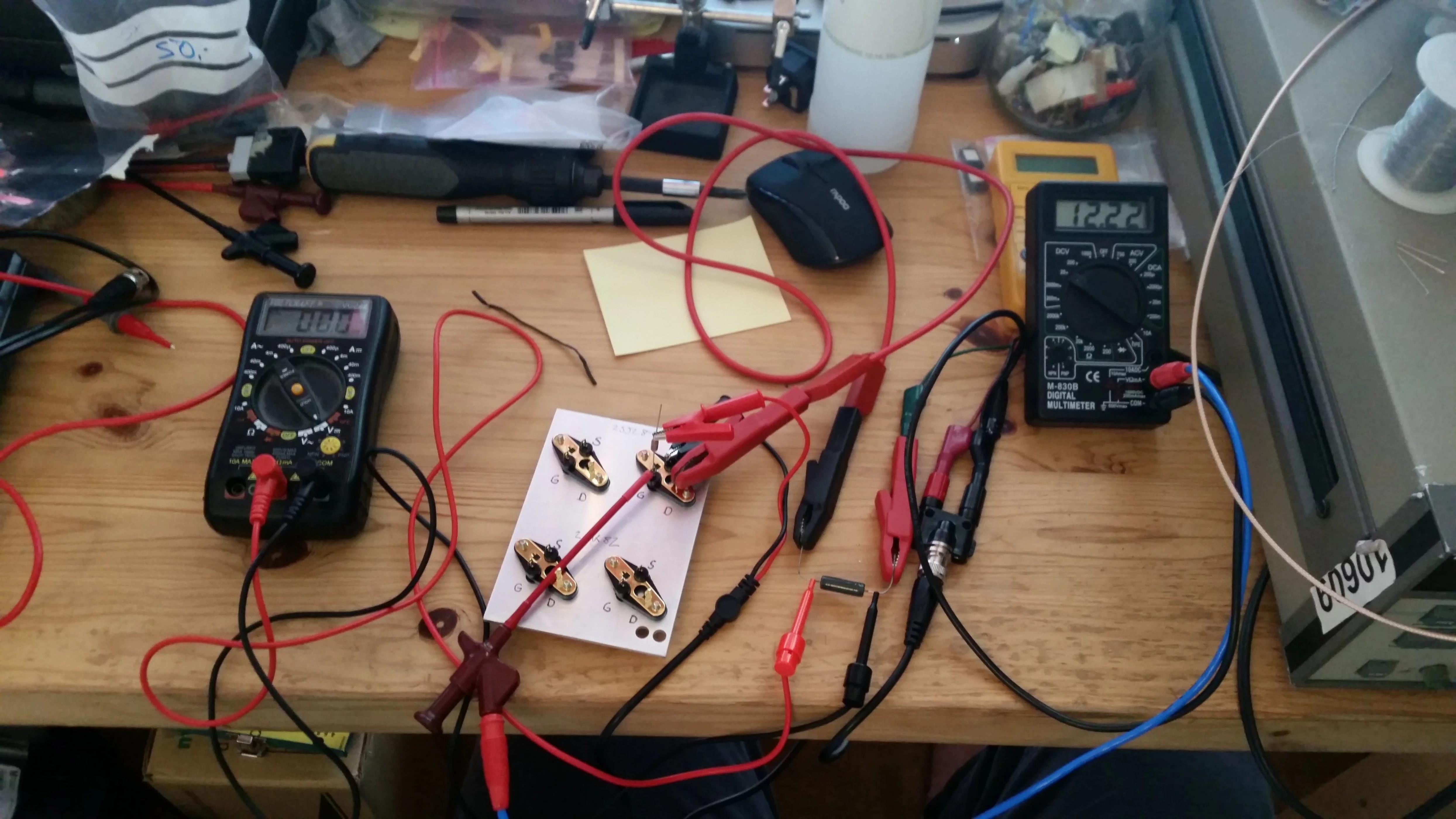

Attached you'll find the setup that I used for Vgs grading. VFets have near-zero temperature coefficient, hence the bias won't run away when the part gets hot (this also allows for the omission of a source resistor in-circuit). On the other hand, this also means that you don't really have to wait for the parameters to settle, you crank up/down the gate voltage reasonably swift, read the current/voltage, and shut the VFet off again.

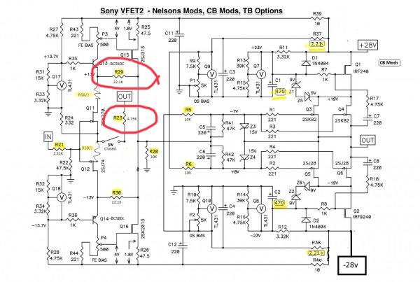

Compared to the DIY board there’s a difference in the global and cascode feedback.
R29 22.1k Cascode feedback doesn’t exist,
R23 4.75k global feedback with omitted ground, vs 2.21k and 332R to ground.
What would be the consequence of trying these two ideas?
I have searched and there’s no real answer to these ideas.

It is the balance of front end vs global feedback.
R29 reduces the front end gain. R23 increases the output gain.
Both together lowers the total loop feedback. These are where Nelson put them for the double output version. With the single output DIY version he said it needed more feedback to get the performance he wanted. Also keep in mind that some of these changes are to make it easier for most builders to be successful.

The original vfet part 2 article version didn’t sound great. The values in the schematic above are what I’m running and it’s a big improvement over the original. I’m sure that’s why Nelson changed them. The DIY single pair version sounds closer to the modified double output version than to the original article version.

So you applied more feedback, have you?

I was wrong about omitting the ground it is located @ R24 and is the same value.
So from what Ive learned R23 is global gain:
750r initially with 150r to ground behind the switch
4.75k omit 150r to ground (changed by Papa)
2.2k on DIYkit with no Cascode feedback.
Cascode feedback on Pt2
10k initially, changed to 22k
This looks like a lot less global feedback. But more than having the switch open. I like options so I am trying to understand before I let the smoke out.
