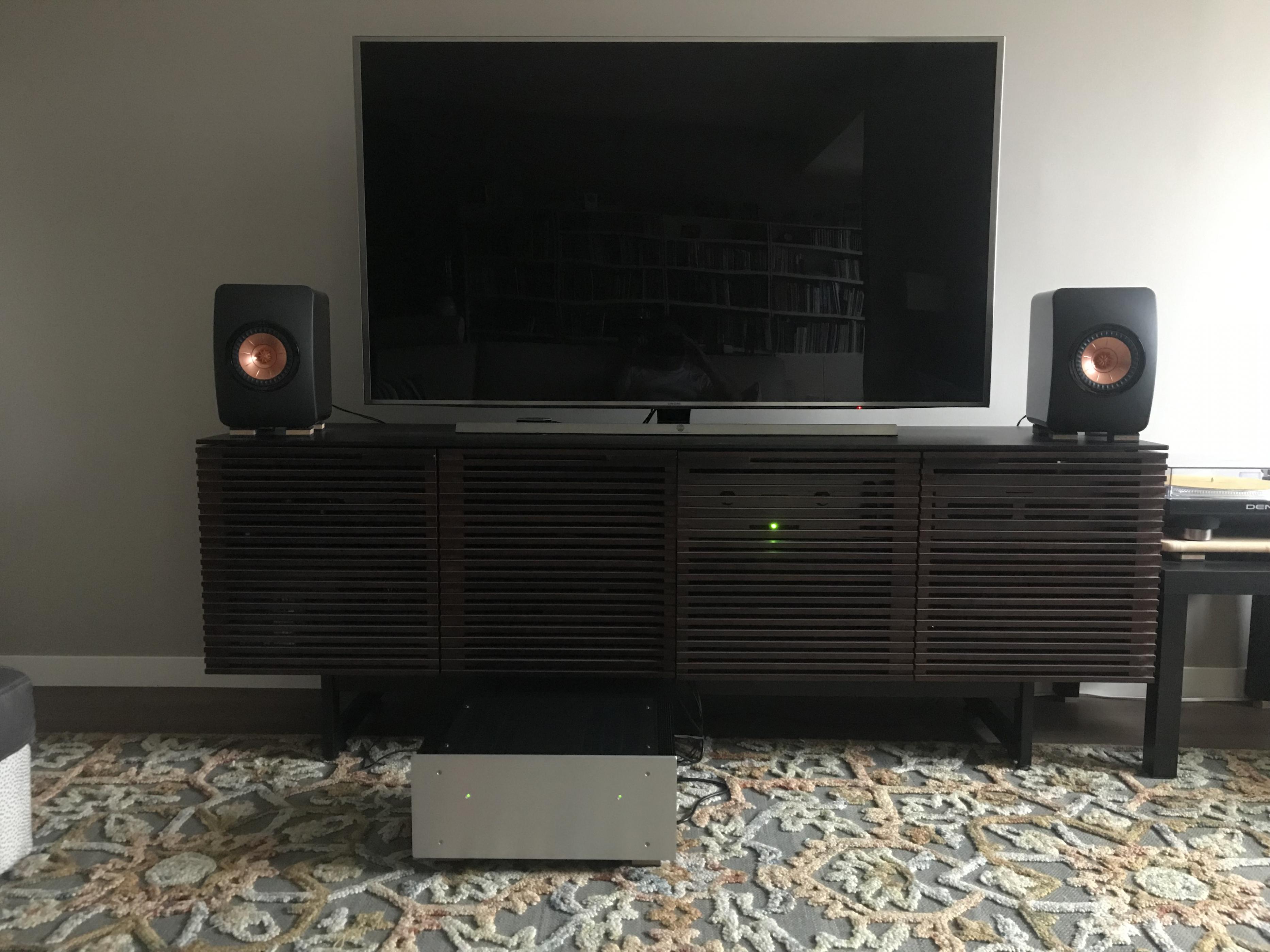

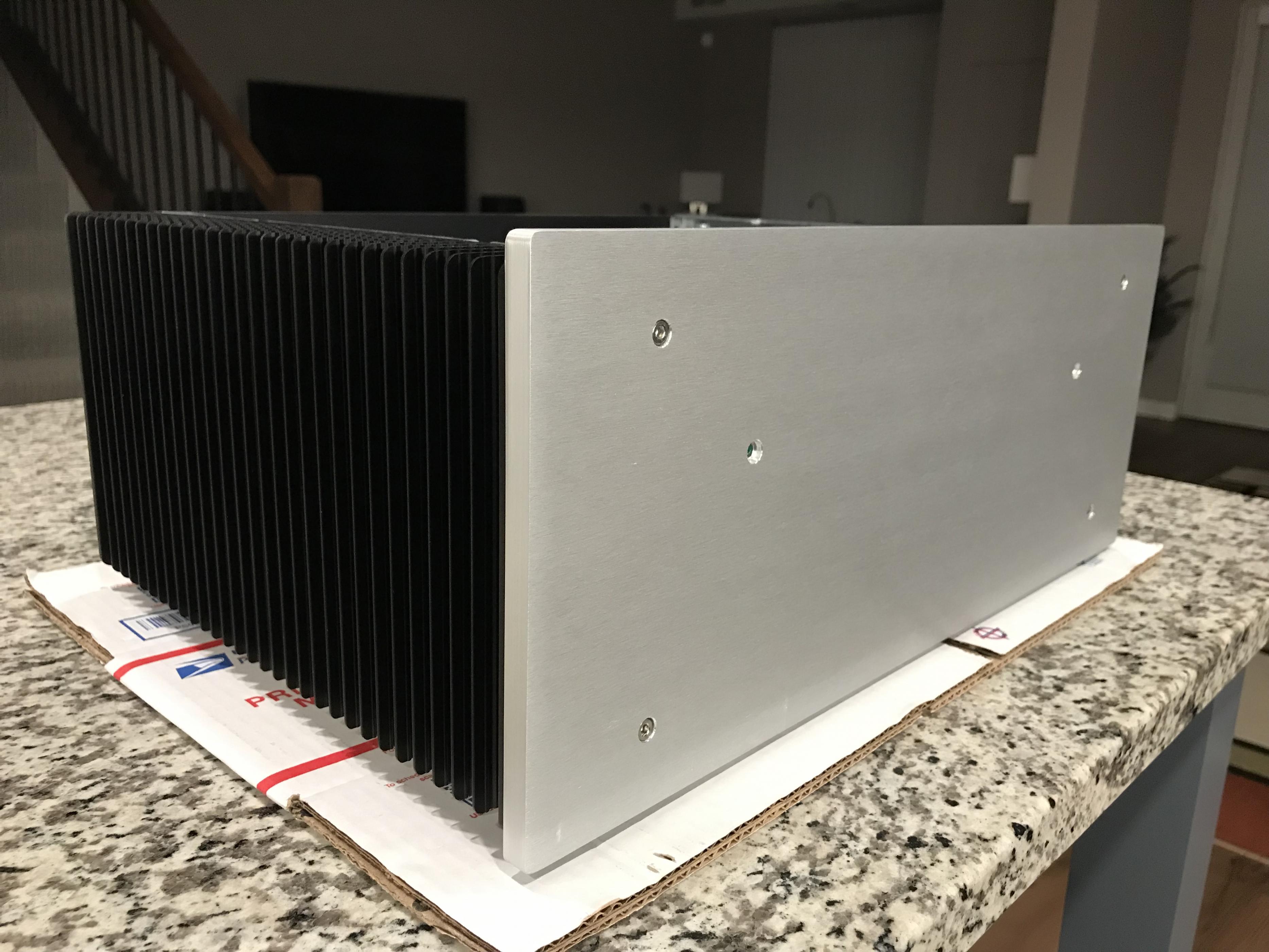

Oh if only there was a kit Stateside or in Canada!
If I knew the seller, his price with VAT and shipping is worth spending. This amp is fantastic and one of the best I’ve heard in my system.
7D860C7B-84E6-4DD3-B61B-6B45055187D2.jpg 82406A96-2709-42D5-9080-E758F2171B02.jpg
