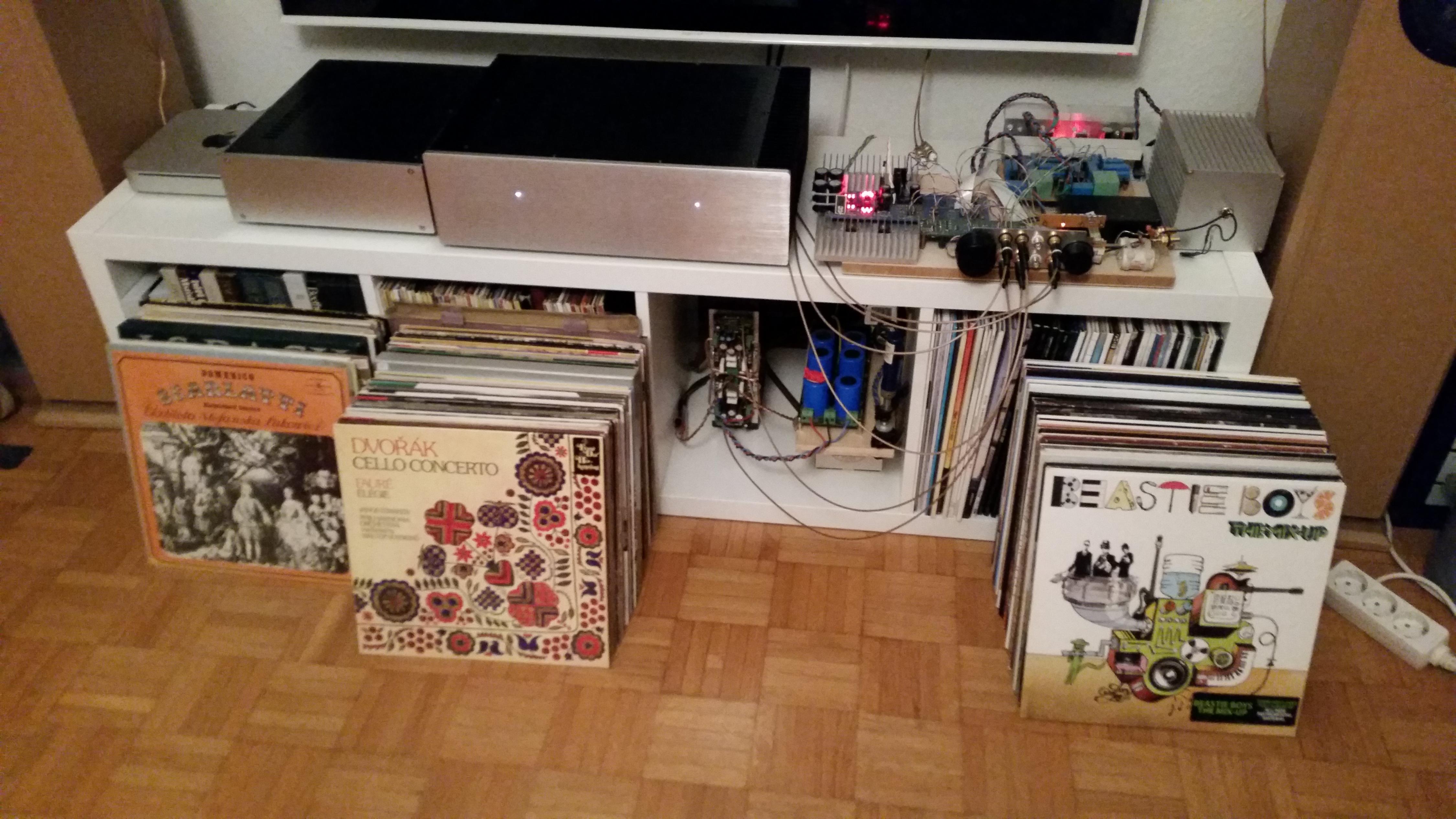

hi rodeodave
that's a nice looking amp , may i ask you about the size of the case, looks like 430*310 cm but how high is this case? i wounder if i can go with a 12cm high case for the vfet amp.
I've built a 24V version of the amp, since (some day) it will be employed as a tweeter amp. Currently it's a mid/woofer amp for my bi-amped 2-way speakers though. With 1A bias per device the total dissipation is thus just below 50W per side. A full blown 28V version would likely run too hot in the summer (with the lid on).
The enclosure is a BZ4312 type ordered via aliexpress with the following specs (quote from the product description):
"External dimensions: width 430mm Height 120mm Depth 120mm
Internal dimensions: Width 330mm Height 112mm Depth 297mm
The front panel thickness 10 mm, the rear panel 3 mm, bottom cover 3 mm thickness"
I put the amp into use yesterday evening, paired with my newly built Mini Aleph J. My first impression is that they're a great match. Incredibly sweet sound, great detail, smooth decay.
10/10, would build again
thanks rodeodave
good to see your amp is running fine . that is the case that i looked at, good to know that i would fit with 24v. was my impression that with 28v it could be tricky with these heatsinks, have the same case at hand with 15cm from aliexpress so i will use that. thanks for your feedback.
Interestin Vinyl collection.
Are you using Mini Aleph for high and VFET for low? Power limitation reason?
Yup, VFET for the mid/low frequency driver (Seas Prestige U18RNX/P) and mAJ for the high frequency driver (Morel ST728 Supreme Tweeter). The source signal is split by a line level DCB1XO with a crossover frequency of 2100Hz, and consequently fed into the respective amp. The VFET amp has a gain of about 16dB and an output impedance of 0.18Ohms. The mAJ has a gain of 20dB and a considerably higher output impedance compared to the VFET amp, which is why the VFET is on woofer duty. The high pass leg the XO is attenuated to match the amplifiers' gains and the drivers' sensitivities. I have to tweak the level matching, but the sound is already very pleasing.
The leftmost vinyl stack is mostly Baroque, the one in the middle orchestral and the rightmost is modern stuff. It's slowly taking over the living room...
