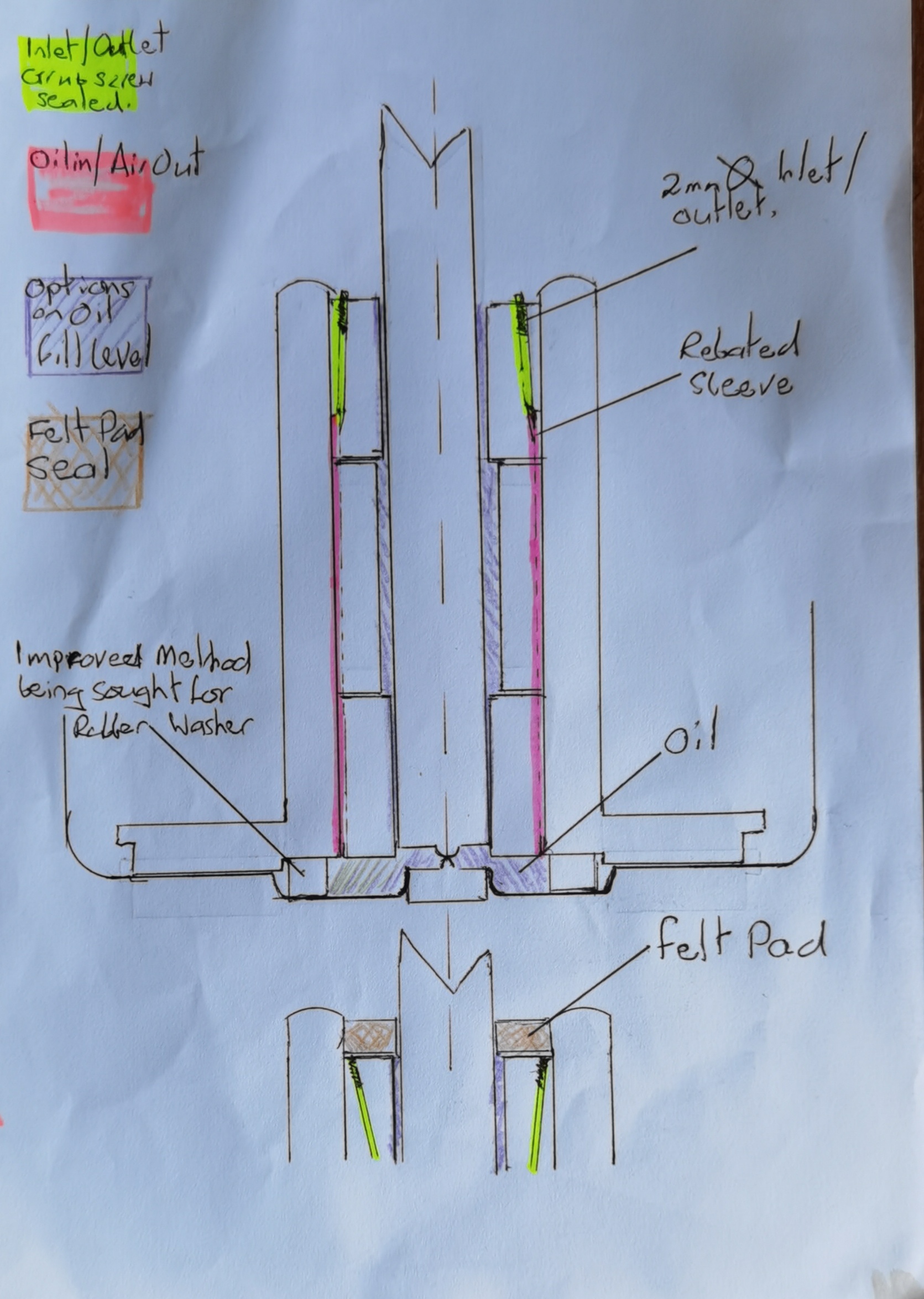

The attachment is an update to a Rough Sketch Drawing I put on paper in the earliest days of my investigations into the TTS 8000 Bearing.
It is not perfect in any ways but shows the general ideas I had on Paper.
The Update is that I am trying to look at the design today to keep as close to the Original as possible and not need to exchange the original parts.
With Jamie's work now being carried out on the preparations to produce a design for making the Bearing Assembly a more rigid assembly and create a method that can reduce flexion of the assembly, as well as actively looking into a method to replace the Square Walled Washer.
I thought I would add the additional design considerations that I had on paper for the internal the bearing housing, that was to be used with the the Torlon Bushes.
The attached image shows two methods the bottom partial detail is showing a recent idea I considered where an added felt pad to cap of the top of the Bearing Housing is incorporated to create a Barrier to Oil.
To prepare for the use of a felt cap, it is to be assumed the Original White Plastic Bush will need a reduction in length, to accommodate creating the recess to seat the felt pad in.
In general the main detail is showing the Top Bush which has 5mm Thick wall has a 2mm Diameter Hole that can receive a Grub Screw to seal it.
There are Two Holes produced on the opposite sides of the Bush.
One is to inject a Lubrication and the other as suggested by the Engineer is to enable air to escape as the Lubrication Levels are worked with.
The Outer wall of the Original White Sleeve and the Lowest set Torlon Sleeve will have a small rebate produced on the entire length of the Wall.
When assembling the Bushes within the bearing housing the Rebates on each bush and the Top Bush Hole will need to be aligned to create a unobstructed channel to enable the Lubricant to travel to the base of the Spindle and collect within the Pressed Metal Bowls base.
I would say a 10Ml Syringe with a 1mm Hyperdermic Needle can be used to add or extract the Oil.
The incremental Ml's of Oil being added can be recorded to see where the maximum impact is to be discovered.
Keeping in mind a Hydrodynamic Lubrication is the goal to be maintained at the Spindle /Bush Interface.
If there is any of the contributors thoughts that are leaning toward filling the entire depth of the bearing housing, I added the Felt Pad Cap as an additional option to act as a Barrier to help with containing the Level of Oil Selected.
