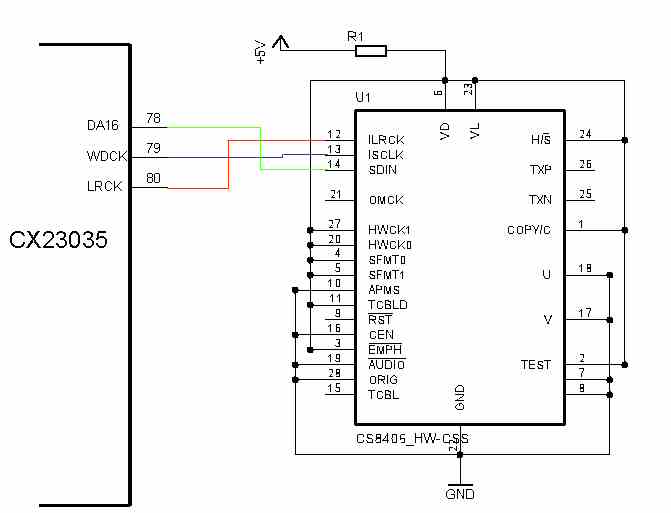

ingab said:I want to use the CS8405 (or CS8406) chip in this way (see the attachment).
Is it correct?
Tahnks
Andrea
Hard to tell. The chip in the picture seems to be neither the CS8405 or the CS8406. You also have to sort out OMCK.

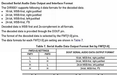

Hello
I want to connect the DIR9001 with a TDA1541A in a non-os dac.
In NOS mode, TDA1541a can only accept I2s format and when you see the data sheet of 9001, the 16bit format is only in Sony format (right just.)
So, do this Sony to Philips I2S Format Conversion circuit would work for me ?
Thank
Bye
Gaetan
