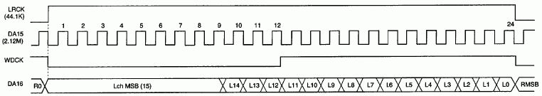

You can say that Sony CXD2500 EIAJ format is almost the same as Burr-Brown standard 16bit format-> 2s compliments MSB first?
The dac will not notice the Zeroes between 16bit and 48 or 64bit from the CXD2500?
Then is free to choose 64bit or 48bit from CXD2500?

So long as the data is LSB justified and there is at least one BCK cycle per bit it will work. When set to Standard fmt 16bit, the last 16bits before a transistion of LRCK will be converted.
You cannot use the 64Fs BCK output directly. It is LSB first.
I have looked at the 4 format.
I am very confused now why:
Many says that the output format from the sony is (forget 64bit)
48Bit 2s complement MSB first->Leftjustified
or
48bit 2s complement MSB first->Right justified
or
48bit 2S complement MSB first-> LSB justified
If you must use PCM1798 your settings could be:
16bit Standard 2s complent MSB first Leftjustified??
16bit starndard 2s complement MSB first right justified??
Please let´s clear up the formats once and for all
Kim
rfbrw said:All that matters is what is in the datasheet and the datasheet says 2's comp MSB first. The LSB occupies the last bit cell position in the frame therefore it is LSB or Right justified.
Hello rfbrw
Sorry for all my questens I think I understand it now
I overlooked page 16 and 17 in the datasheet for PCM1798 what settings connect to the CXD2500(48bit output):
16bit right justified also called LSB justified standard format, MSB first 2s complement
Yes it´s clear now
My next understanding
How can you see from the formats curves, that the differents between EIAJ and I2S. that LRCLK is delayed 7 BCLK cycles??
Best regards
Thanks for all
Kim

It is the difference between where the MSB is and where you want it to be. In the case of the CXD2500, there is a transistion of LRCK and 8 BCK cycles later the MSB appears. In the case of I2S the MSB appears after 1 BCK cycle. Delay the transition for 7 cycles and the MSB appears 1 cycle later. Invert LRCK and you have conformed with the I2S standard.
