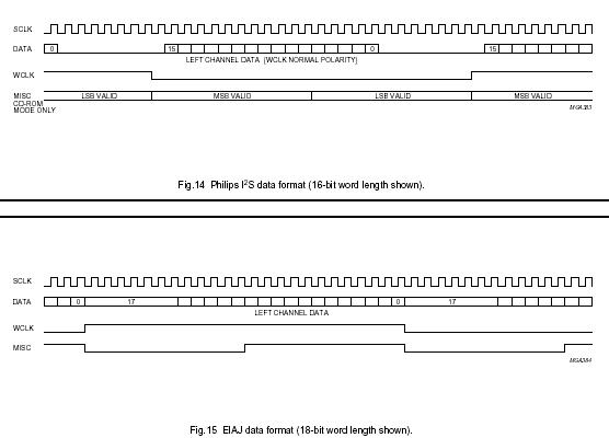

So if you look into the difference between the different format, the only difference is the timing of the data signal during the LRclock cycle. For 16 bit, if you delay the LRCLK signal of a Sony ( aka EIAJ ) signal by 7 BCK cycles, and invert it as well, you will fool the DAC into thinking it is a I2S signal. This can be done easily with a simple shift register.
To convert from I2S to Sony ( aka EIAJ ), the delay the Data of the I2S by 7 BCK cycles, and invert the LRCLK. This will foll the DAC to think that the signal is EIAJ rather than I2S.

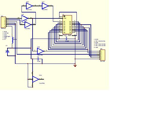

My implementation of the shift register for a EIAJ to I2S is as attached:

Why don't you use a scoket and try various types. Some people can tell the diference between different types but I cannot. To me logic is logic. I used 74F04 and 74HC04 with no problem. Actaully, I think any high speed 74xx04 will work. Similarly for the 74374. The max freq is only 2.12MHz which is easily handled by any TTL circuit.

kimschips said:Hello
Just one questen:
Where do I connect pin 2 from U2A inverter in the attached schematic??

What is to be gained by this conversion? The CXD2500 will connnect to the PCM1798 without it.
Hello
As CXD2500 spit out EIAJ format-> PCM1798 can only accept I2S, Leftjustified or standard 16 or 24 bit format.
What if using DF1704 instead off EIAJ to I2S converter
Am I being confused here?
Kim
