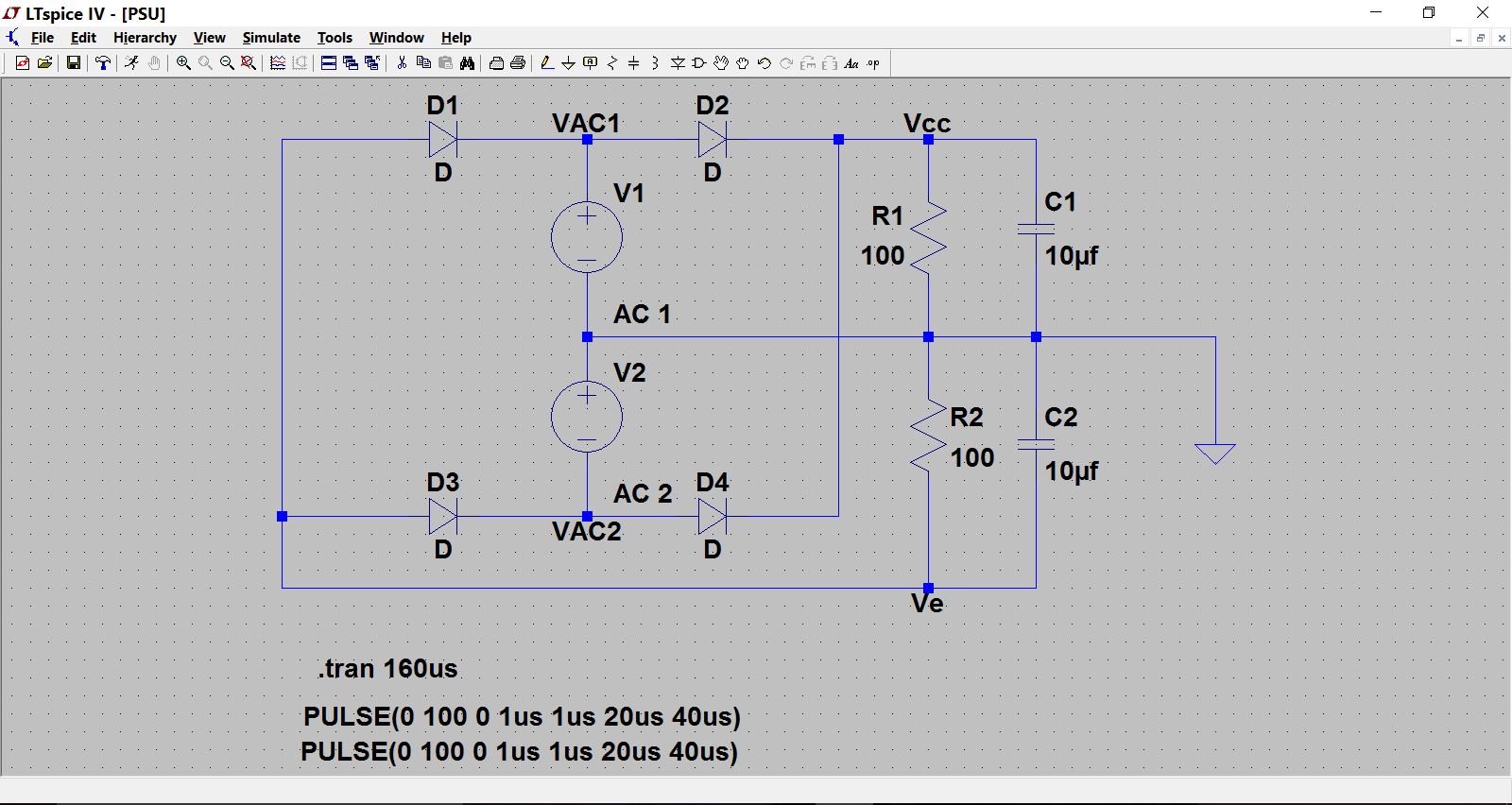

A squarewave of approximately 50:50 duty cycle fed to a bridge rectifier has to produce a DC voltage equal to the peak of the AC. Its got to 🙂

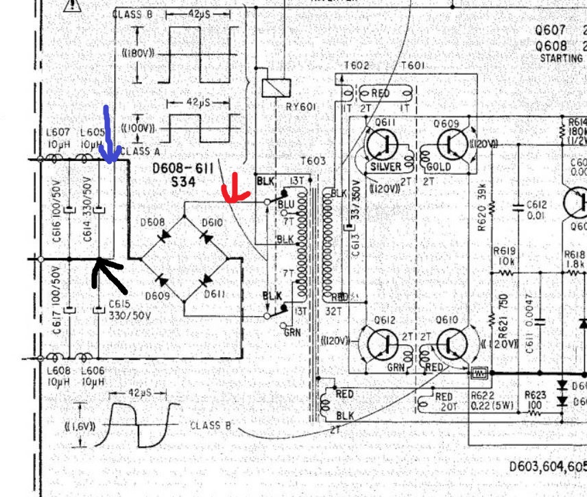

So with the probe ground where the black arrow is, Ch1 where the red arrow is and Ch2 where the blue arrow is you are saying you have lost 50 volts or so across the diode ?

yep, and numbers on schematic say the same: 180V amplitude with +/-45V rectified output. Magic.
The chokes won't make that much difference. Your still not going to lose more than around 0.7 volts across those diodes (not in a forward direction). If the peak of the squarewave applied to the bridge is 100 volts then you must see 100 on the bridge output.

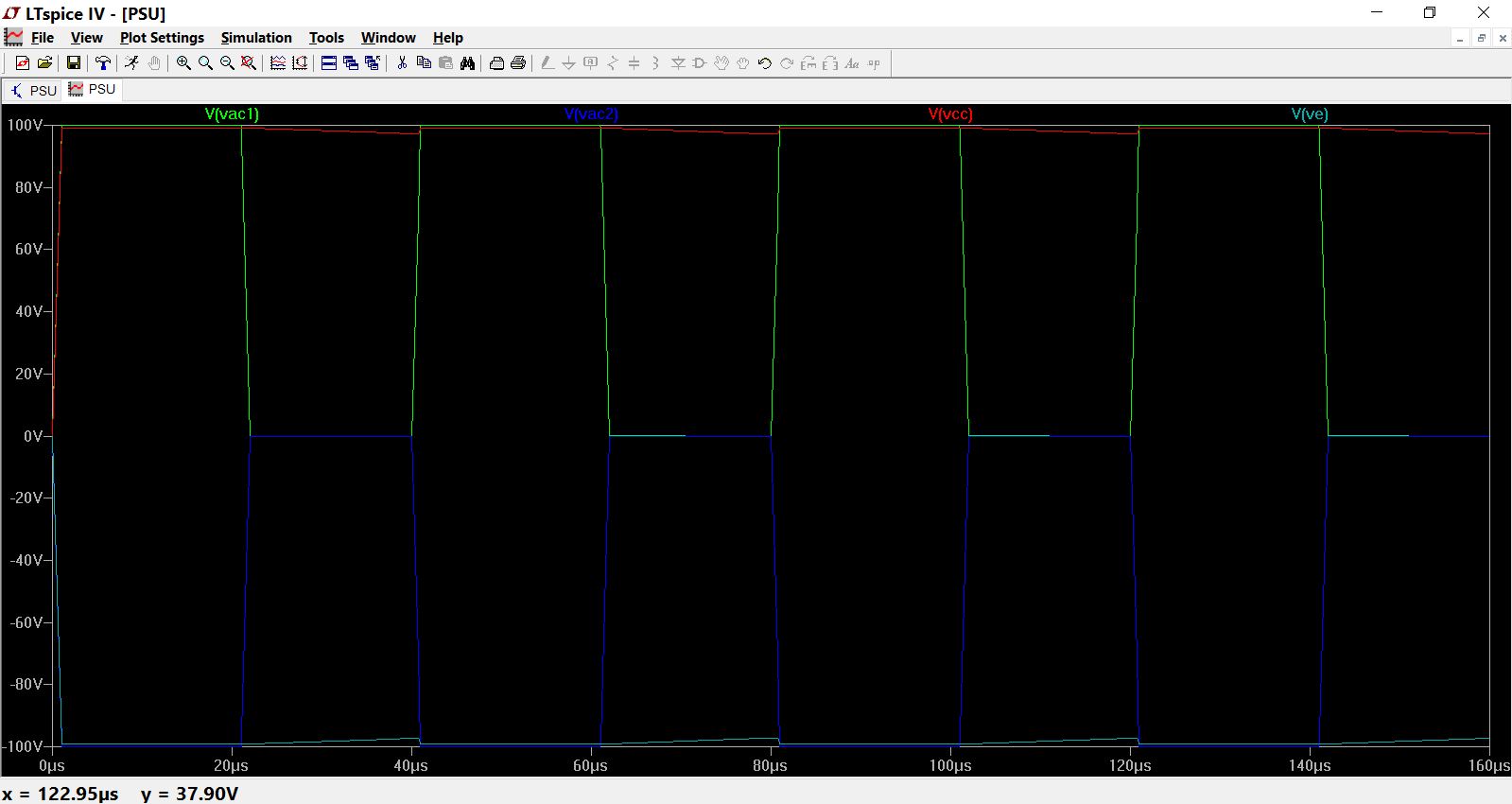

It even simulates correctly. The output voltage on each rail equals the applied peak of the squarewave. Something is amiss with either the measurement or the interpretation of them. VAC1 goes up by 100 volts (from ground) and VAC2 goes down by 100 volts from ground. That gives a -/+100 volt rail as expected. I've made the cap small so you can see the ripple.

The manual agrees with your measurement... yes... but that still doesn't make sense. It shows a 100 volt peak to peak (there is a centre line running through both illustrations) which suggests it swings 50 volts above and 50 below ground. That would give a -/+50 volt rail.
The 180 part makes no sense at all. That would give -/+90 volt rails.
Look at just D608 and D609. When the anode of each goes to whatever the peak voltage of the secondary is, the cathode must follow. That voltage becomes the positive rail. If it doesn't then voltage is lost across the diode. The negative rail works in the same way but with reversed polarity of the AC waveform and diodes.
