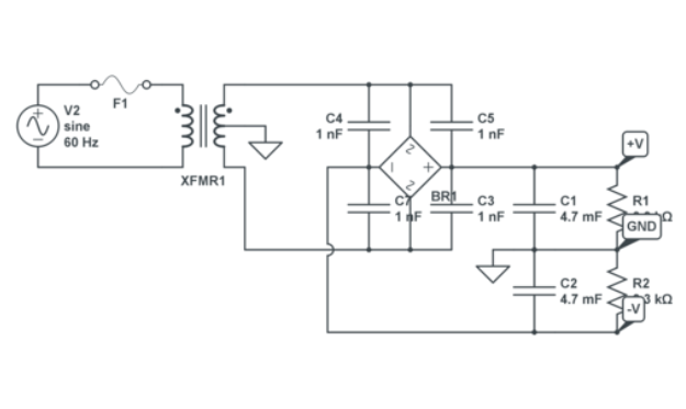

A typical power supply would be like this. The four small caps are optional and are "snubbers" to prevent commutation noise from the rectifiers as they come in and out of conduction. The resistors aren't needed... your amp is the load.
The transformer would need to be no higher than 35-0-35 vac which would give around -/+50 volts DC when rectified and smoothed.
