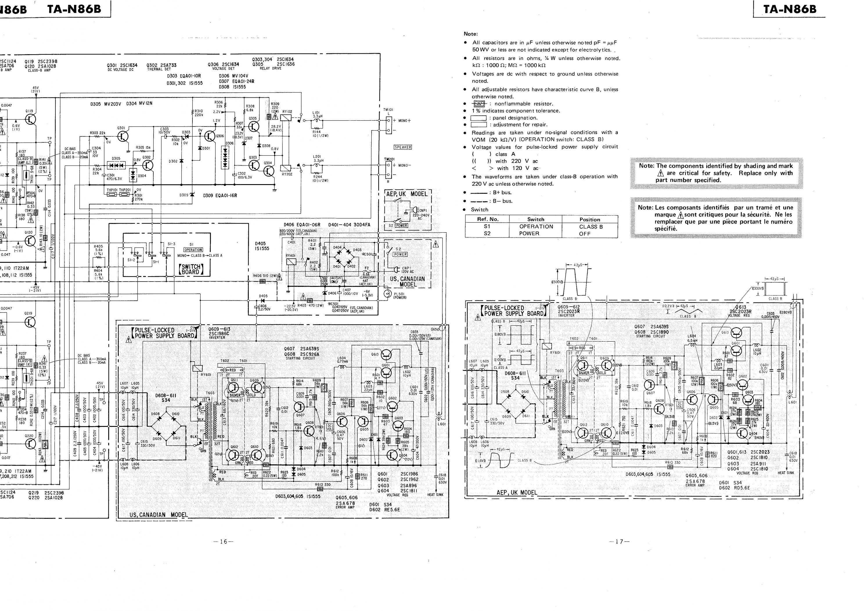

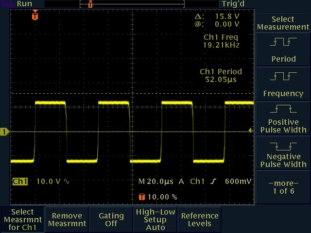

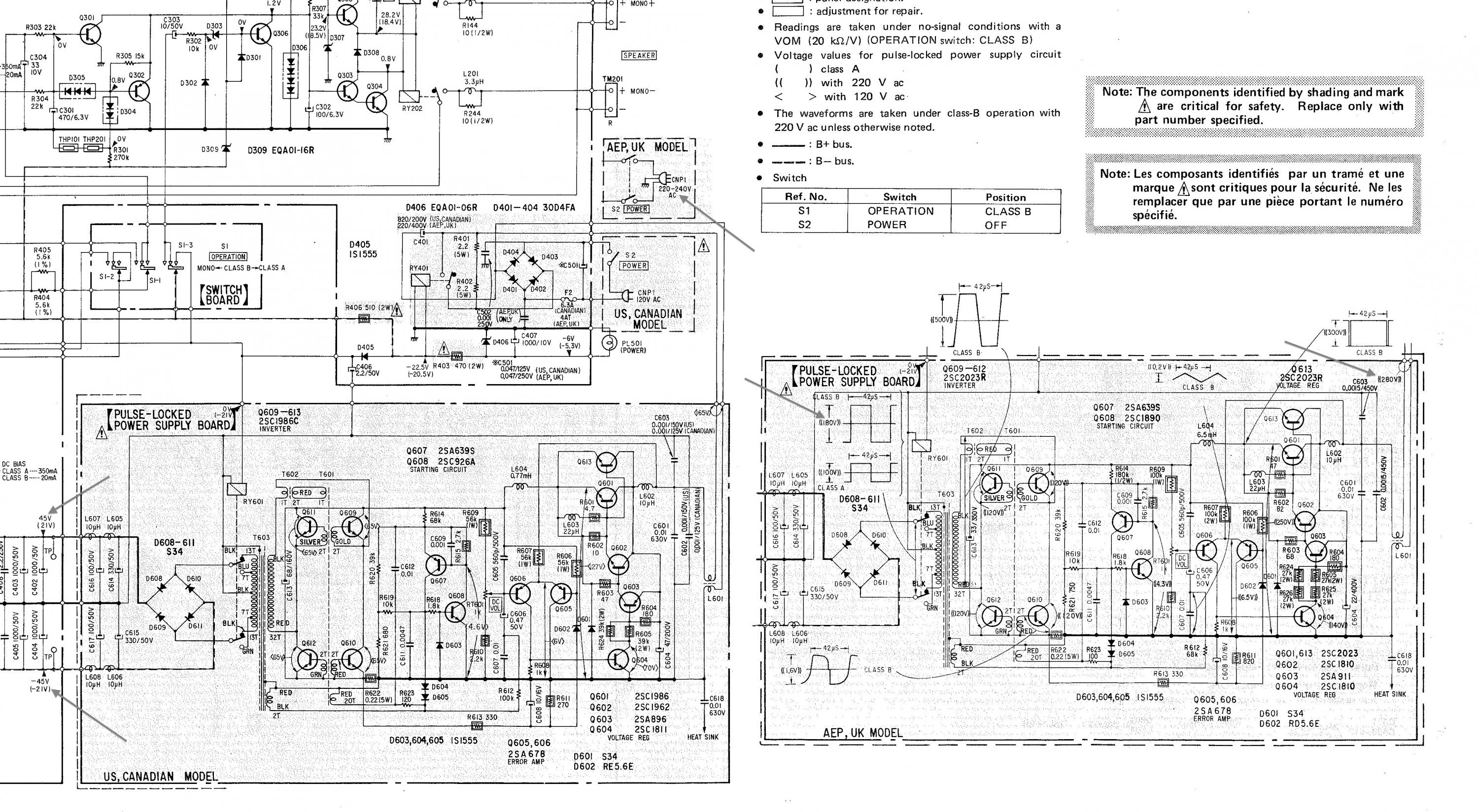

I did the scoping on secondary winding, got ideal square wave with 52us period (circa 19kHz) and about 170V amplitude. Seems it's pretty close to the numbers on the scheme = 180V amplitude and 42us period. But how they get +/-45 after rectification and caps from square wave 180V? Total misunderstanding... Attaching portion of scheme and the scope dump.
The numbers in the manual don't add up at face value. A 50 or 90 volt peak input to the bridge has to generate 50 or 90 volts DC across each reservoir cap.
What DC voltage have you got ?
And that's what basic theory would suggest. I can't make sense of the numbers in the manual.

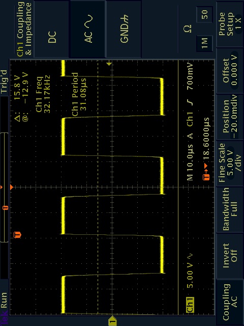

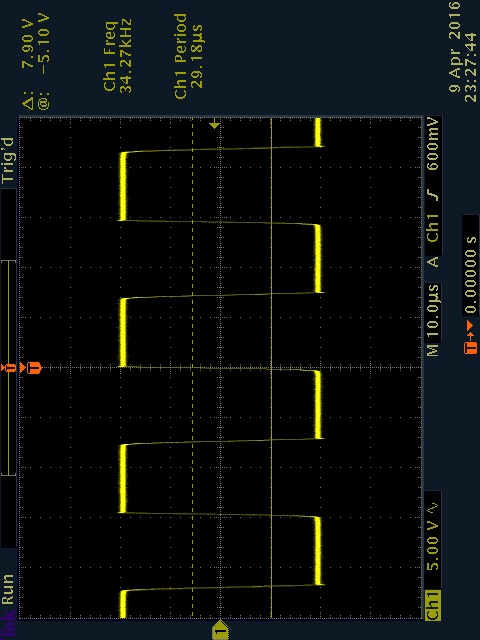

Well, just checked 110v unit. Secondary winding amplitude is almost the same - about 180V, that's true with schematic. But look at the frequency - it's almost 33kHz giving just 30us period. Higher frequency - higher voltage drop after rectification?
Does this 110v unit give the correct DC rail voltages ?
If there were a drop in the rectified output because of the frequency going up then the 'lost voltage' has to go somewhere. If it were across the diodes then they would fry at the currents involved.
yes, it does produce absolutely correct DC rails voltage. I wouldn't assume such drop is possible over diodes - seems it's normal silicon diodes with maximum 0.7v drop. Maybe its not "ideal" square wave giving lower effective voltage... but the scope is pretty fine.
