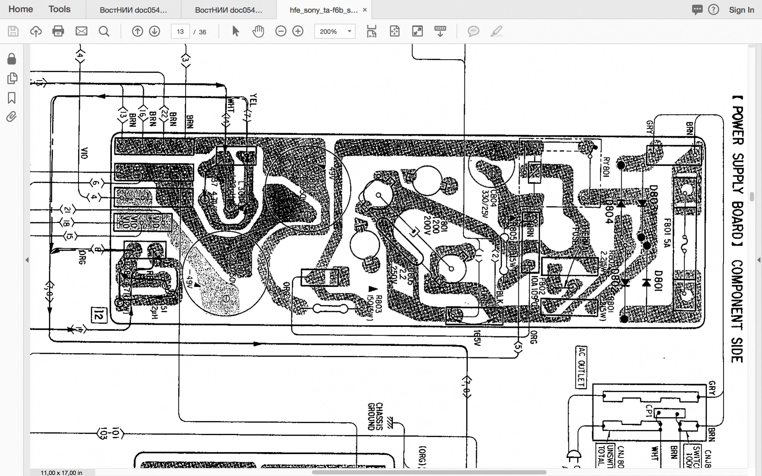

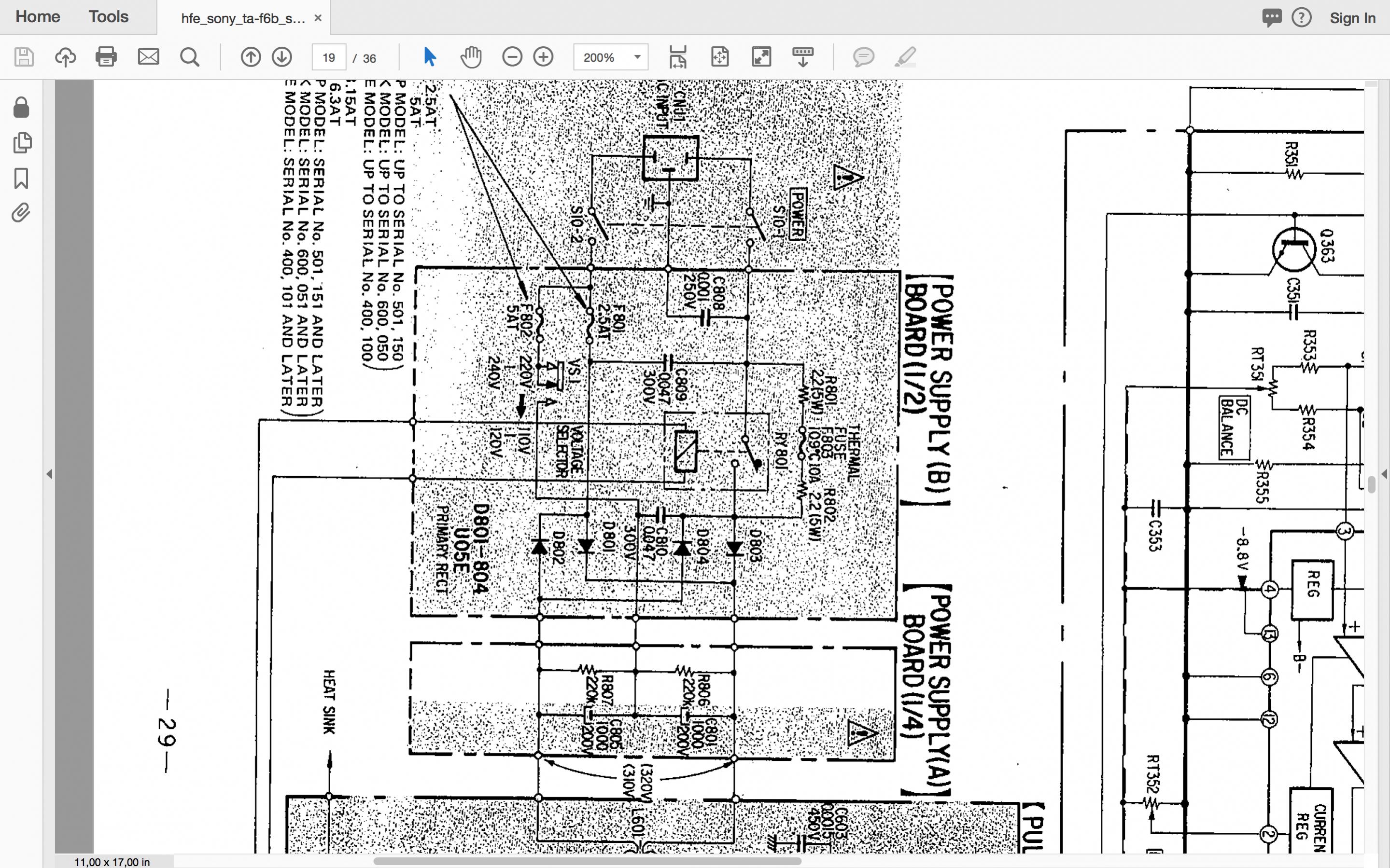

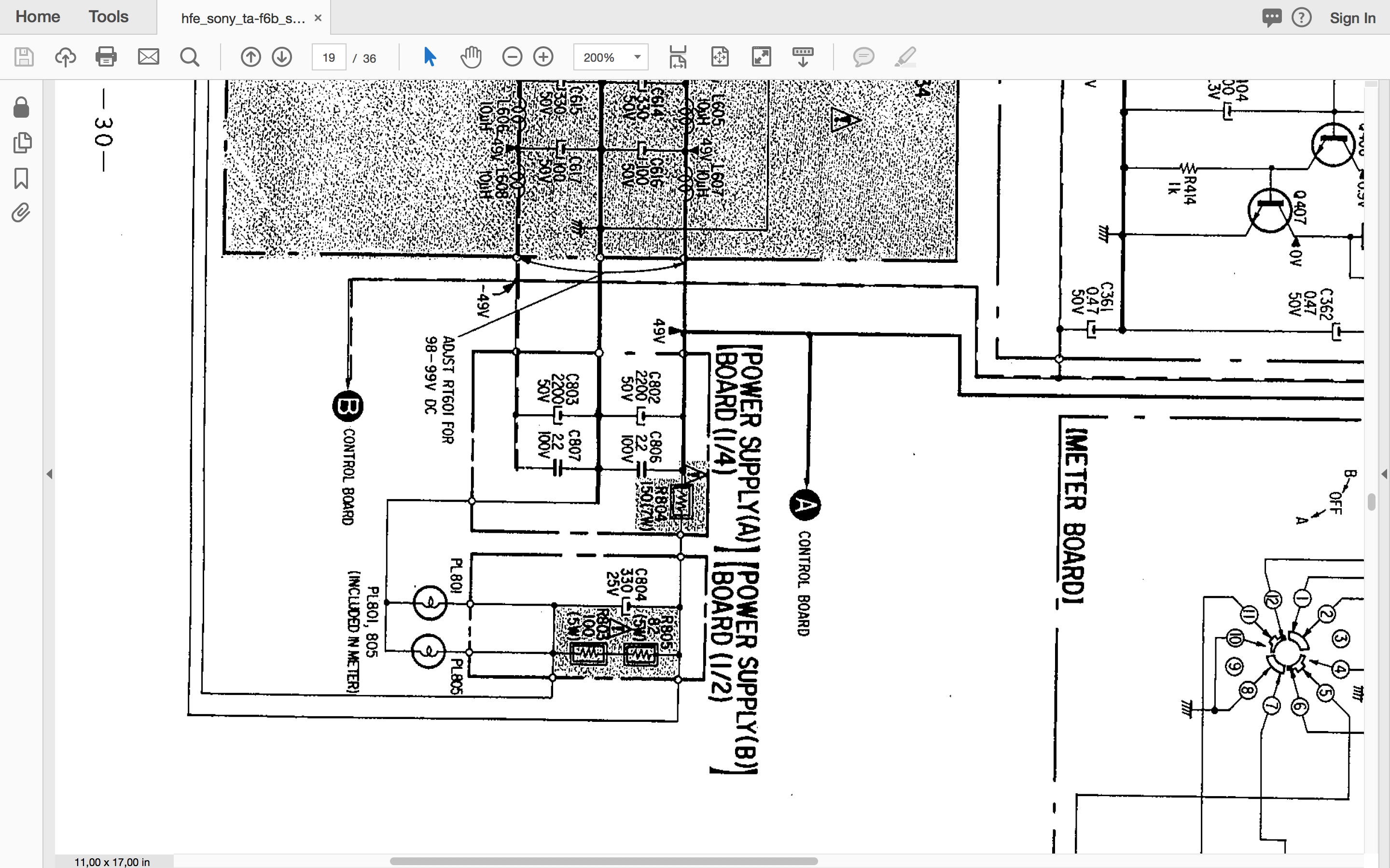

All, Hi. Installed the transistors that are listed as analogs, but the power supply o
All, Hi. Installed the transistors that are listed as analogs, but the power supply outputs 124 volts and does not reduce to the required 98 and 99 volts and RT601 is not regulated. What could be the problem?
