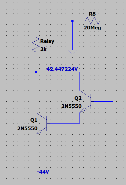

It's an interesting issue and as we haven't really nailed it yet (and I'm hoping those diodes/caps might just... you know) then we have to build that part of the circuit up in stages and check it behaves correctly each step of the way.
This is the configuration, just the supply, the transistors and a really high value resistor as a bias source.
There is so much current gain from a Darlington pair (the individual gains of each transistor multiplied together) that even a 20 meg (in the simulation) provides enough current to fully turn the relay driver on.
That's just 2uA base current in that resistor.

I did as you advised and the relay opened (dabbed a 470k between base of Q405 and ground).

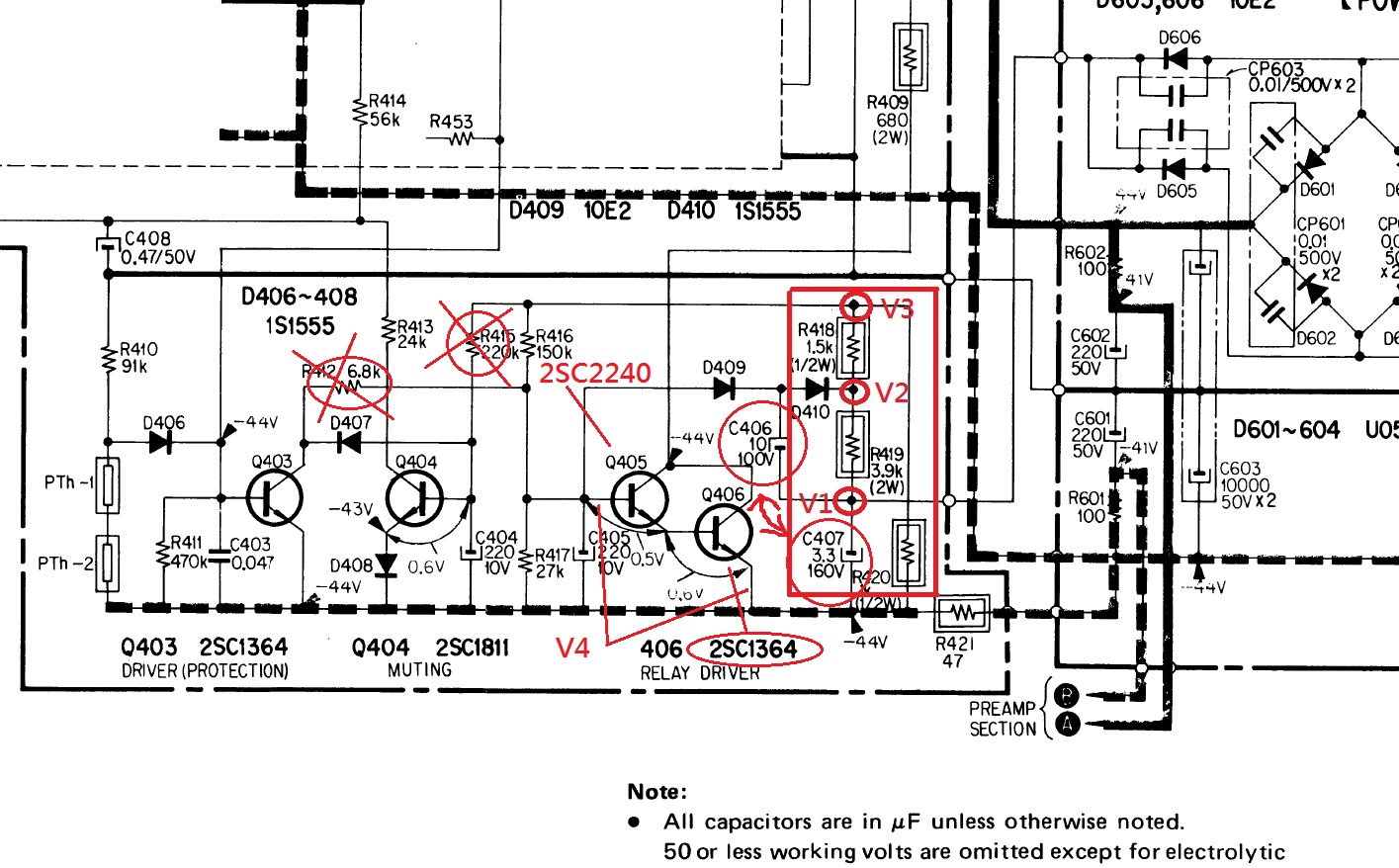

The voltages are:
V1: 23.4 V
V2: -16.36 V
V3: -32,20 V
V1 supply from the transformer (should have 30V AC) with 2 diodes full wave rectifier so that 23.4V voltage is a little bit low, but V2, V3 seems normal.
I suspect cap C407 not right, I suggest try this, remove R412, R415 first to isolate the relay drive circuit alone, exchange C407 with C406 temporarily for testing, for the transistor 2sc2240 as Q405 and 2sc1364 as Q406, please also measure the V4 voltage.
I measured the voltages around Q406 and Q405 yesterday, as in post #83. Sony TA-3650 power rail resistors burn
so V4 should be 1.6V (with the 47k across the 150k at position R416.

My voltages around the transistors are:
Q405
E -41
C 0
B -42,6 (-44,9 without the 47k across the 150k)
According to your Q405 voltage reading, in normal(no 47K connected) the base at -44.9V, so that it is same as the negative supply rail voltage and the Q405(Q406) will not turn on.
If the caps are new then you just remove R412 and R415 and do not connect the extra 47K to 150K and power on the amp to check the result.
Please measure the voltage V4 according to the diagram "not measure between the ground".

Do you remove R415 when test
NO.
the negative supply voltage I measure is -42V. (It's a bit lower than in the schematics).
so if I don't tag the 47k across R416 the base of Q405 gets a higher negative voltage than the supply V is (actually 2,9V higher).
so maybe here is a track here?
