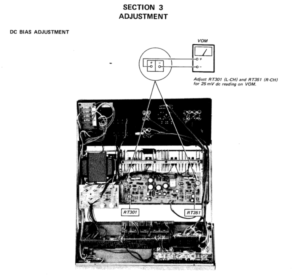

I am back, and I managed to finally dial in the bias of my SONY TA-3650 amp. Hooray! And again huge gratitude to Mooly. You steered me through this and made it a great learning experience. I have much more confidence now to tackle the next machine waiting on the top of the pile (a Sansui TR-707 receiver).
I needed to find the right ratio between R1 and R2, the two parts of the resistor in both sides of the wiper in the new preset on the rubber diode. Then I could set the bias with the "old" presets RT301/351. Those are pretty coarse, the bias shoots up at one point. It really helps to have the rubber diode presets. thanks, Mooly, for insisting to use a pot here. Probably it would be safest now to change RT301/351 to a fixed value.

Thanks for all the kind words 🙂 and I'm pleased it has all come good in the end. I seem to remember thinking (without re-reading it all) that the 'rubber diode' would be pretty device critical and that making it adjustable would be best.
