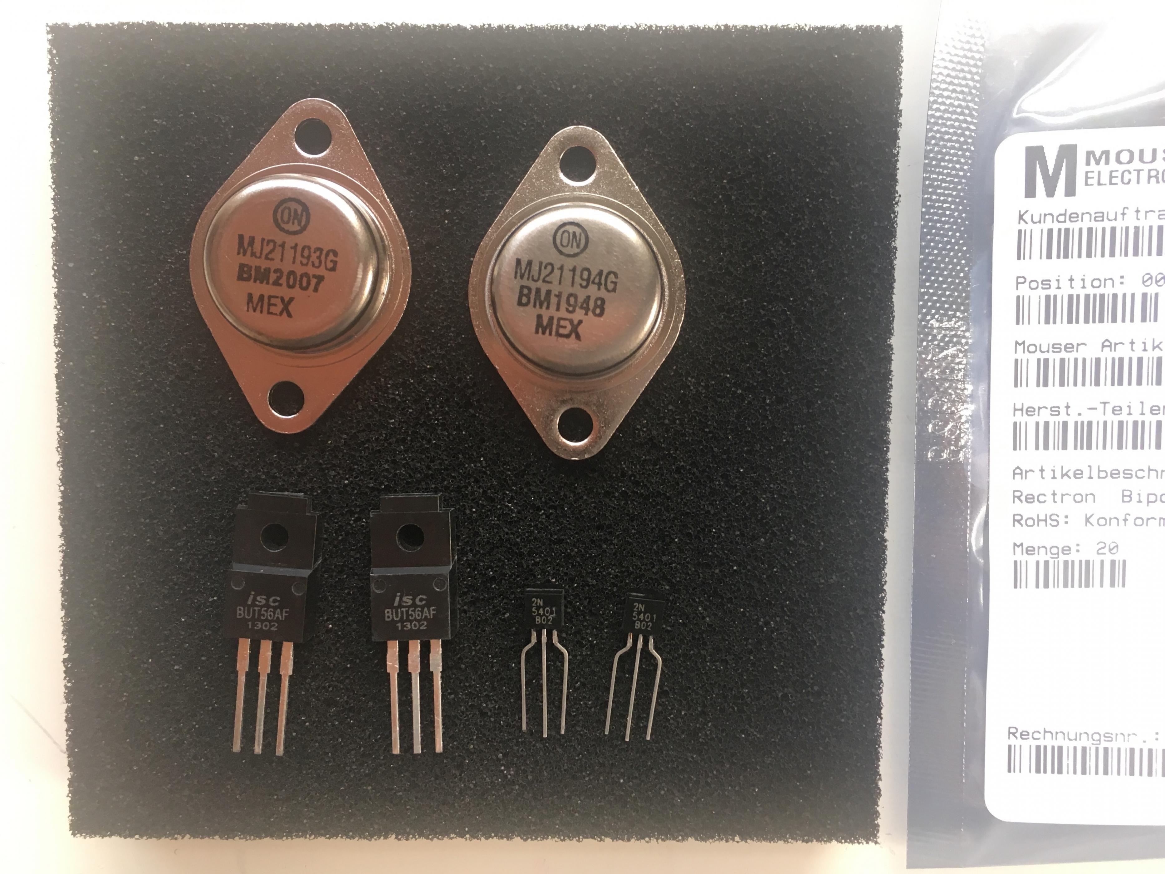

I'll also replace the output devices of the repaired channel with MJ21194 and MJ21193 respectively.

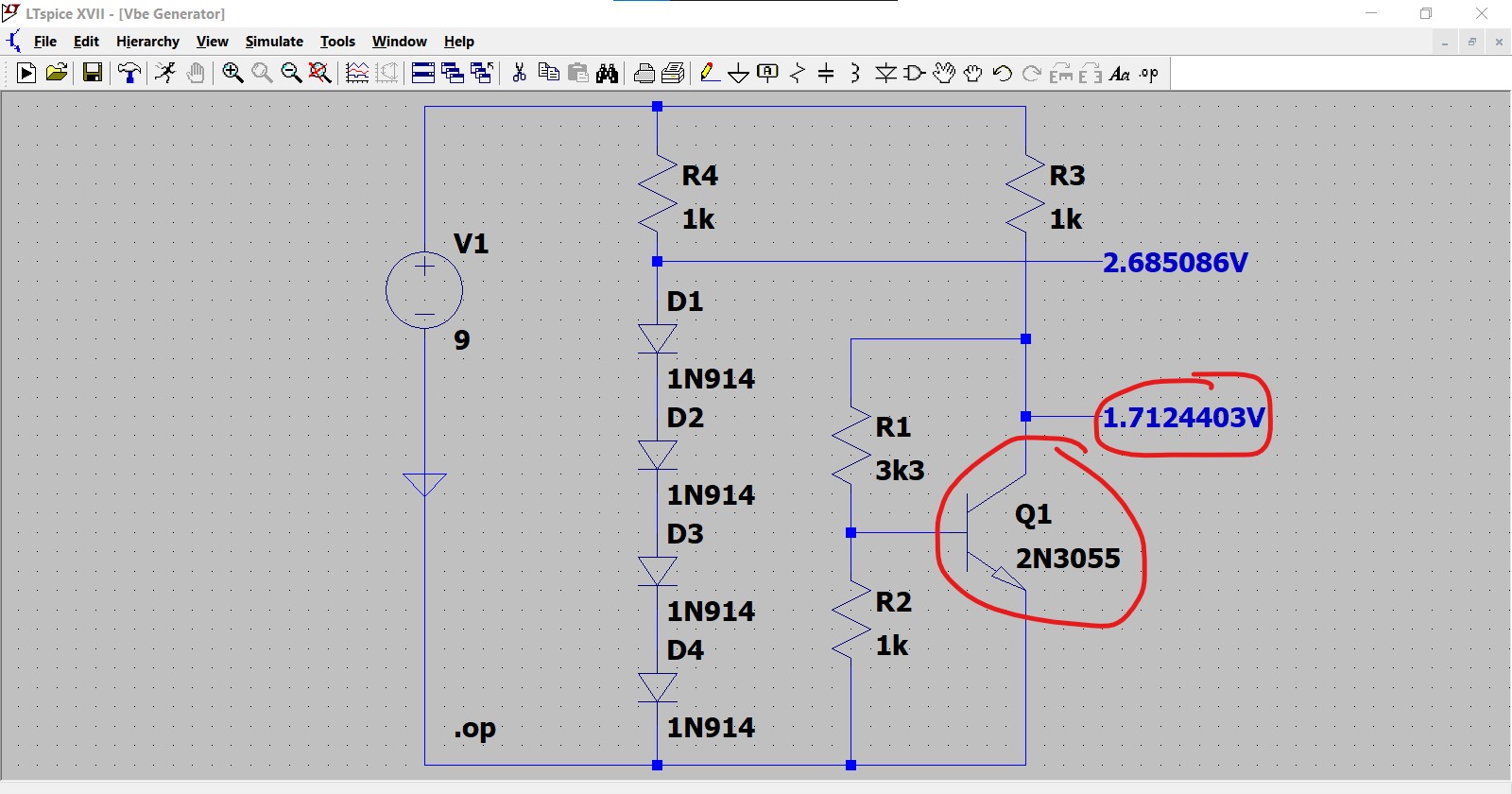

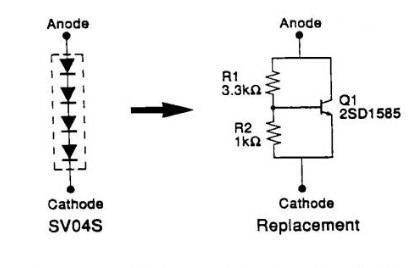

But first I'll construct the "rubber diodes" according to the SONY service bulletin (it is in this thread: Was kann ich verwenden, um eine SV-04F-Vorspannungsdiode zu ersetzen? - Antworten Hier).
The SONY bulletin gives 2SD1585 as the transistor I should use (plastic casing). I could only find a BUT56AF, but assume the specs will be fine. I'll construct a tiny PCB as per the service bulletin.
Can I test my contraption (the "rubber diode") once it is finished with the diode test function of my DMM as if it were a true diode?

The transistor mod (rubber diode) can not be tested on a meter. You have to be 100% certain you build it correctly and that you set the preset in the position to give minimum bias before you power up.
The BUT device is primarily a switching transistor for SMPS and I have doubts over its suitability tbh because I think it will have very low gain at low currents. Try it though but use the bulb tester for safety.
You could test the 'contraption' with a 9 volt battery and series resistor to limit current. You would measure the voltage across the transistor as you vary the preset. It should go from close to zero to at least 3 volts. You would need something like a 1k series resistor.
Hi Mooly, good to have you around again! And thanks for replying with lightning speed.
I was happy as I had found a plastic case substitute... too bad then. I'll test.

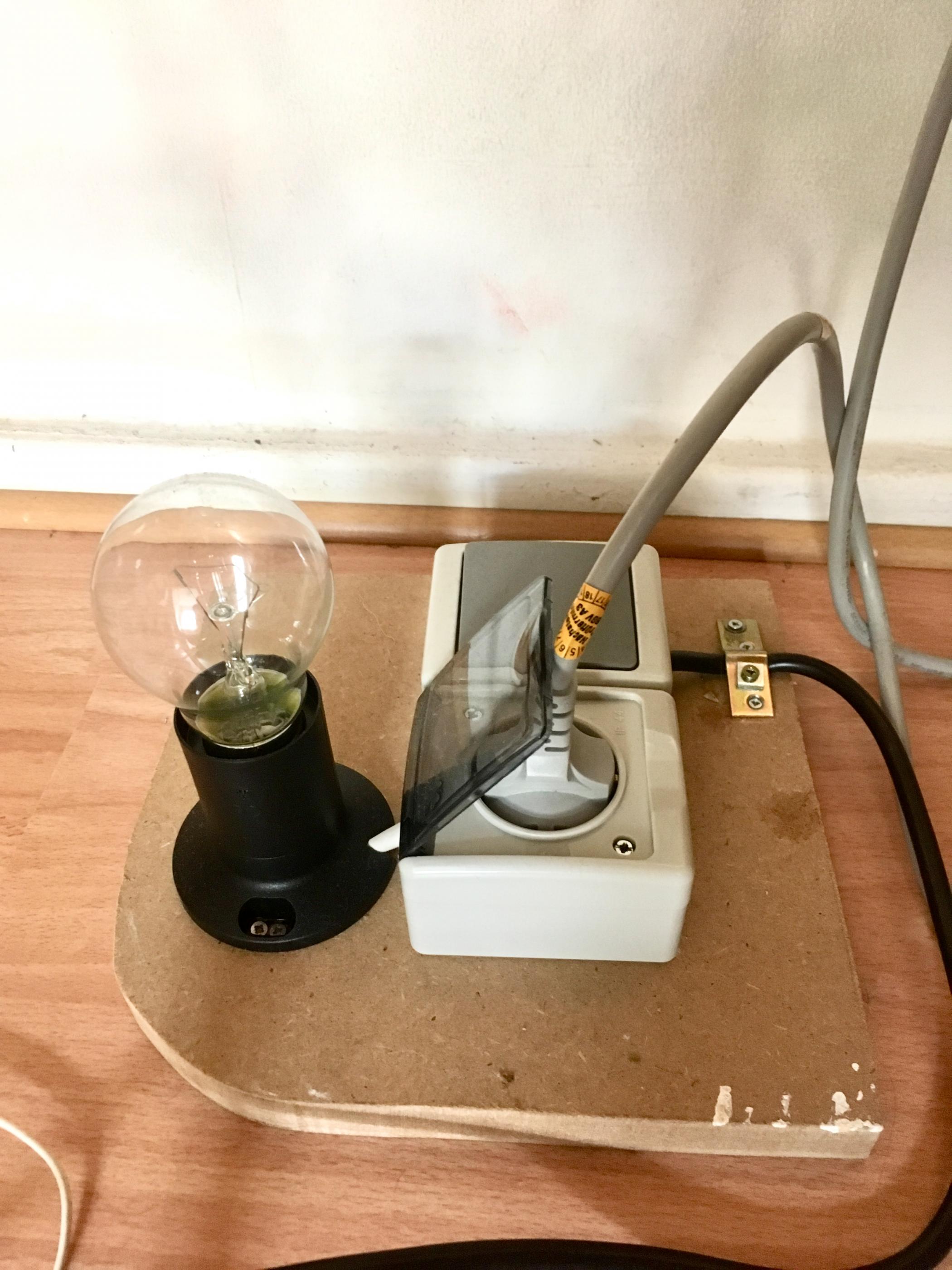

I have also built a DBT in the meantime (did I already proudly present it?) so everything will be a bit safer.

It may well be OK, you'll just have to try it for real and see 🙂
You might have mentioned the DBT but its a zillion posts back in time for me 😉

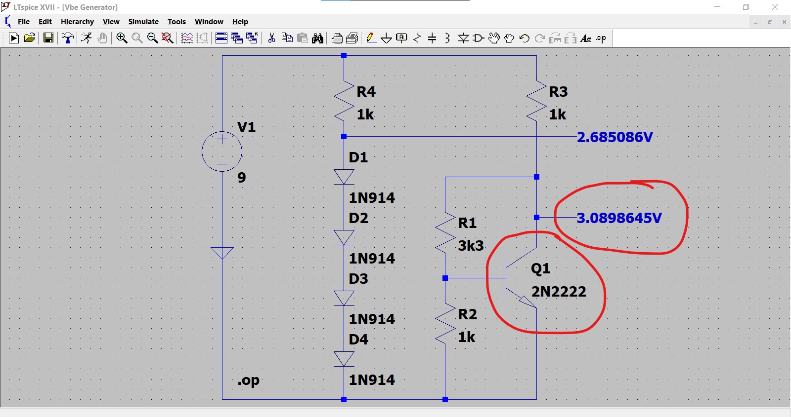

Before you make a board just tag the preset onto the transistor and test it with the series resistor. It only takes two minutes.
I've just found the link you posted... no preset. Try it and see what voltage you get across the transistor (with a 1k series resistor and 9 volts).

So... I think this transistor mod will be device critical if you use fixed resistors. Much better if you make the lower resistor a preset and then the bias can be set precisely. Something like a 2k2 preset.

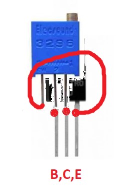

I have only 5K presets at the moment. Will they suffice (be sensitive enough)? They are those blue multi turn ones.
And how do I connect them? They have three pins. The existing bias pots in the amp are only connected with two pins to the circuit; normally all three are used. Bad source of errors for someone like me.

Or could I just tag the transistor to the three pins of the preset? Then 5K would seem to be just right.
Well you have two choices, and yes 5k should be workable.
Choice 1 is just to replace the lower 1k with the preset. You use the middle lead (wiper) and either of the other end leads. Leave the other lead free.
Which end lead you use determines which way the control operates and it really doesn't matter as long as you know which way it operates and set the preset correctly initially.
You need it set to give 5k resistance as that will give minimum bias.
Choice 2 is the economy version and is often used. You wire the middle lead (wiper) to the base and the other leads go to collector and emitter.
Disadvantage of choice 2 is that if the wiper of the preset were to go open circuit then the bias would shoot to maximum and probably destroy the output stage. Is that likely... not really with a new multiturn pot.
Choice 2 lends itself to constructing without a PCB.
Something like that 🙂 Yes 😀
