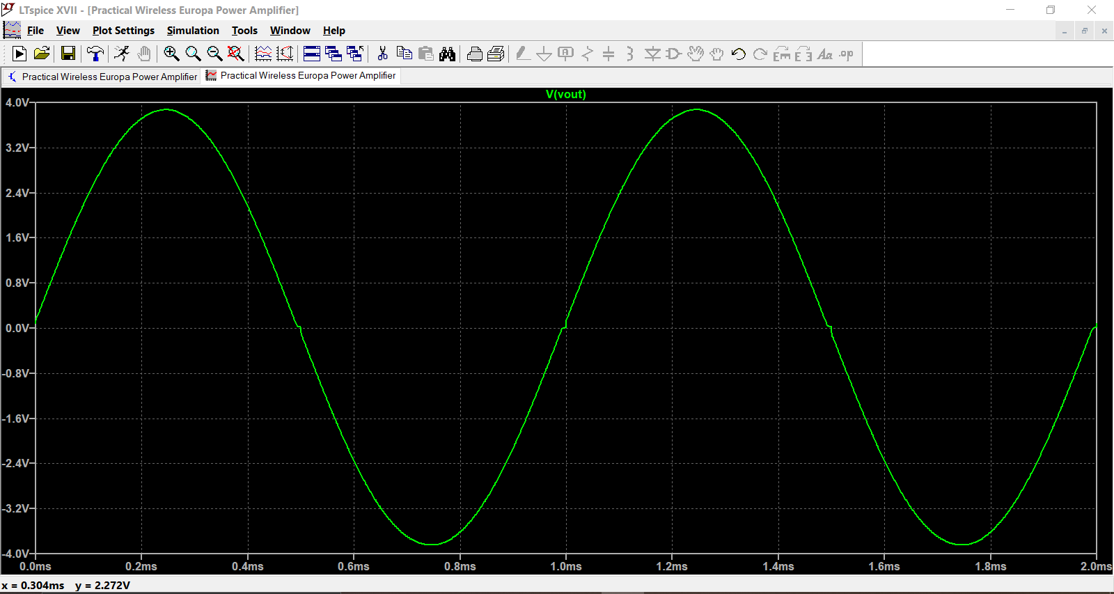

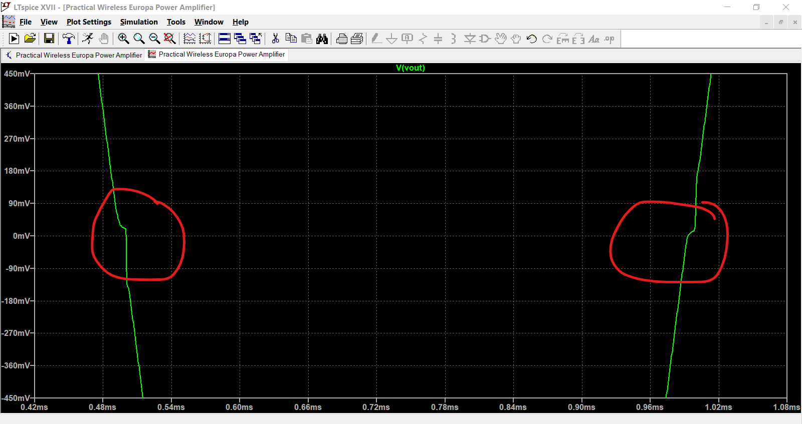

This is what no bias looks like at the output of a typical amp. Look at the zero crossing point.
And zoomed in.
That level of distortion would be very very audible on a sine wave and give what should be a pure tone a harsh character.
And zoomed in.
No bias will cause possibly faintly audible distortion at low levels. A pure (it must be pure to tell) sine wave of 1khz or higher is good test.

The crossover distortion would probably only be visible on the scope if you had a load attached. The really high gain of the amp (overall open loop gain) tends to mask it.
It occurs because of the 'dead band' of non biased output pairs, they don't conduct until there is that magic 0.6v across the B-E junction to turn them on. So tiny signals (around the zero of crossover point) are effectively not seen.

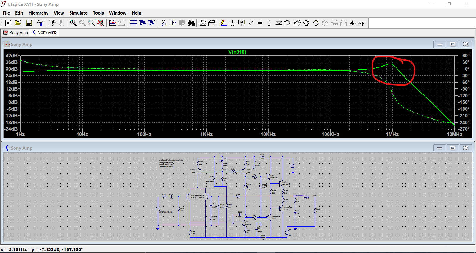

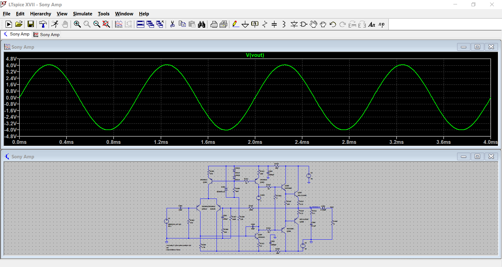

I've just put your Sony into a simulation which is quite interesting to see how it behaves.. The response is a bit peaky at the top end (way way above audio range) and that could be down to modern transistor characteristics. The original output devices were probably quite slow.
It's interesting though.
You can see the low level crossover distortion at no bias. Its small as mentioned earlier because the open loop gain of the amp is so high that there is lots of active 'correction ability' available.
