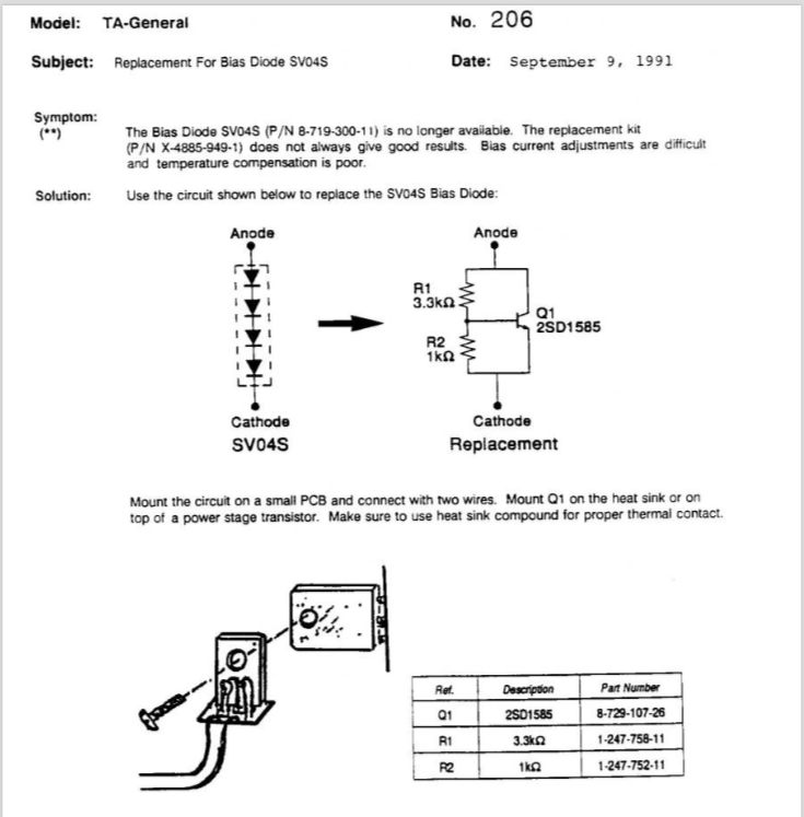

I took some measurements now.
1/ Measure the DC voltage at the junction of the 0.22 ohm resistors: 0,3mV
2/ Measure the voltage across that diode as the preset is varied. You should get at least 2.4 volts: 0 volts. I checked the diode with the diode setting on my multimeter and it reads OL in both directions (I removed one lead from the circuit). the last time when I measured it in the course of these works, it did ok. but it might have get hit afterwards. I had even soldered 4 diodes in series in order to simulate the 4x diode drop. I could put this in and measure then. I wait for your go on that.
SONY has a service amendment as to how to substitute that diode. I had already searched it, asking myself if it was the culprit. see attachment.

I would definitely replace the bias diodes with the transistor arrangement anyway. A BD139 should work well in place of the 2SD1585. You can make R2 adjustable to precisely control the bias
