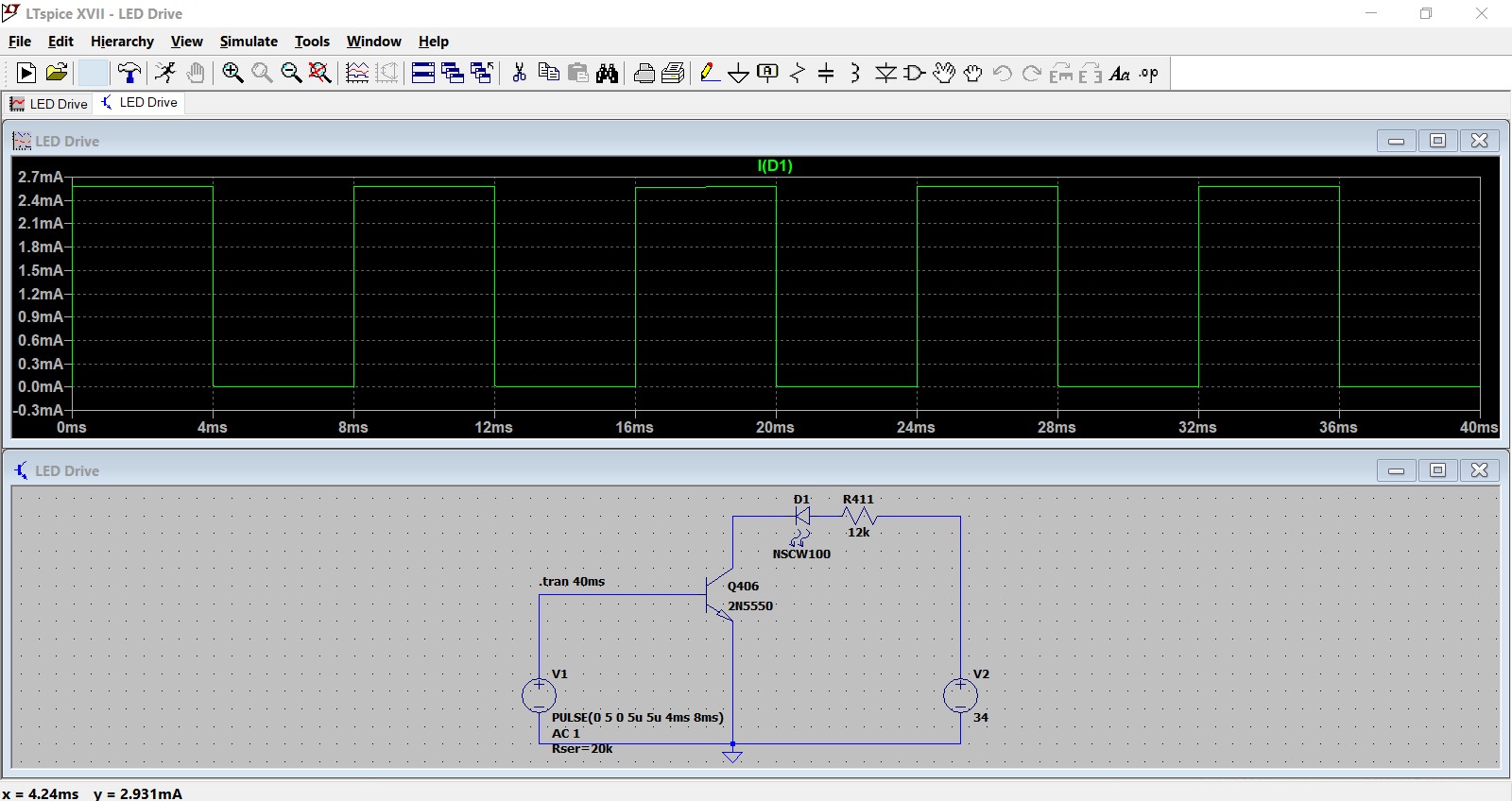

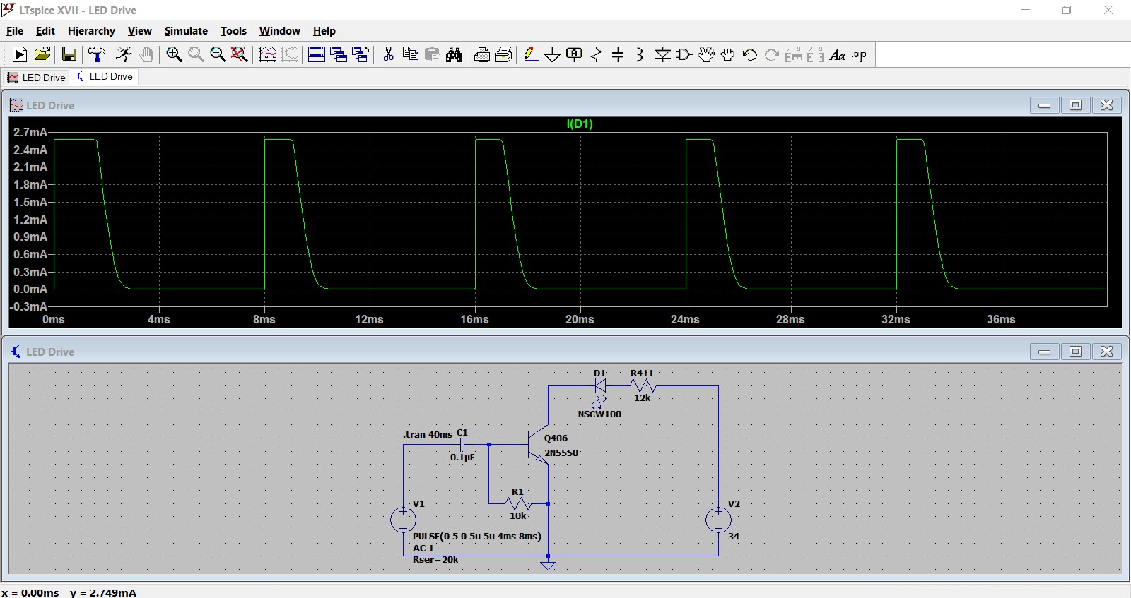

This shows the standard circuit running on 34 volts and also the addition of a cap and resistor to give more of a short duration pulse. Resistor can be varied to suit. Its all matter of seeing what gives the most pleasing visual impact and strobe clarity. Alter the 12k to alter the brightness. The trace is showing the LED current.

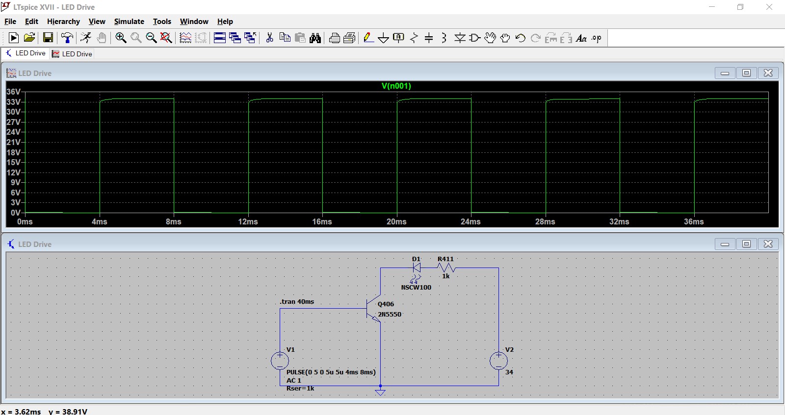

The important thing with the collector waveform is that it bottoms out at zero volts. That means the full 34 volts is available to the LED + resistor. When off the collector should rise to virtually the supply voltage.
