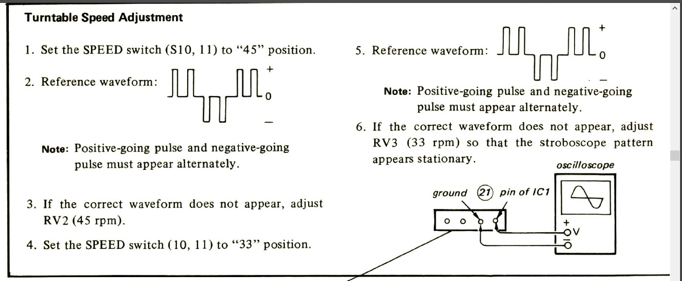

When I try to carry out the alignment, I get a 32mV peak-to-peak sine wave on pin 21. Adjusting RV2 and RV3 has no effect on the waveform.
OK, so nothing doing there as the trimmers are altered 🙁
