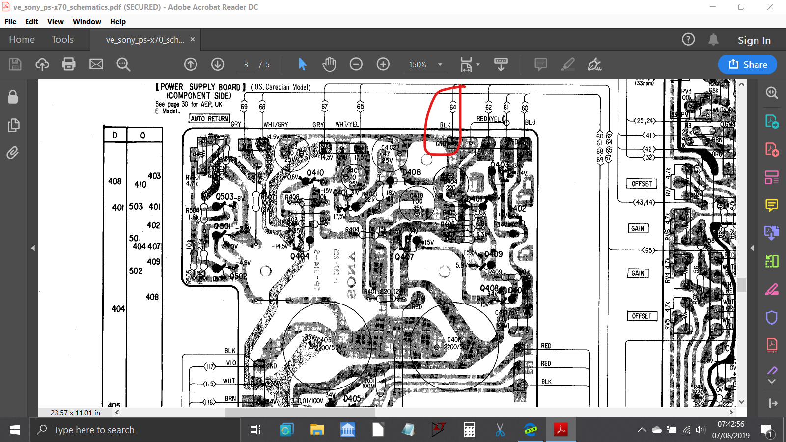

Something odd occurred. I was measuring the voltages at the output pins (115, 116, 107 on page 24 of the service manual), when I slipped with my probe and shorted 115 to the ground pin 117, followed by the spark and immediate self-flagellation. 😱
Haven't done that in a while! Anyway, when I then rechecked the voltages, they're higher than they were prior:
Pin 116 was 28V and is now 31.5V
Pin 115 was 31V and is now 32.2V
Pin 107 has consistently been 14.4V
The voltages at the other output pins on the board are correct, except for pin 64, which is 13.4V instead of 17.5V.

Pin 107 is stabilised and so it would be expected to be constant, pins 116 and 115 are unstabilised and so depend totally on the incoming mains voltage.
Pin 64 I can't make out as the board layout seems to show it as ground and the print layout is ground.

Re pin 64, I mistyped. It should have been pin 65.

Haven't got the diagram on this PC so will have to look later at what feed pin 65.

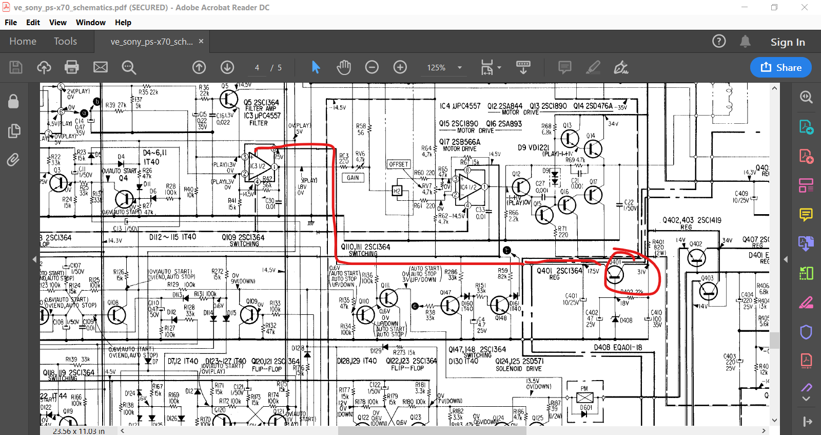

Pin 65 (17.5V) is an odd one. It is regulated (from the emitter of Q401) and it appears to supply just one opamp.

Looking at the circuit and they are just series pass regulators so nothing high tech at all.
Q401, as far as I can see it only supplies an opamp... and only just spotted this by zooming in but the collector (input) has an 820 ohm series feed resistance. So I can't see there being any issue there. The circuit shows just 3 volts over that resistor which is a current of 3.5 milliamps.
