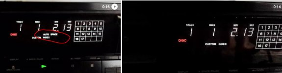

Hi Mooly, Chris, Dan,
Thanks for the replies.
I actually own two Sony 33ESD CD players, one is standard and the other is modified with lots of new upgrade parts. The two players behave differently which is why I think there is a problem.
I've prepared two short videos which show the issue better.
https://goo.gl/photos/pxQMVXbQ4X47YnzY6
Note that on one of the players (the modded one) the counter reads up as you'd expect. However, the other player (the standard one)seems to jump back 3 seconds at the start of track two and then start playing again. Also you'll notice that you hear the first drum beat of track two, then silence for 3 secs and then track two starts to play normally.
I don't think this can be normal can it?

You look to have 'Auto Space' turned on 🙂
AARGH!😱
I'll get my coat........
Thanks Mooly, that's been driving me nuts!
