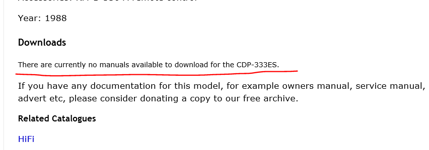

The manual is downloadable here: Sony CDP-333ES Manual - Compact Disc Player - HiFi Engine
The PLL (phase locked loop) requires a frequency counter, however there is absolutely no reason to suspect there is a problem with that unless its been altered in the past.
(HiFi engine isn't listing any manuals for this model at the moment)
Sorry Mooly, I thought I'd got the download from there, my mistake. Try this link instead:

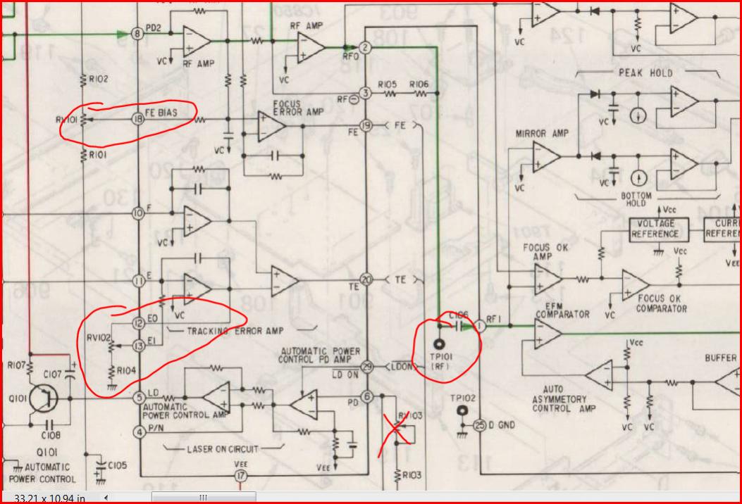

So this player uses the BU 1 pickup/pcb. You need to look at the RF on the scope at TP101 for a start. Use a low capacitance divider probe so as not to affect the signal.
The control with a cross through it is laser power so do not alter this. The focus bias should be adjusted to give the best recovered waveform at TP101 (highest amplitude, best defined diamond structure). The setting up is realy the same as I outlined in this thread for the KSS240 but don't be under any illusions... this isn't a user friendly player to work on as a first attempt.

That looks basically OK. I haven't got the manual on this PC but normally the RF level would be around 1.2 volts pk/pk or so. I'm assuming your scope is on 0.05v/div in the picture (the probe spec is fine).
The preset RV101 I circled should alter the amplitude and definition of what you see. Its a straightforward adjustment, the optimal point being the biggest and clearest pattern. If its already at that point then altering it it will only make the signal worse so you will only know by trying.

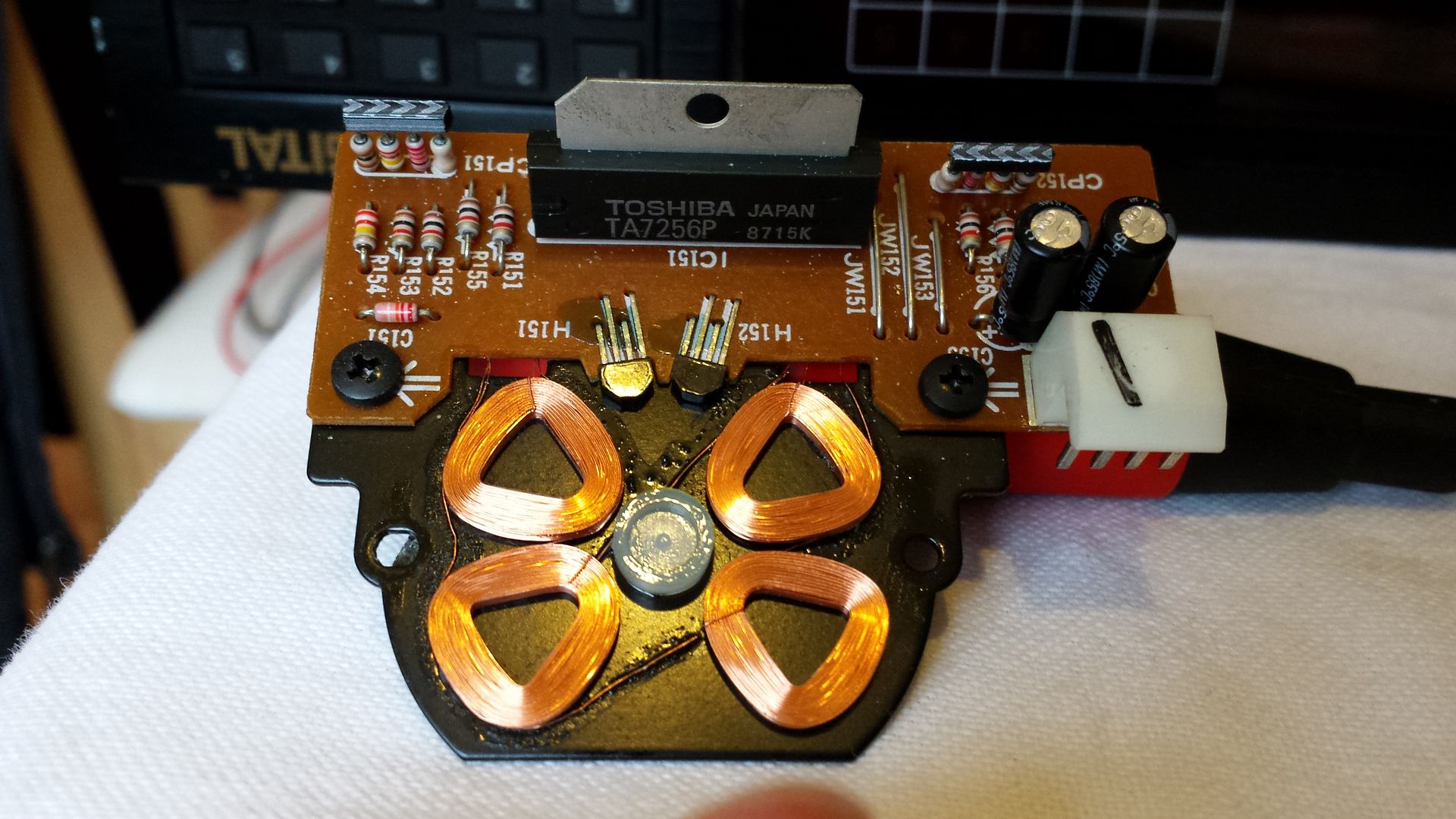

This player does indeed have a brushless motor. I started by removing the baseplate to see if there was a screw to adjust the spindle height. Unfortunately there wasn't, the bottom of the spindle rests in a nylon cup and apart from replacing the cup there is no way to accommodate for wear at this end.
I cleaned out the old lubricant with a Q-tip and gave it tiny blob of fresh synthetic grease.

Looking at the schematic can you advise me where to connect the probe so that I can have a go at setting the EF balance?
For EF balance you need to monitor the tracking error voltage (TE) which you can pick up on the 'top' of tracking gain preset. Turn the scope timebase to a slowish speed and then jump tracks, say track 1 to the end track and then back again. During the time the pickup is moving, the waveform should look symetrical above and below ground. Its an easy adjustment, if you misalign it each way as a test, then you know what to aim for.

Yes, RV102.
