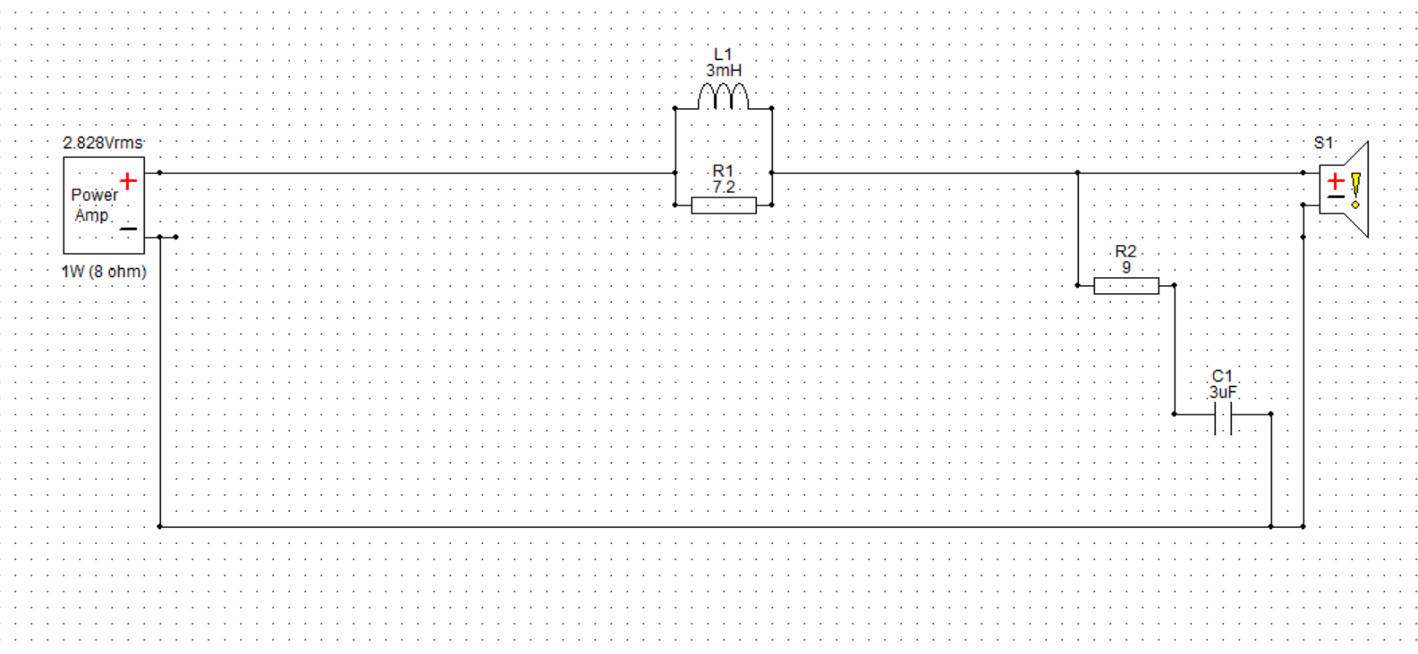

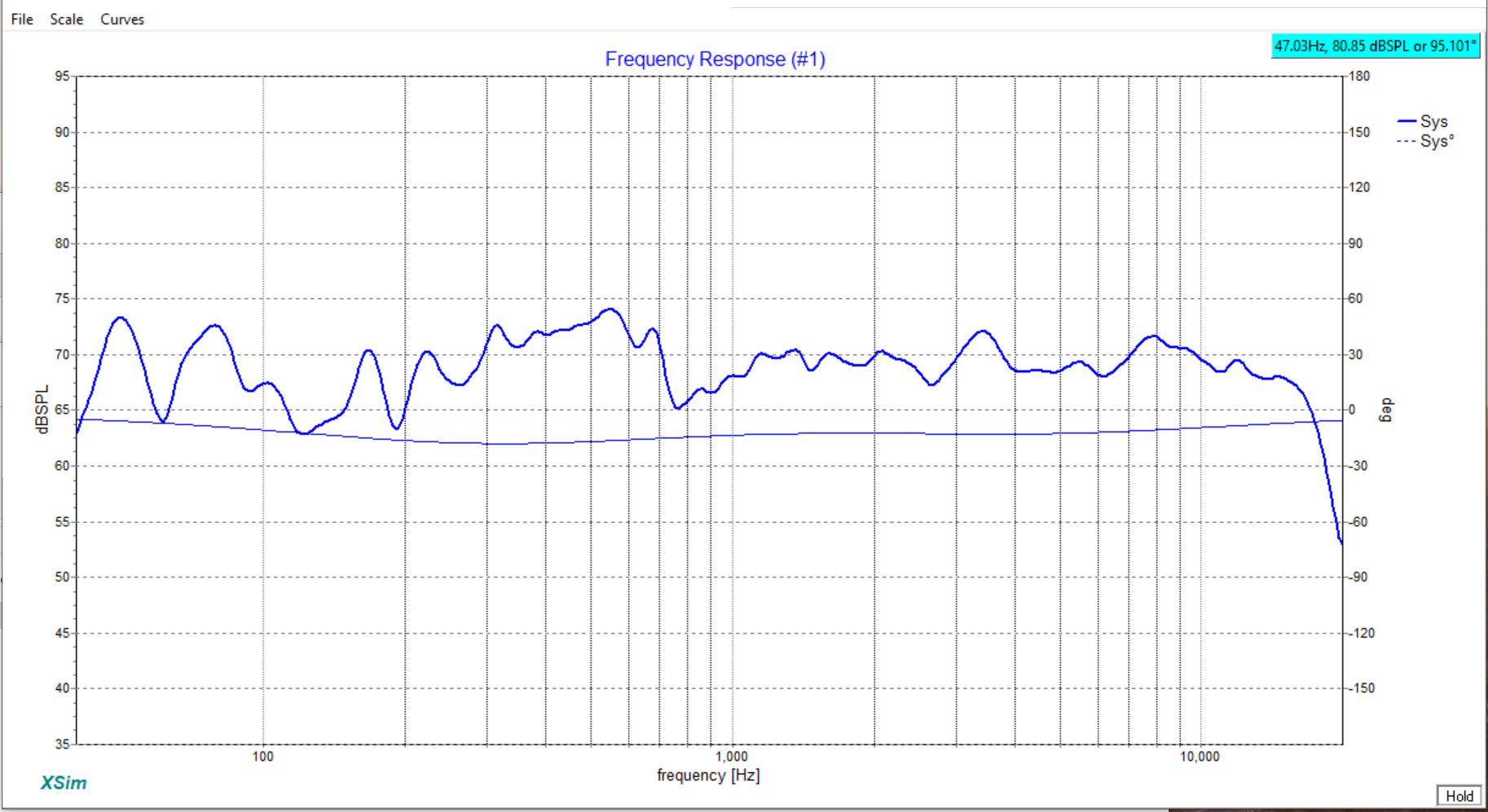

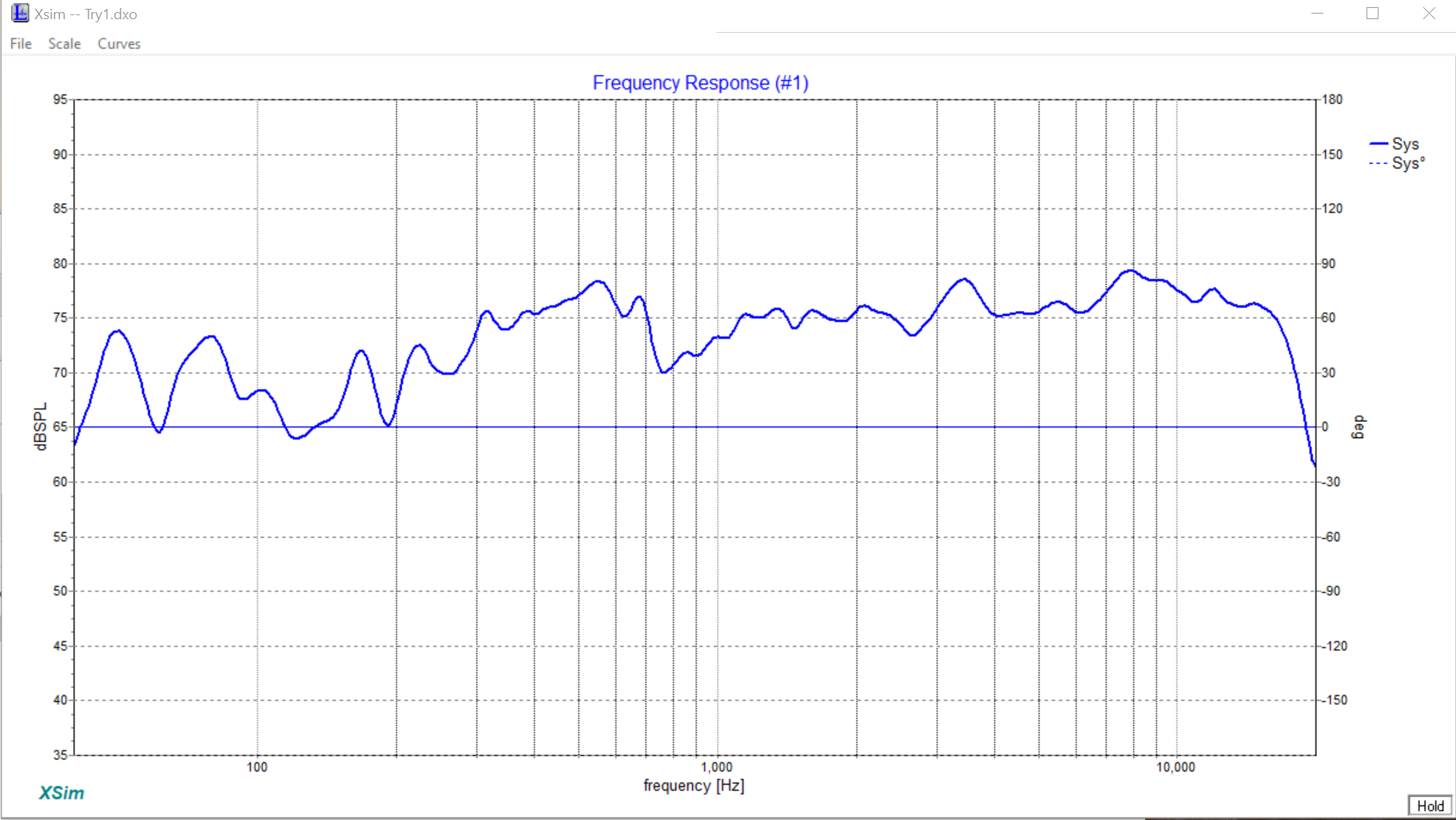

For your review......
I just traced my measurement using FPGraphTracer, then imported it into Xsim, then used the values from an online BSC calculator and here is the before and after.
It looks much flatter to me now. I messed around with the different values to see how it affected the outcome and it seemed like the calculator values work just fine.
I've also attached the XSim file.

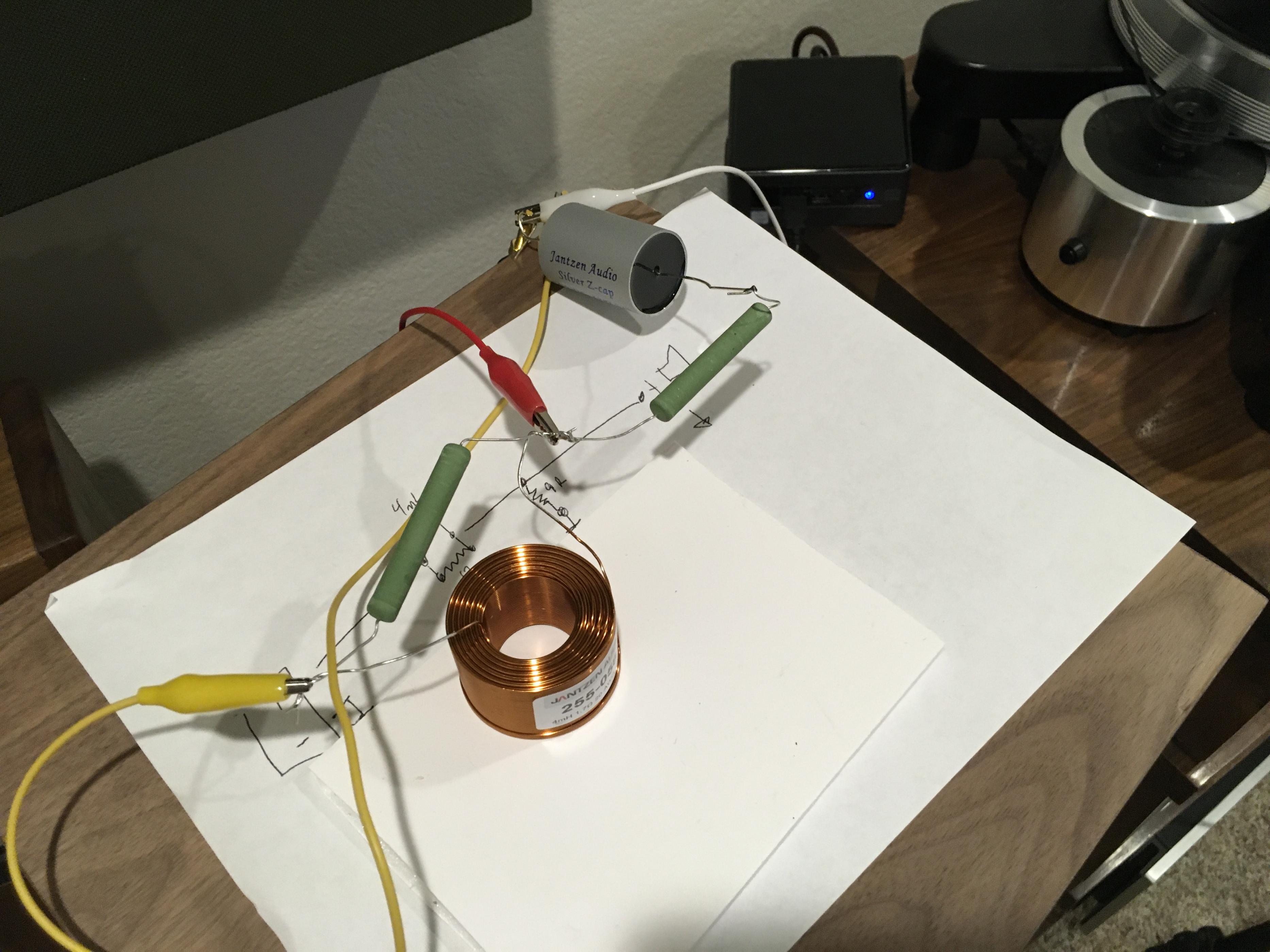

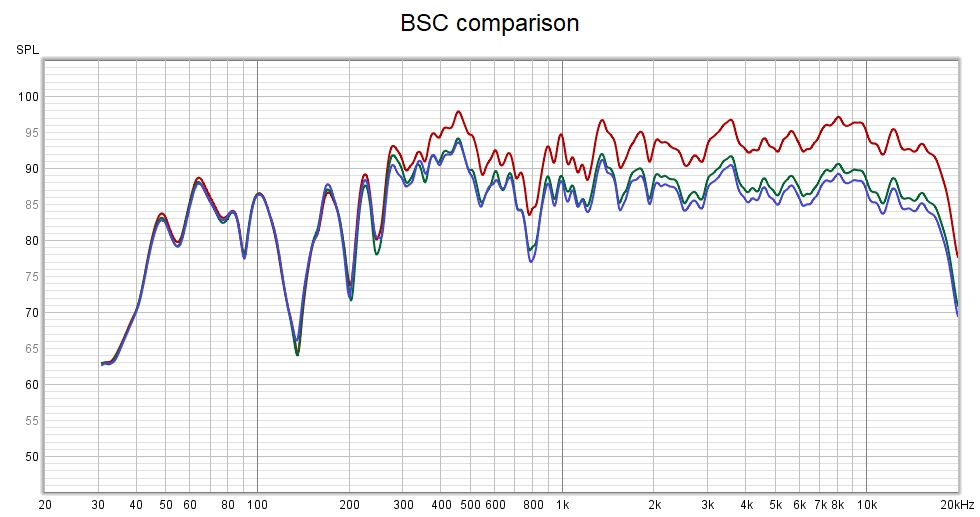

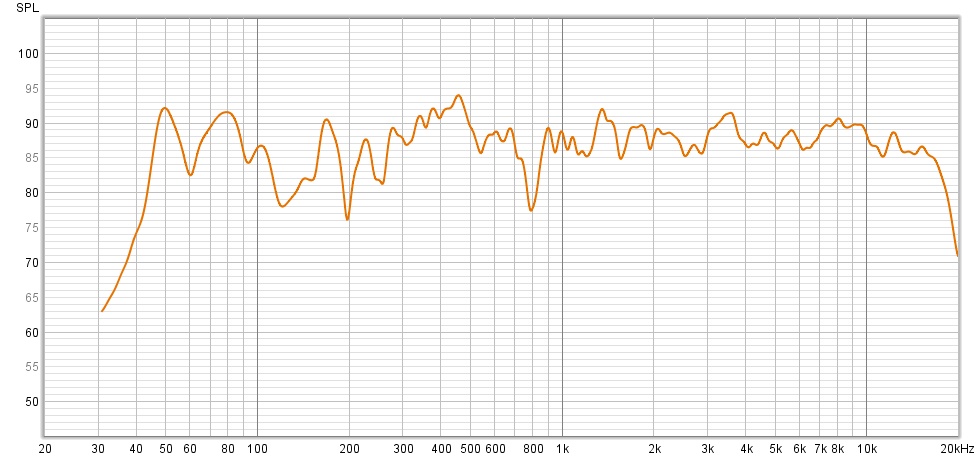

I got the parts and tested out a few different values for R in the BSC to see how much attenuation would come down.
The first image is a comparison showing single driver, measurements (in room) from 1m, top = no correction, middle using 7.5R and bottom using 10R.
In total it brings down the high end by just under 10 dB.
The second image is a 7.5R BSC and my sub turned on to fill in some low end.
So now I’ll be listening to the 7.5R for a while and see how it sounds.

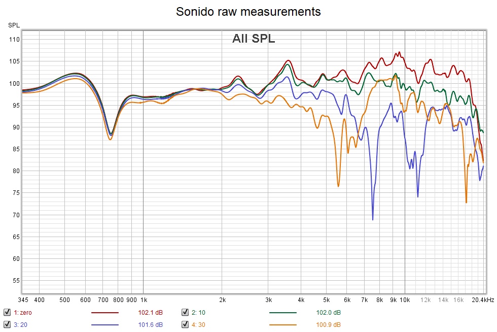

This last week I stumbled upon an article on how to use my mic and REW to obtain more accurate measurements. So I set up a measuring test in a large room, placed the speaker driver on a stand so it was 4 feet from the floor and ceiling, took a measurement then removed the room effects. I think the results were much more accurate, but only accurate above 350hz or so.
Here is a link in case any other noobs like me read this - Loudspeaker measurements
Here are the results at 0, 10, 20 and 30.
I also measured the before and after of my baffle step circuit and determined that when using proper SPL and impedance measurements that I didn’t have before, my circuit doesn’t work as intended. The circuit was modeled using in room measurements and without impedance.
So my question to all the more experienced builders: Should I redo the circuit based on these new measurements? The BSC I’m using measures well if I’m using “in-room measurements”. It also sounds great in the room.

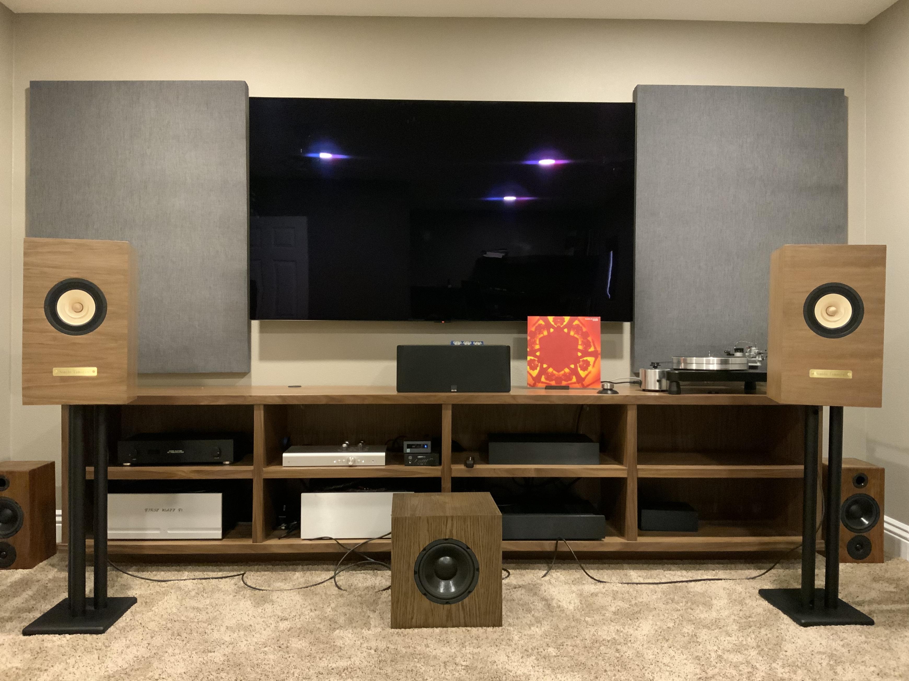

I thought I’d come back to this old thread now that I have been listening to these speakers for a good six months. One thing that has changed significantly is that moved, and in doing so, got me a much bigger dedicated music room.
I really, really enjoy these speakers, especially in my new room. After much testing I found the best place to put the speakers and to angle them slightly outside each ear so they are 15’ish degrees off axis. I did many other things to get my system working but the bottom line is this - the speakers sound fantastic. The speakers total disappear and the entire room fills with sound. I can listen for long periods of time without getting fatigued. An especially good combination of all my gear is listening to vinyl with my VPI -> pearl 2 phono-> Schiit Freya -> Aleph J.
What I don’t like? The optimal listen position is small but I think that’s just how larger full range speakers work.
Thanks Scott for the design and thanks to everyone else for tips. You can probably pick up that I learned a lot between my first post to my last post and I still don’t know half as much as most of you all.
