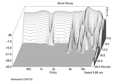

Dave,
Can you educate us (me) on how to read that Burst Decay graph and why are you showing the graph for the Markaudio CHR 120?
The Burst decay has periods as the time axis. If a driver was “perfect” the top line woud be fairly flat and the spacing of each curve is even. Further, any ringing shows the same shape for the same Q so the Q if the resonances can be compared.
The CHR-120 was just because it was readily availabke and clearly shows sme signifcant ringing at about 3.5, 5.5, 8KHz, the stuff higher up is not bad and the bit below 1Khz is the transition from pistonic to chaotic behaviour. The big ridges in the graph are where the chaos gets out of control.
The A10p deals with this by heavily damping the cone leading to the vintage, non0fatiguing top.
dave
dave

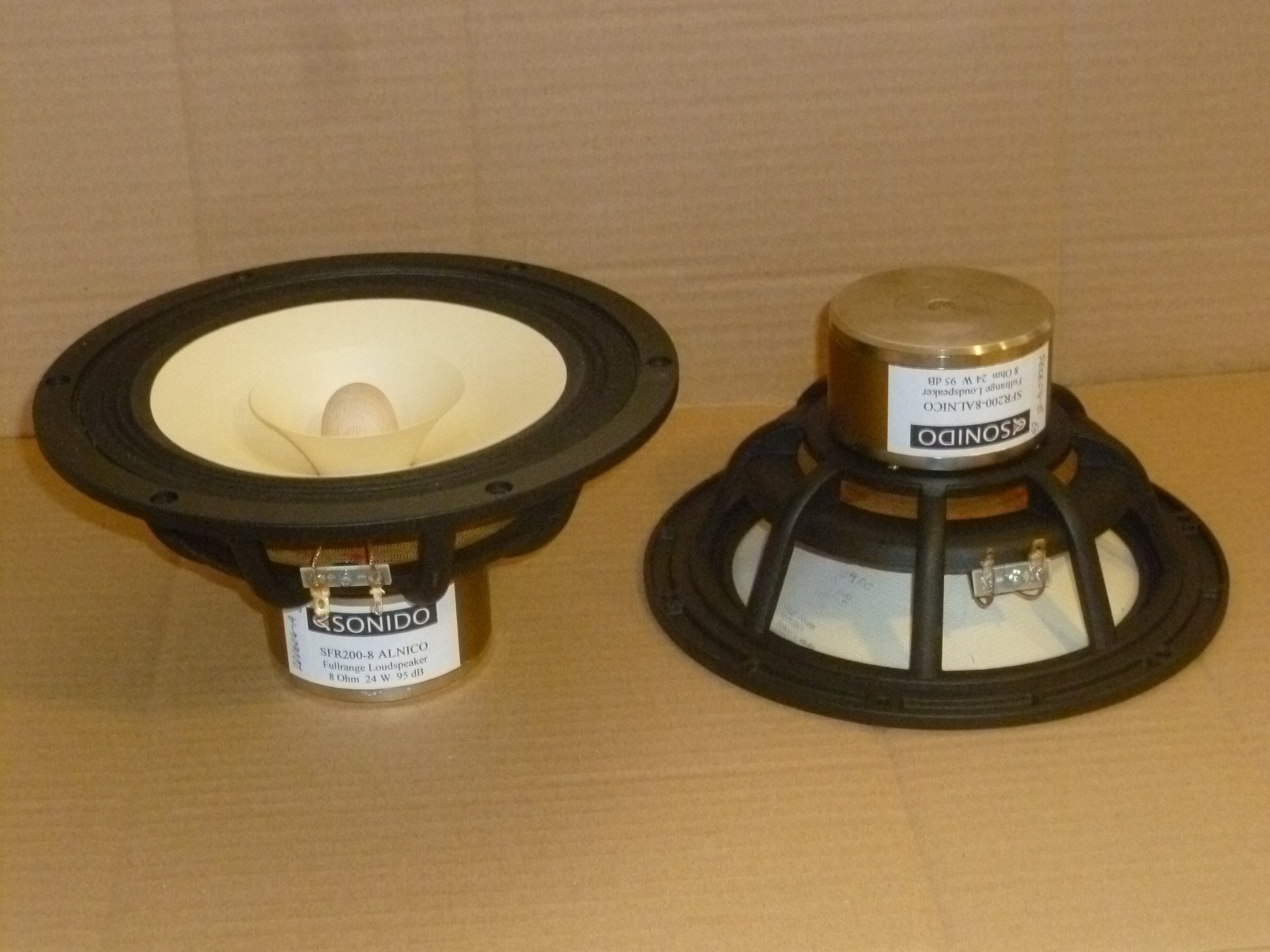

Hello Kevin,
Hope you are still enjoying those Sonido SFR 175A. I haven't decided which driver to go with for my end game bookshelf speaker but my research has brought me back to the Sonido's. I have a few questions for you:
1) Are the SFR 175A bright and fatiguing? I have sensitive ears and tinnitus but, I can listen to the Alair10p for a long time without fatiguing.
2) There are mixed comments on whizzer cones. What are your thoughts.
3) How is the soundstage and imaging?
BTW How do you access the free downloads on the Wodendesign site? I see many free plans floating around this site but haven't been able to see them on Woden's.

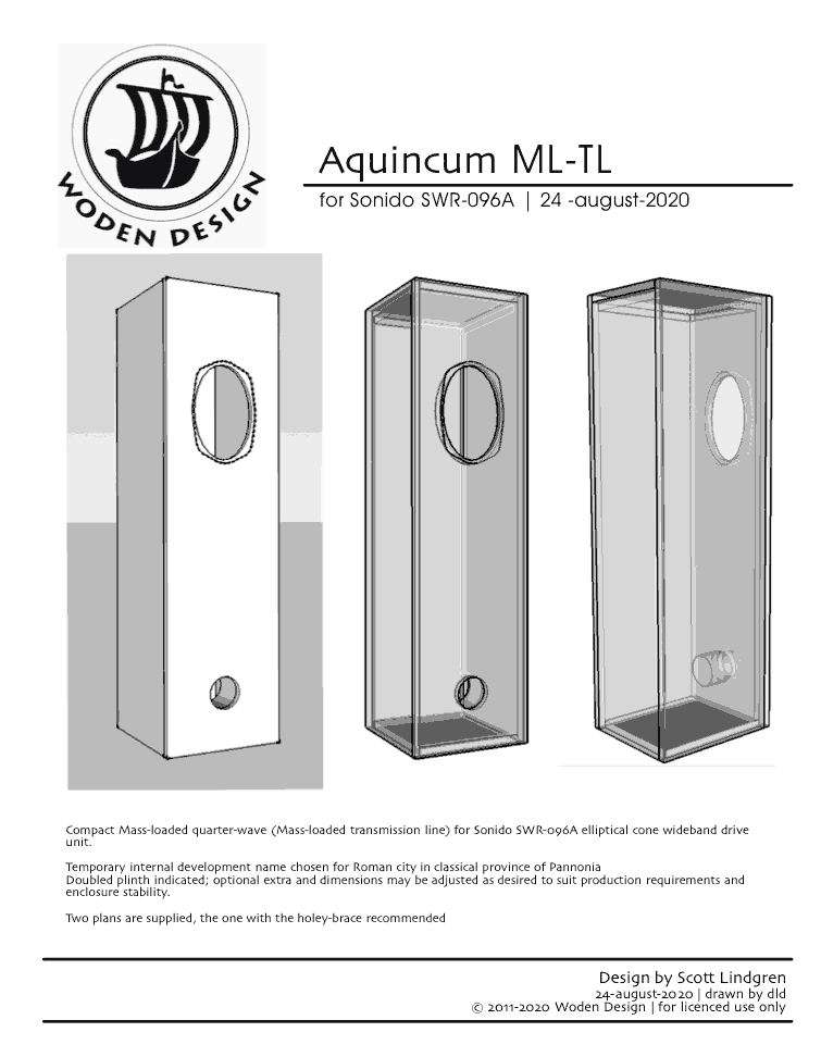

We have only done an ML-TL for the 6x9.
The wodendesign.com/downloads/ link only works if you have a specific plan URL.

Those are nice boxes, especially the standmount. Have you heard any Mark Audio speakers? If so,how would your drivers compare to the Mark Audio, ie Alpair12p?
bianchi, Yes, there are many other plans for the SONIDO SFR 175/A driver. Please write to me in personal email: info@sonido.hu , I give you all the plans and recommendations.
