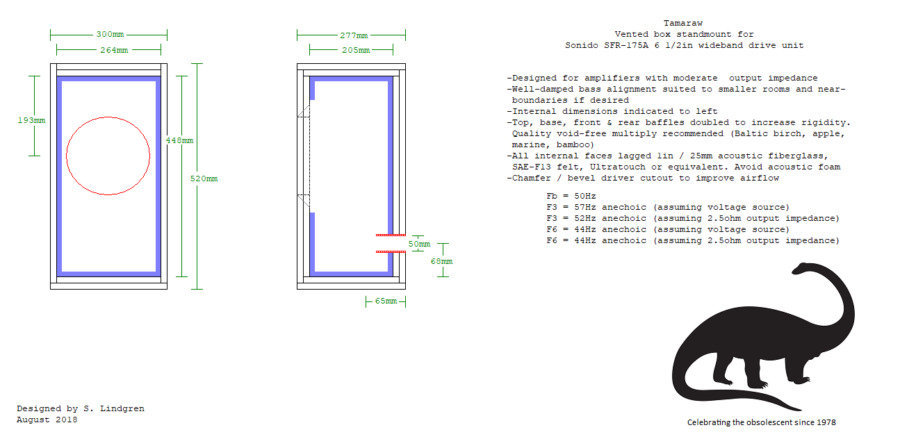

What boxes are your MA 10p in? How would you compare the Sonidos to the Markaudios since you've been listening to them for over a year?
I'm interested in the Sonidos and have the MA 10p in a 17 liter Bass Reflex box, so your input might convince me to get the Sonido's.
Using the picture in post#39, I estimated that your Sonido's are 6 feet apart. How far are you sitting from your speakers?
BTW are you still using the BSC on the Sonidos?

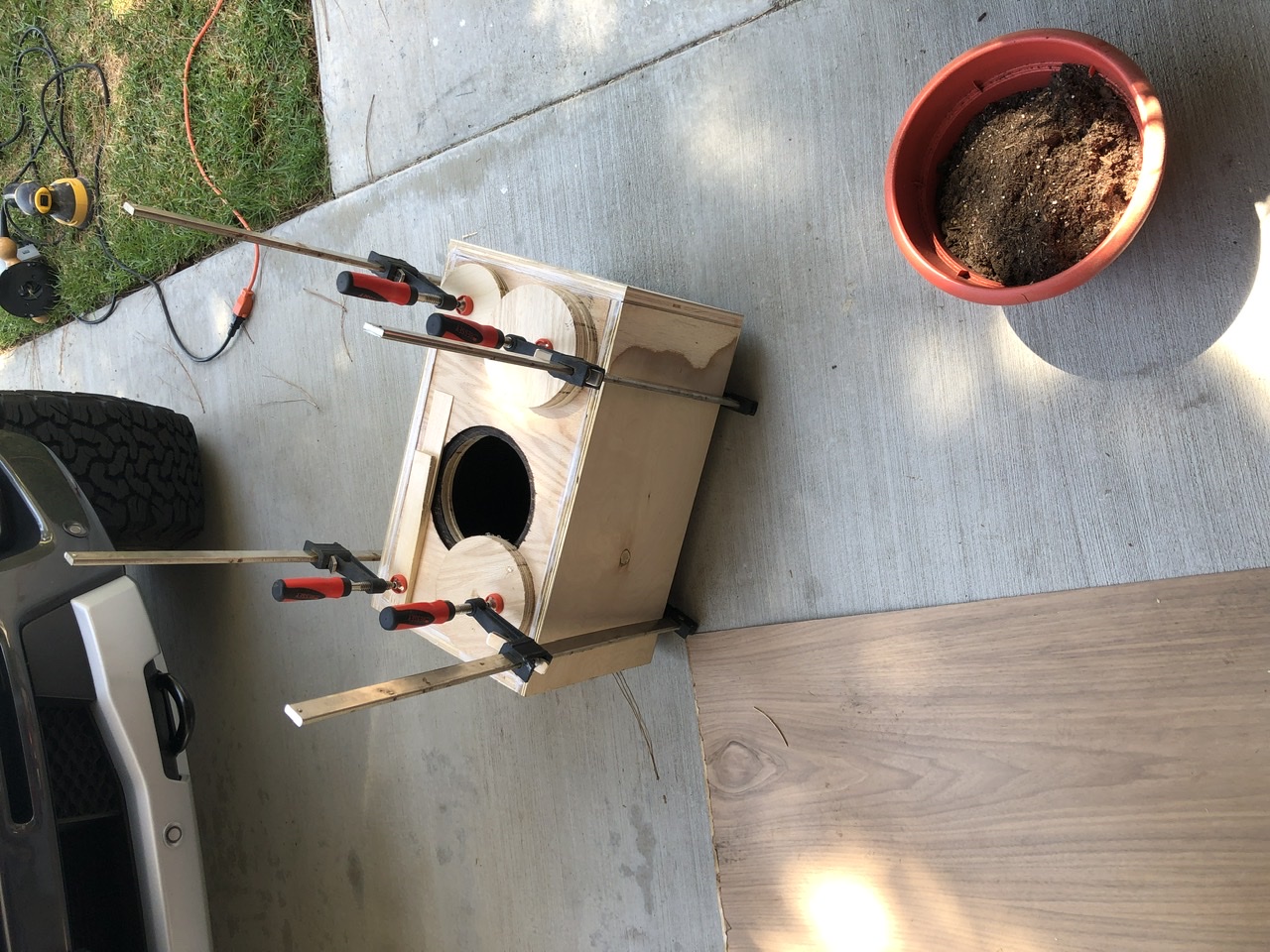

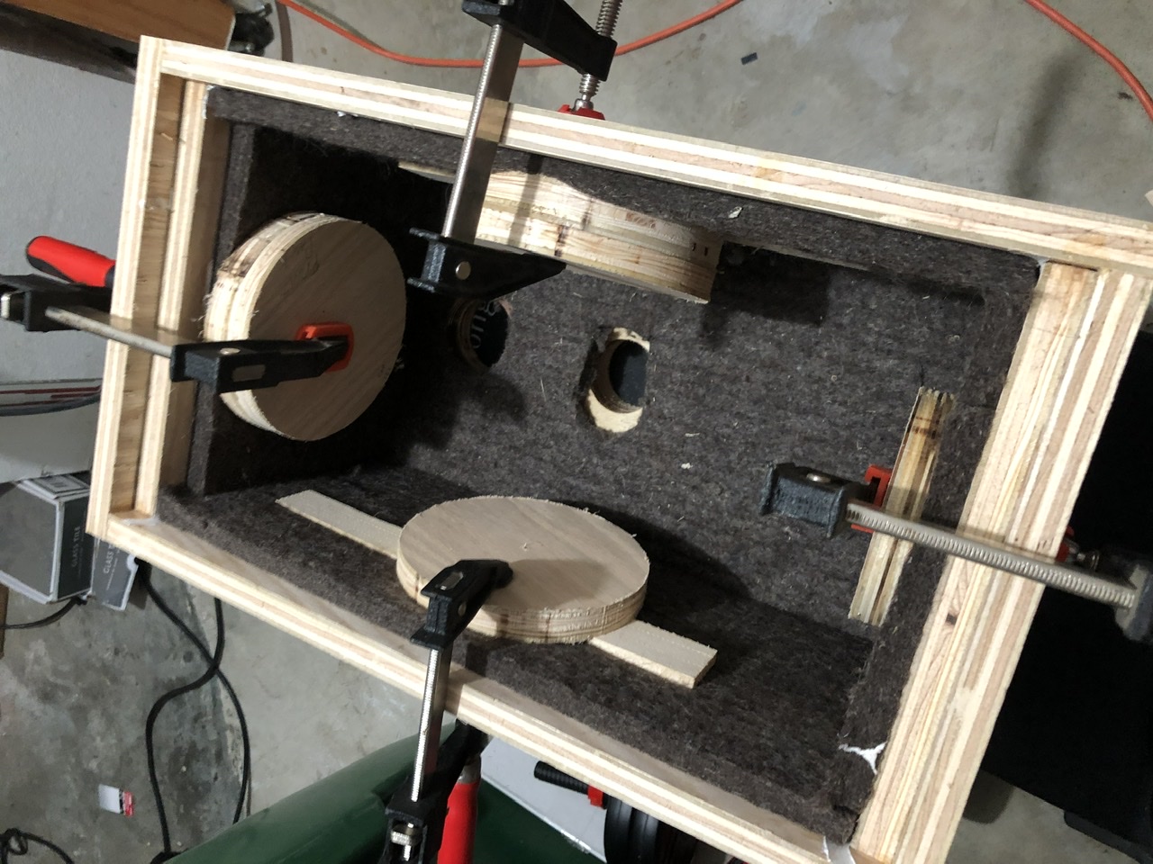

Bianchi,
The MA 10p drivers are in box designed by planet10. The 10ps sound awesome and the enclosure has really good low bass but I wanted a little more because I listen to electronic music sometimes and the bass gets a bit lower. I built a sub, but it was hard to integrate with the sub because of the 10ps already low bass. I also wanted a bit more sensitivity.
The Sonidos sound fantastic and I still listen to them 100% of the time. They don’t go as low, so it works better with my sub. The Sonido also is much more crisp and clear on the high end. My unprofessional description of how each sounds is that 10p is soft and sweet while Sonido is crisp and clear, perhaps because they are brighter. The listening window is wider with the 10p whereas the Sonidos have a small window to sit in order to get perfect imaging, but when you get it set up properly, boy those speakers completely disappear.
The speakers are about 6 feet apart and I sit about six feet away so almost an equilateral triangle. Here is a video that shows it a bit better.

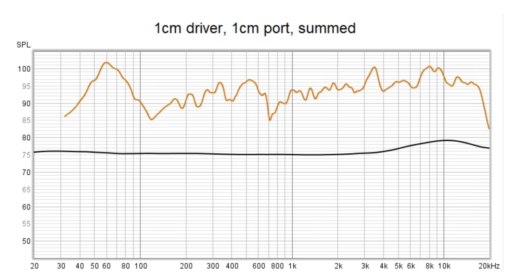

The Burst decay has periods as the time axis. If a driver was “perfect” the top line woud be fairly flat and the spacing of each curve is even. Further, any ringing shows the same shape for the same Q so the Q if the resonances can be compared.
The CHR-120 was just because it was readily availabke and clearly shows sme signifcant ringing at about 3.5, 5.5, 8KHz, the stuff higher up is not bad and the bit below 1Khz is the transition from pistonic to chaotic behaviour. The big ridges in the graph are where the chaos gets out of control.
The A10p deals with this by heavily damping the cone leading to the vintage, non0fatiguing top.

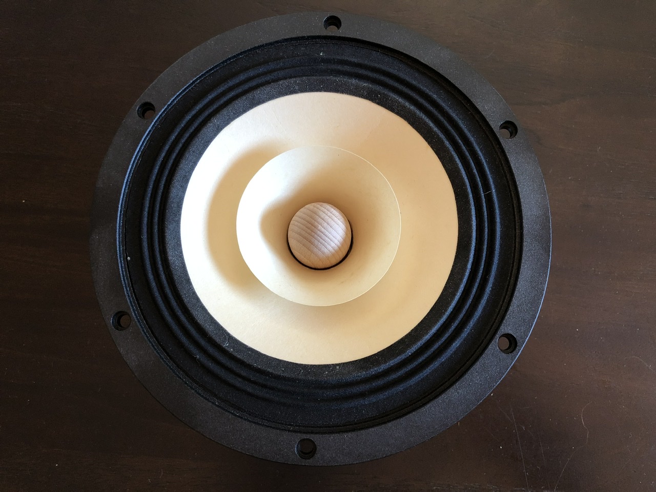

Hello Kevin,
Hope you are still enjoying those Sonido SFR 175A. I haven't decided which driver to go with for my end game bookshelf speaker but my research has brought me back to the Sonido's. I have a few questions for you:
1) Are the SFR 175A bright and fatiguing? I have sensitive ears and tinnitus but, I can listen to the Alair10p for a long time without fatiguing.
2) There are mixed comments on whizzer cones. What are your thoughts.
3) How is the soundstage and imaging?
BTW How do you access the free downloads on the Wodendesign site? I see many free plans floating around this site but haven't been able to see them on Woden's.
