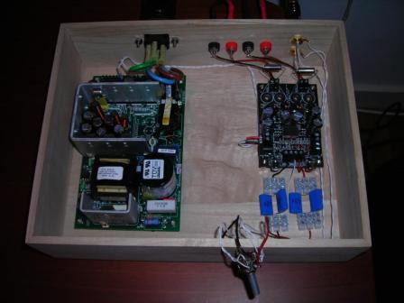

The price has gone up to $69.00. I have a slightly modded SI Gen 2 T-amp and I have been comparing them to dweekie's Sure Electronics TA2024 board:
http://www.diyaudio.com/forums/showthread.php?postid=1549065#post1549065
Frankly, dweekie's modded Sure Electronics board tramples the SI Gen 2 T-amp in terms of low and high frequency extension and definition. The midrange is smooth and liquid like a tube amp and the soundstage is more expansive. It just sounds more transparent and solid than the SI gen 2 T-amp.
Right now, I am using the Radio Shack 1.0uF (x 2) metal film caps for the input caps, but I will also try a pair of Black Gate N 4.7uF bypassed with 1.0uF, and a pair of Epcos MKV B25834 3.3uF film/oil bypassed with some Russian Teflon caps.
I would definitely recommend saving some money and trying the Sure Electronics board before buying an SI Gen 2 T-amp.
