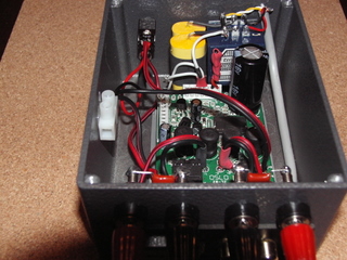

Paul,
I looked at the earphone jack wiring and this is what I figured out.
The ear phone when plugged in switches the speaker out off and routes the signal to the pcb somewhere. When the earphone is not pugged in the circuit makes a loop ... I can check continuity back to tha caps I assume these are the + signals for each channel. I made a diagram of which wires are which...
I guess if you wanted to remove the whole connector you could do so and then just jump the connections from 6 to 8 and 7 to 9. That would remove a lot of wiring from the signal path.
See attached picture
Eddie

erpii
Eddie, yes I looked at that circuit last nite & came up with the same answer as you. Accordingly I will shear off the ribbon @ the board & jumper pin's 6 & 8, 7 & 9, on the underneath of the board to keep it tidy.
You can still use your Led's as a source indicator for each input as you proposed, I would however sugest you run a seperate earth rail as distinct from using signal -.
If I had had more room I would have done the same with a rotary switch & the led's opposed by the degrees of rotation. No room in my $20 die cast case
Going to strip mine out tonite & hopefully get it off to the powder coater this week.
Trying to find a cutter I can sneak in to cut / crush R3, R02 is not so bad to get at. I will "blob" the 2 cap's.
With the 2 new Caps wired into the input, the circuit will then be identical to the Tripath evaluation board.
Hopefully I will have the case back & it up & running again in a couple of weeks.

Hi Paul...
So you will be soldering the input caps right at the junction of R3 R02?
Are you going to change any of the other caps?
About the leds... the way I see the circuit for the indicator led is that it is switched through the - signal. How would running another - line from, lets say, the input DC jack, be switched? Unless I had another pole on my switch, I don't see how it could be accomplished. How can I isolate it from the signal - and also switch it, without having another switch or pole on the switch I have? I guess I could put in a dedicated on/off switch and that would leave room on the source selector for the - led switching. If this can be accomplished lemme know. I don't know much about circuitry so I'm not doubting your proposal!

erpiii
Eddie,
Re cap's, no my cap's are rather large being pp's. I will go into J2 from the Vol Pot sweeper after shielding the cap leads.
I will make up a "dummy" loom on an old Cap as the braid/heatshrink may make the wiring a bit stiff. I made a loom last nite for RCA's to Vol pot & it's OK because it's a lot longer & does not require acute bends.
The main board will be "floating" & only shielding connected to the die cast case. This worked well with my other T-Amps ( Sure & Charlize ) which are totally quiet.
Your Switch.
Had to go back to your drawing you put up a few post back. I assume you are going to use it as a power amp & bypass the Vol control. ?? as you have wired the RCA's directly to the amp input. Yes I should have looked closer at your drawing & looked at the Pot board also as the + & - pad's on the board are common for both Led's.
As you say you haven't enough poles & would need a seperate power switch & need to cut a trace on the board between the led's to do what I proposed.
Give it a go utilising a common -, after all Sonic do it that way & mine at least was very quiet, not totally but I think what noise I had was from my computer.
Are you re-casing it ??

erpii
Eddie,
Where there''s a will there's a way.
Cuticle cutters can just get in to crush the resistors R02 & R3. Job done & circuit still intact less those beasties to earth.

Will try & attach some photos of finished amps. you can get Sure board photo's & Manual off their Ebay store. I can recomend them & they are good to deal with.

[I would like to remove the blue light(s) from the original pot and mount it on my new case but not sure where to tap the wires to on the Gen2 board. Would you give me some instruction, please!
If you are using the original Pot/switch Board, you can simply remove the existing led's & replace 1 with a +/- lead to the new Led position. Remember the polarity, they wont work reverse polarity.
If using a new on/off switch, Pot etc best option is to use a 12 volt Bezel/Led combination, with built in dropping resistor & switch it from the new on off switch. I had a 1.7 volt led on my board & 2.4 volts on the rail accordingly the led lasted 30 minutes only. So with my exeperience, & I know of other blown led 's on Gen 2's, I would advise that route. Alternatively you can use the existing led & resistor off the pot board board wired back to the switch.
I will try & attach a photo so you can see what I did.
I powered mine off the B+/B- position & switched this line with the led connecteD to the switch. The "chocolate block" terminates all the - connections.
The Red/Black wires on J2 are simply jumpered.
